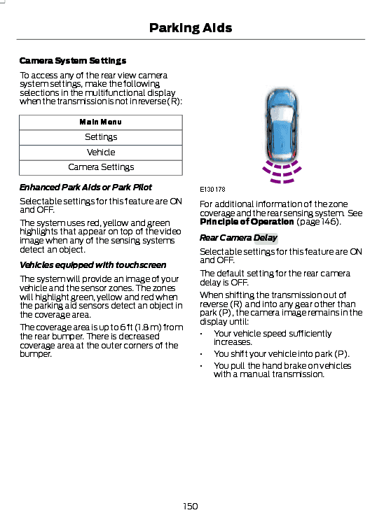

There's a setting for that in the menus. Both in the dash (multifunctional display) and on the 8" screen:
If that doesn't work, try the thread link below. Someone else had the backup system and the previous owner installed the 8" screen. He couldn't get the graphics working. I dug up a bunch of Forscan codes for him and he was able to get it working with Forscan. Have you changed anything in Forscan or upgraded any related modules? If not then this may not be of much use.
See here: https://www.mustang6g.com/forums/th...n-sync-3-2018-gt-base-pp1.143991/post-2948293
What you are talking about or referencing in the manual highlighted, the camera delay - I'm pretty sure this is if the backup cam stays on your infotainment after you drive forward. Say you put it in reverse on manual, backup cam comes on, you put it in 1 and start driving forward. If delay is on, the camera view stays for few seconds. If is is off, as soon as you shift out of R it's gone.
So the little car with the sensor lines at the back (no front sensors) should appear next to the rear-view camera? Now that you guys mentioned it, I think my car only shows the rear-view camera, but need to check next time I use it. I know the sensors beep, but not sure if there's a picture showing that. I typically back up the old-fashioned way, which means looking thru the rear window :).
Yes, there is/was (I can't remember on mine now) picture of the car, when you got closer to something on the right, you'd see red bars on the right side of that little car graphic.

Used my car today, and yes, a little picture of the car on the top right hand corner is there... BUT WITHIN the rearview camera screen. That's why I didn't notice it. Ha ha. It's pretty subtle, but it's there, whether the sensors are beeping or not. When they beep, the aforementioned lines appear, so it's working perfectly on my car :).
