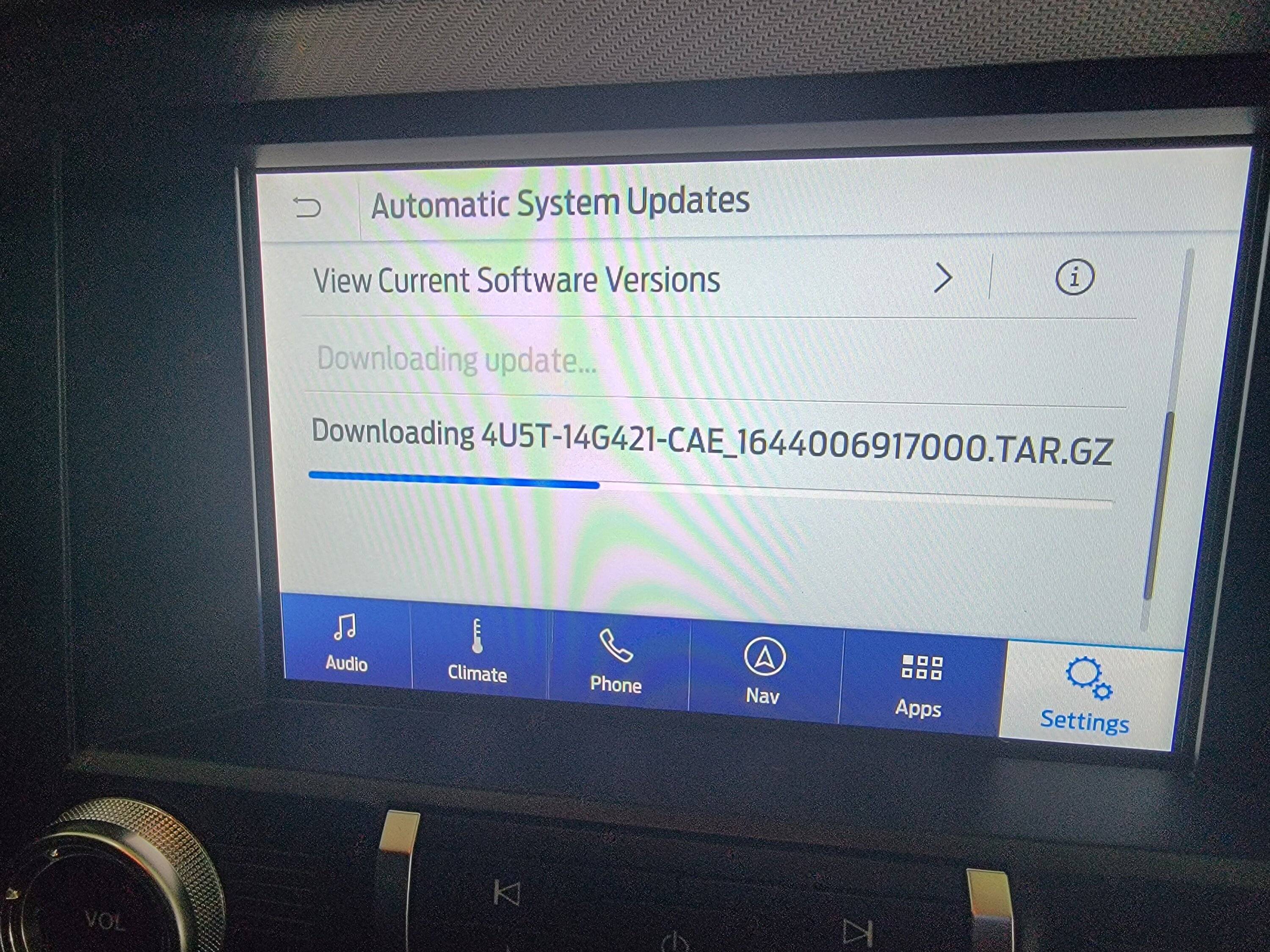

The crazy thing is the last two sync updates happened automatically and this, I had to force. I started last night and went to bed after turning the accessory off and disconnecting from the charger, I guess I can walk out and check if it is finished.

Ok, I just went to the garage to check and after turning on power, this is what I see.... So no it didn't complete the upgrade on it's own via WiFi. This is interesting since the last two sync updates happened automatically over WiFi.
