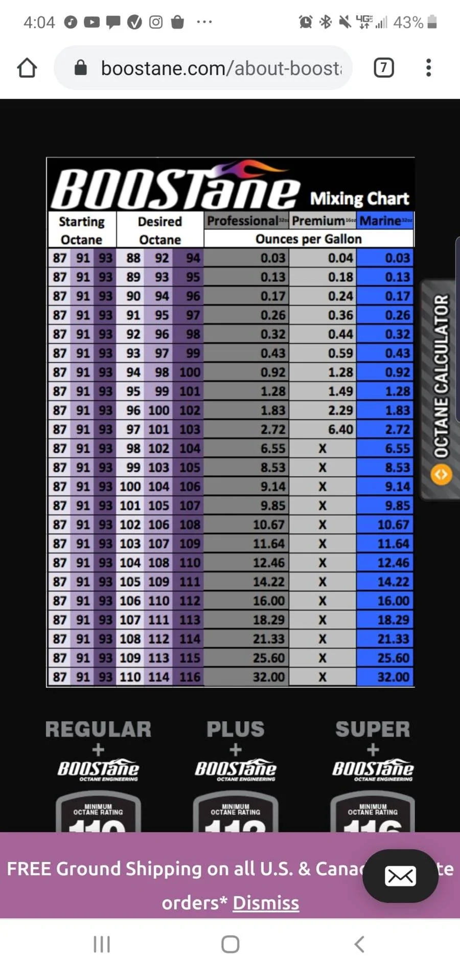

Soooo i just want to make sure I get this stright, and don't put to much or not enough Boostane in my car. If I'm reading this boostane chart correctly on there website. If I have 10 gallons of 93 in my tank and I want to run 101 octane I need to run 1.28 oz of Boostane per gallon. So 10 gallons of 93 × 1.28oz of Boostane will give me 12.8 oz of boostane I need mix with 93. Is that correct?

Yup you got that right. Also if you follow the chart boostane gives it's biggest affects up to 100 octane. with 93 and just under an ounce per gallon you get increase of 7 point, but iff you want another 7 point increase it takes more than 10 times more boostane to get there. I run 1 once per gallon and it makes the best bang for the buck.
