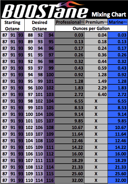

I tried your method utilizing the Boostane mixing chart for their Premium product, it didn't work.
Example with 91 octane fuel to get 92, just add .04oz per gallon. To get 93 using your method, you'd have to add .08 oz per gallon, mixing chart says .18 oz per gallon. It's not a straight forward ratio.
If Boostane really works as advertised, to get 8 octane points using their premium, the ratio is 1.49 oz : gallon

Boostane is probably the most effective "booster" that being said, I wouldn't go exactly by their chart. I would go higher on the ratios. Closer to 2oz per gallon for 100 octane.
