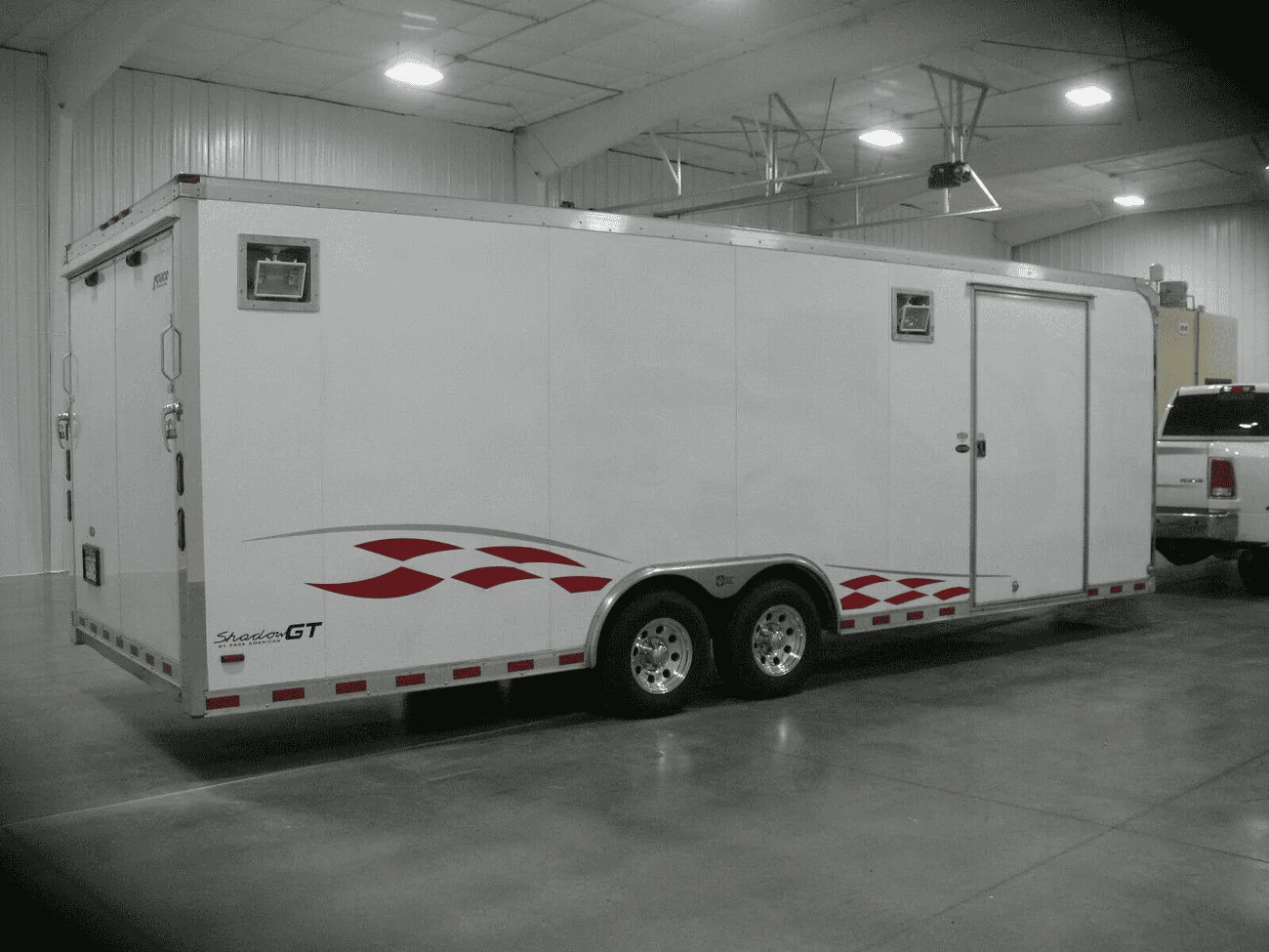

We have a 2006 Pace Shadow GT Daytona. We bought it in 2019 which is when things sold for what they were really worth.
When we were shopping we had several must haves
  • 5200 Axles
  • 24ft
  • Brakes on both axles
  • Electric tongue jack
  • 7ft Ceilings
  • 110v Hookup and internal wiring
  • Tie downs that are attached to the frame of the trailer
  • Cabinetry
Things that came with the trailer that we didn't know we needed:
  • Torsion suspension. Yep they ride better
  • Aluminum wheels - they look better
  • 8ft Ceilings. I think it makes the trailer cooler inside because the roof is farther from our heads. Also my driver's suit doesn't drag the ground when I hang it up. Yes it is taller and probably takes more fuel to pull but it is worth in when you are spending 8-12hrs in and around the trailer during a race day.
  • A Generator Bay. I haven't put my generator on a slide in there yet but it is a really handy place to put stuff. Like a pancake compressor, air hoses and the equalizer bars when we are parked
  • Electric tongue jack relocated further back on the tongue. It allows us to lower our trucks tail gate while hitched up
Things we got that are not really worth it
  • Carpeted walls. Our trailer's walls are carpeted half way up. Makes it really hard to screw stuff to the lower parts of the wall
  • External Halogen lamps. We have used them once and only after installing LED bulbs. They look cool, but I would not pay extra for them

Now all you need to add is a set full size mustang outline graphics to show them what's inside .

I think the real answer is some sort of Septic Pumping Service graphics and or maybe some Bio-Hazard placards.
