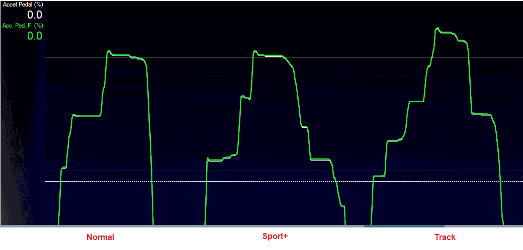

Speaking of the difference in the throttle sensitivity between the various modes, I ran some tests, and here are the results.
First, let's see the stock calibration again:
In Normal mode the relationship is perfectly linear. That is, the pedal output is equal to the actual pedal position.
In Sport+ and Track there's a linear relationship up to 20%, after which the pedal output increases faster than the actual pedal position.
Now, let's see how a live scan of these parameters looks.
In the graphs shown below the white line is the actual pedal position, and the green line the "commanded" pedal position (i.e. what the PCM actually takes into account when calculating how wide to open the throttle). The horizontal reference line represents 20%.
So, we notice the behaviour described in the configuration tables. In Normal mode the commanded position mirrors the actual position exactly, while in Sport+ it's a perfect match up to 20%, after which the commanded rises faster than the actual.
Track mode is identical to Sport+, which stands to reason since it uses the same configuration table.

I believe this strategy only applies to the regular Mustang, not to its sportier brethren. First, because I watched an interview of Jay Leno with Dave Pericak about the current generation GT500, in which he says that the Track mode was specifically programmed to give a linear throttle response, which is considered a good thing on a race track. And second, because some people mention in the GT350 forum that the throttle feels a bit lethargic in Track as opposed to Sport.
If that's the case, then I find it a bit odd that Ford gave the GT the same enhanced throttle response in Track as in Sport+, even though they knew that a linear response would be preferrable on the track.
Personally, I prefer a linear response all the time. So, I've changed my Sport/Track table to the same model as the Normal one. And here's the result:
