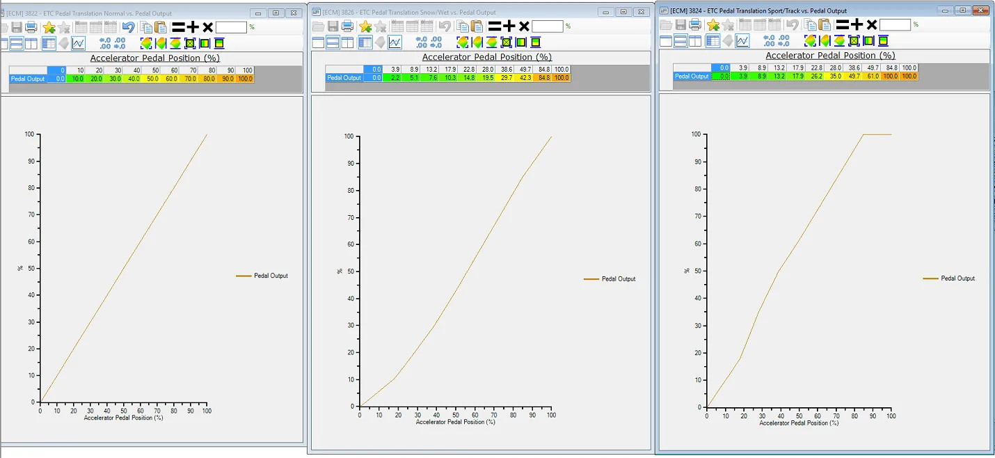

To me sport mode has more grunt (throttle input) down low, whereas the track mode is more linear (almost more linear than stock).
[MENTION=16352]markmurfie[/MENTION]
Mark, since I no longer have HPTuners and can't check myself. Could you please share with us the stock throttle tables for each mode?

This?

^^Great info, thank you!
Tacostrk
Jul 31, 2017
50
WV
17 Roushcharged gt premium PP
Thanks [MENTION=16352]markmurfie[/MENTION]. Interesting to see the Sport and Track share the same table.
And not linear at all. Can this be adjusted by Lund,PBD,Rob Shoemaker etc? I’d like the throttle to stay the same as in normal mode but with the reduced traction control and advance trak in sport+ and track mode.
Livernois V11 tune is already like that. Very linear.
Mar 24, 2016
1,078
395
GA
2016 Mustang GT
Yes. It's a literal copy/paste of the Normal mode to the other tables.
