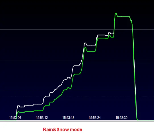

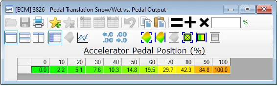

Rain & snow mode works in the opposite way.
The commanded position is always much lower than the actual position, except at (or close to) WOT.
And here's a scan to prove it:

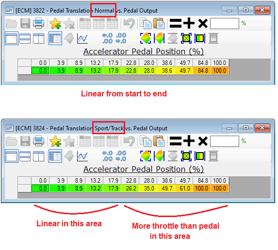

Speaking of the difference in the throttle sensitivity between the various modes, I ran some tests, and here are the results.
First, let's see the stock calibration again:
In Normal mode the relationship is perfectly linear. That is, the pedal output is equal to the actual pedal position.
In Sport+ and Track there's a linear relationship up to 20%, after which the pedal output increases faster than the actual pedal position.

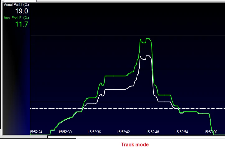

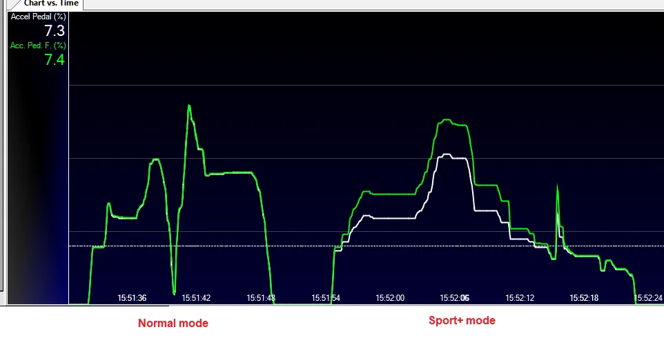

Now, let's see how a live scan of these parameters looks.
In the graphs shown below the white line is the actual pedal position, and the green line the "commanded" pedal position (i.e. what the PCM actually takes into account when calculating how wide to open the throttle). The horizontal reference line represents 20%.
So, we notice the behaviour described in the configuration tables. In Normal mode the commanded position mirrors the actual position exactly, while in Sport+ it's a perfect match up to 20%, after which the commanded rises faster than the actual.
Track mode is identical to Sport+, which stands to reason since it uses the same configuration table.
Interesting that sport+ and track are supposedly identical. Does sport+ have different shift points than track? (Part throttle upshifts at higher RPM?) It feels more aggressive to me.

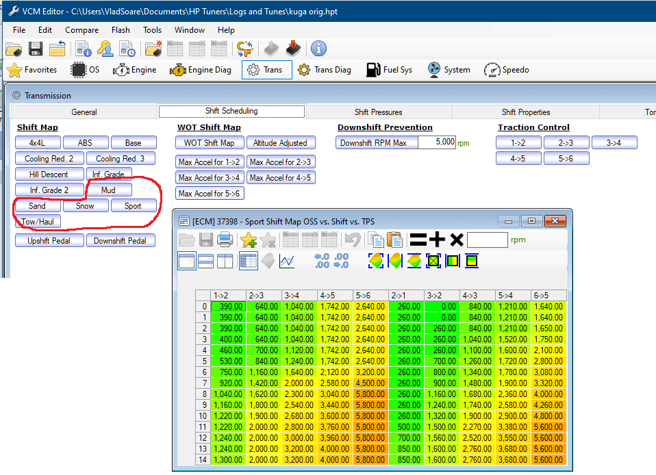

Yes, I find that interesting too. One would think that on a race track you want as fine a throttle control as you can get. And apparently Ford think the same, seeing that they gave the GT350 and GT500 a linear throttle response in Track.
Sadly, since my car is a manual, I can't see the shift schedule tables in the editor. If I look at my wife's Kuga, which has a six-speed automatic transmission, here's what I see:
I guess you'd see something similar for an automatic Mustang. If there's a separate table for Track, then it shifts differently. If it's the same table as for Sport, then it doesn't. But I can't see it, as the editor won't show me things that don't apply to my car.

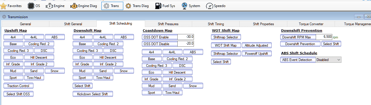

Anyway, I've found a file from a 2019 A10 Mustang on the HPtuners forum. Here's how the shift scheduling page looks:
I see nothing about Track anywhere. So, I think it's most likely that Track shares its shift schedule with another mode - the only possible candidate for this being Sport.
Caveat: what's called Sport here may not necessarily refer to the Sport+ drive mode, but it could mean the S position of the shift lever. My wife's car doesn't have drive modes, and yet it has a Sport table and shifts differently in S.

Hmm 4x4 and 4x4 low implies a truck rather than a Mustang.

Many vehicles share the same PCM, or variations of it. My wife's car has no Sand or Mud modes, nor a low gear range, and yet the respective shift schedule tables are present in her configuration.
Here are, for instance, the pedal characteristics available for my Mustang:
Obviously, we don't have all these modes, but the Normal, Sport/Track and Snow/Wet tables do work as expected, as I've shown earlier. The others... probably would have no effect whatsoever if I changed them.
