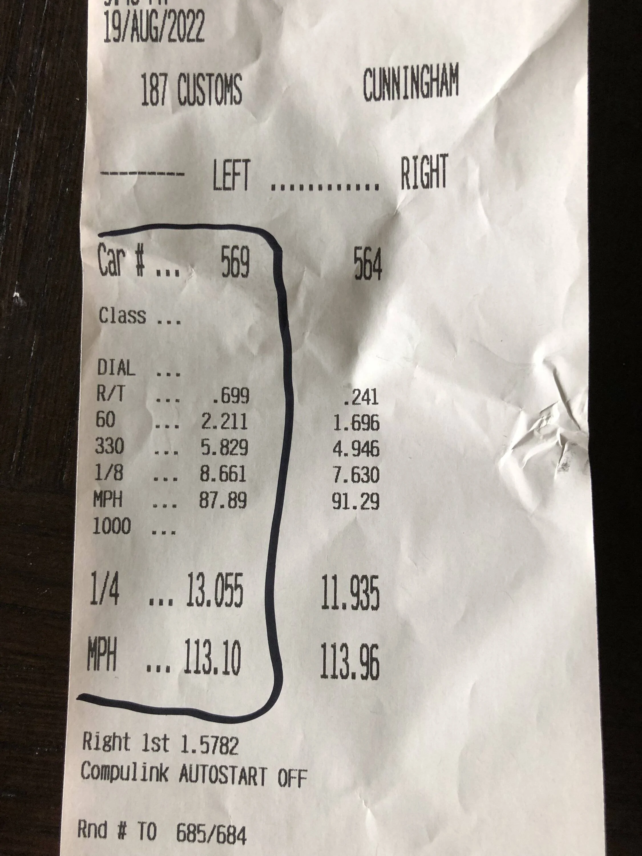

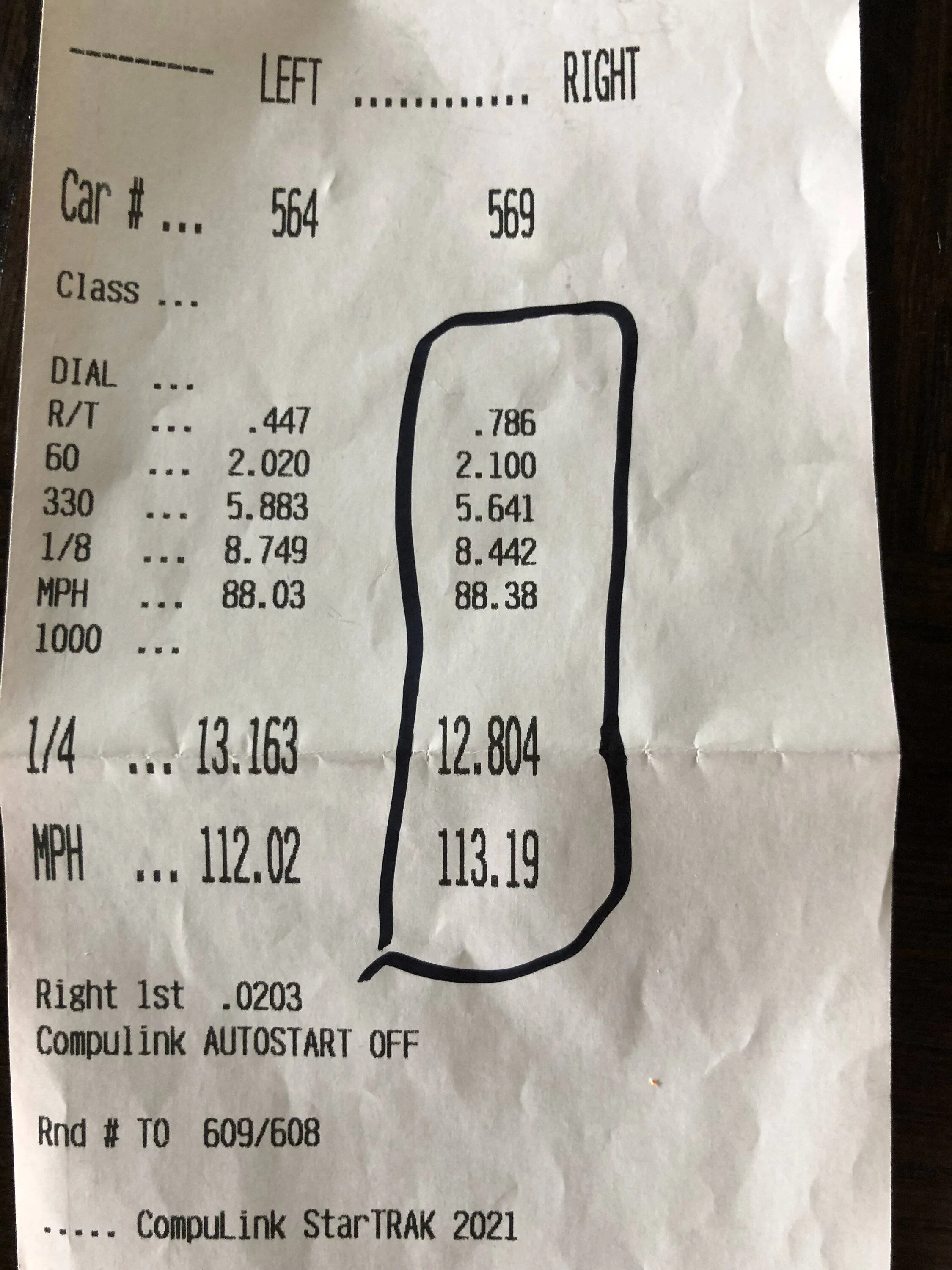

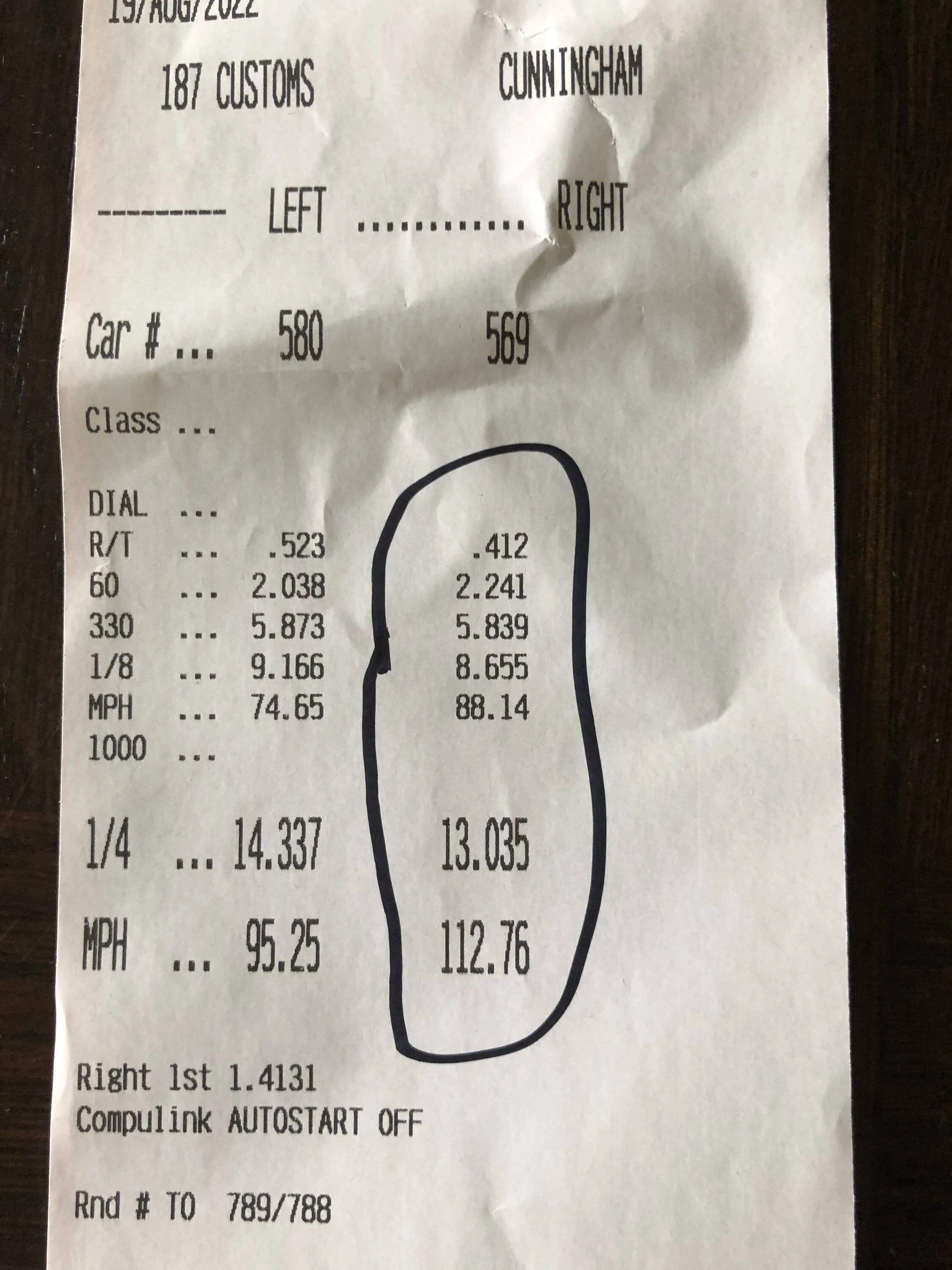

2020 GT pp1 premium A10 bone stock. 275 PS4s on the back with lots of tread Been to the track twice in the last 2 weeks. I consistently get a 13-13.2. 60 foot times usually 2.2-2.3. I’ve tried sport, track, and drag with a combination of taking off at idle or keeping it revved to roughly 1500rpm. Also I’ve tried with and without burnout. I did manage to sneak in a 12.8 in sport with traction control on and no burnout but could not replicate it. I’ve seen people on here talk about stock cars doing low to mid 12s. Any advice to improve 60’ and ET is greatly appreciated. Here’s my 3 fastest times last night

DA was 3550. Another GT base stock was running 12.7
