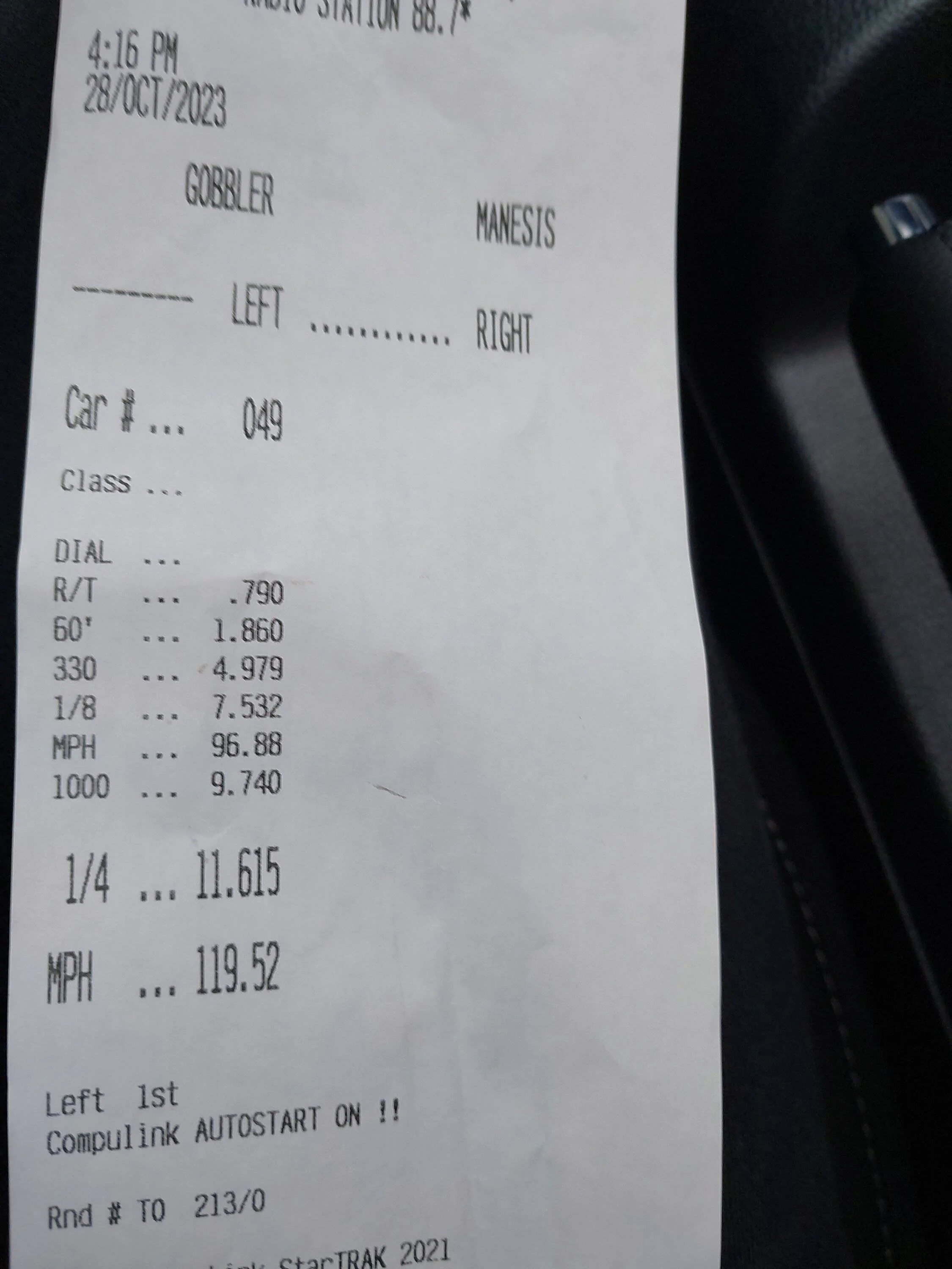

My slowest run was straight off highway.

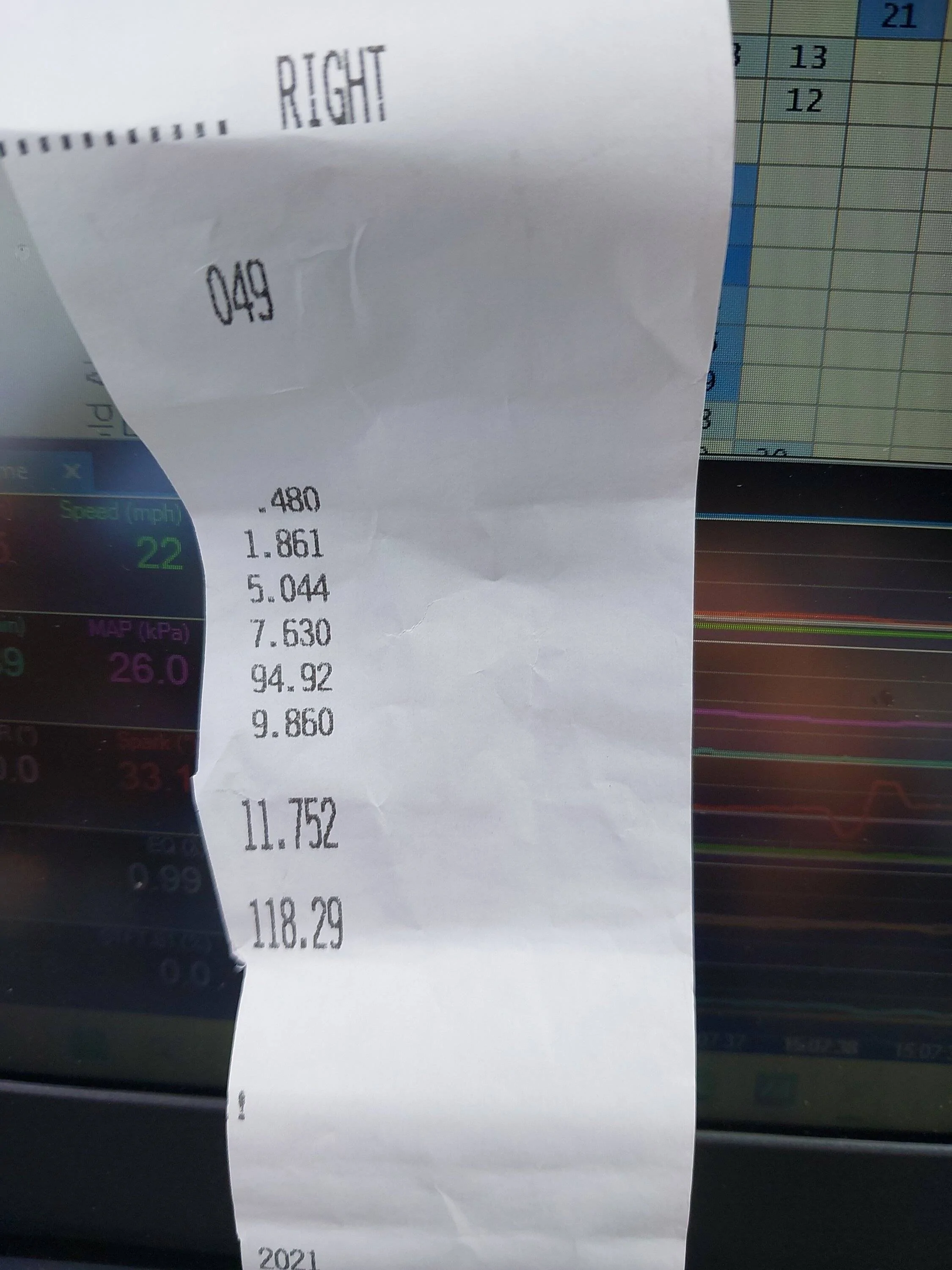

Juggernaut

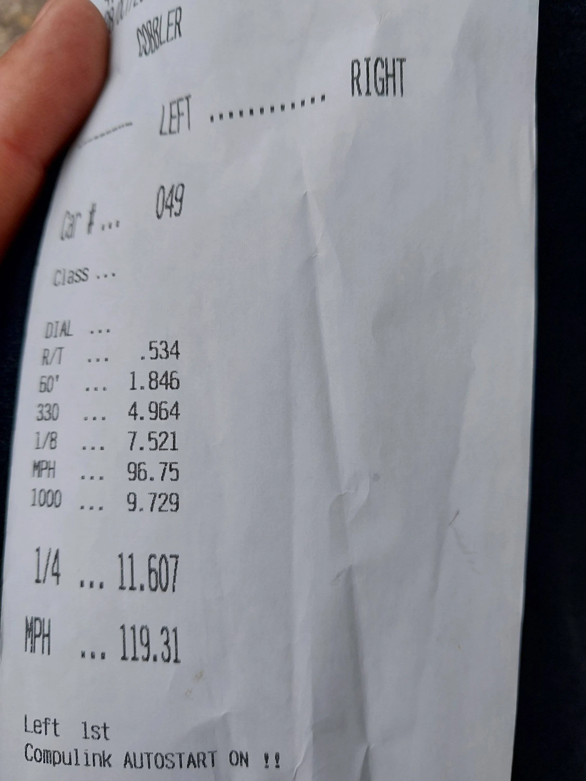

Mach 1, Expedition platty max, TBSS, Silvy, Camaro
My fastest out of 3 passes

Completely stock except wheels and tires. It's a Mach 1 so it has a lil more aggressive tune from factory but nothing crazy.
