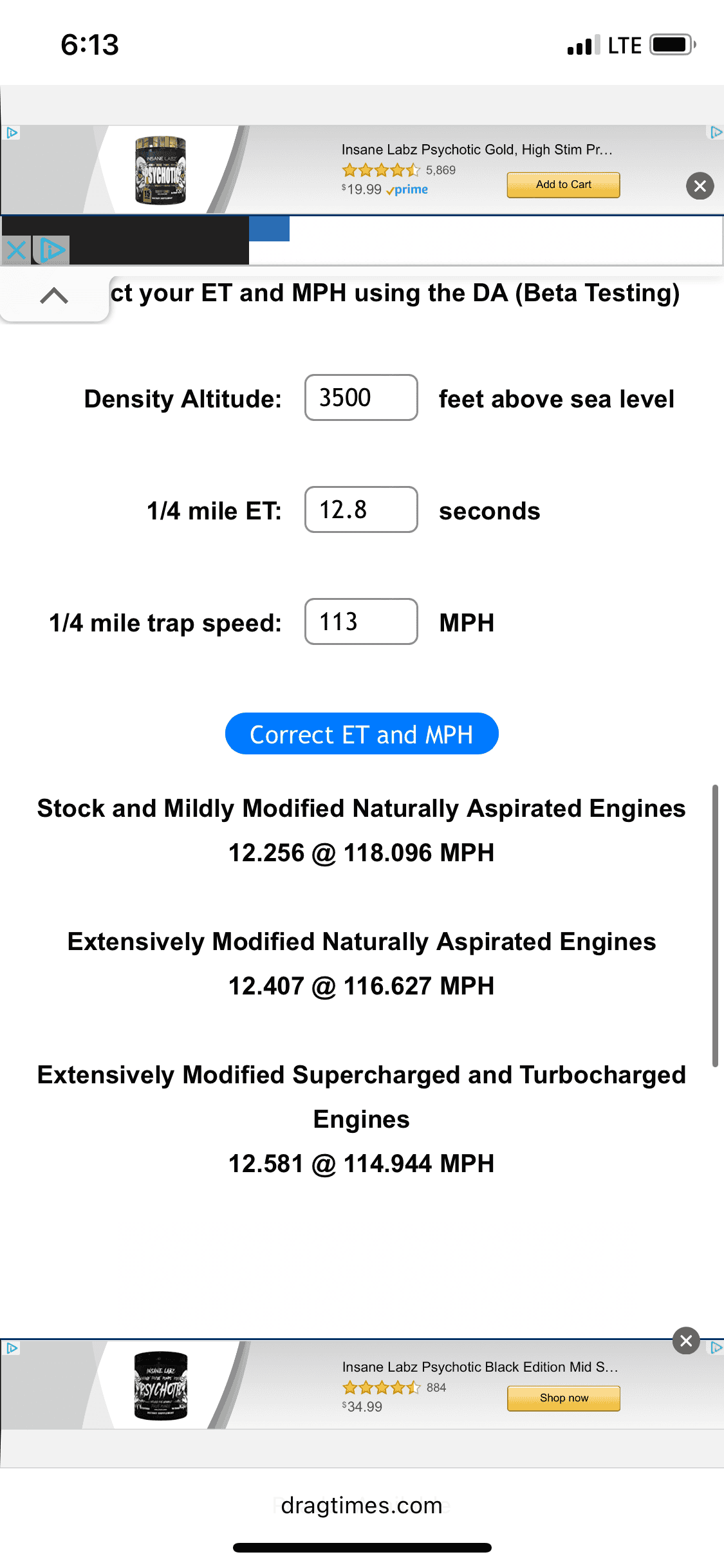

DA is huge on a stock n/a car. You’ll pick up 4-5 tenths and 4-5 mph easy on a 500ft DA day vs 3500DA Ive tested and tested this.

That definitely looks right. And as he works on those 60ft times he'll be knocking on 11s door.

Do you know what has the biggest effect on DA? I can’t change my altitude so will I need to wait for cooler temps to get a quality run?

You can reduce your DA below you actual altitude. Perfect DA comes at sea level, 59 degrees 29.92 barometric pressure and 0% humidity. Temp and humidity are your biggest factors I would assume in the summer in Oklahoma.

Noble elevation is about 1200 ft above sea level, Tulsa is 500 ft above. The DA's are drastically different as well. Noble's da seems to be above 1400 normally

DA does also play a role. 3% of a 400 hp car is 12hp for ever 1000'. If you can get some 500' runs, that's an estimated extra 36 hp vs your runs in 3500 DA.
