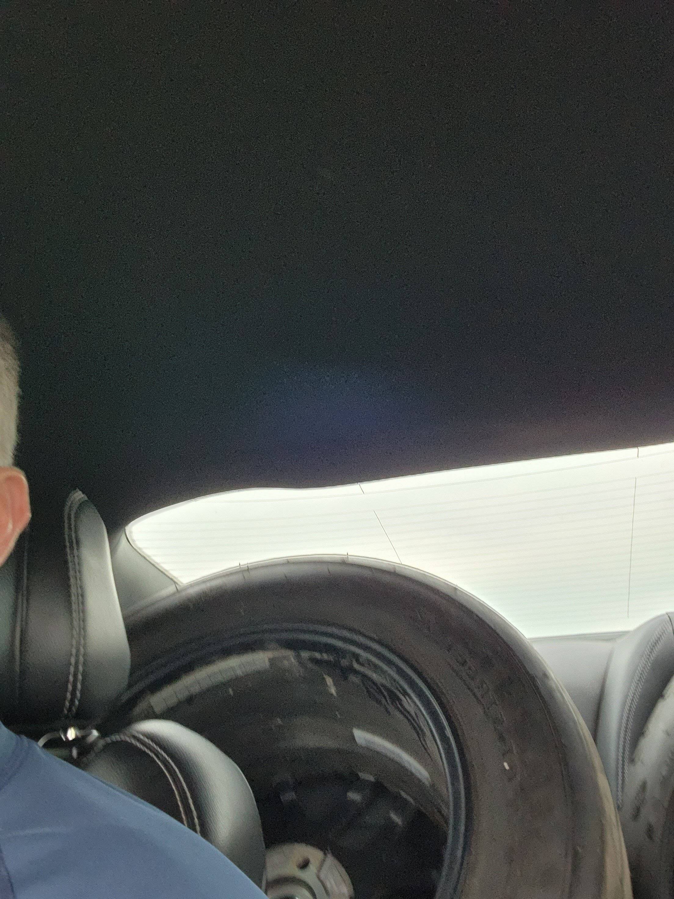

I just picked up this beadlocked drag pack in Pryor.
He ran his 18 pp1 on michelins at noble 12.8. Tulsa 12.3. Just FYI. We didn't get run at the throwdown last because of the rain. We will be there in 2 weeks at test n tune.
Man that’s a huge difference between tracks that are probably around the same elevation. It’ll be a few weeks before I can get back out but I saw Tulsa has a daytime test n tune on 10/1 so I’ll probably try to make it to that to see what my car does there. Nice grab on the tires
