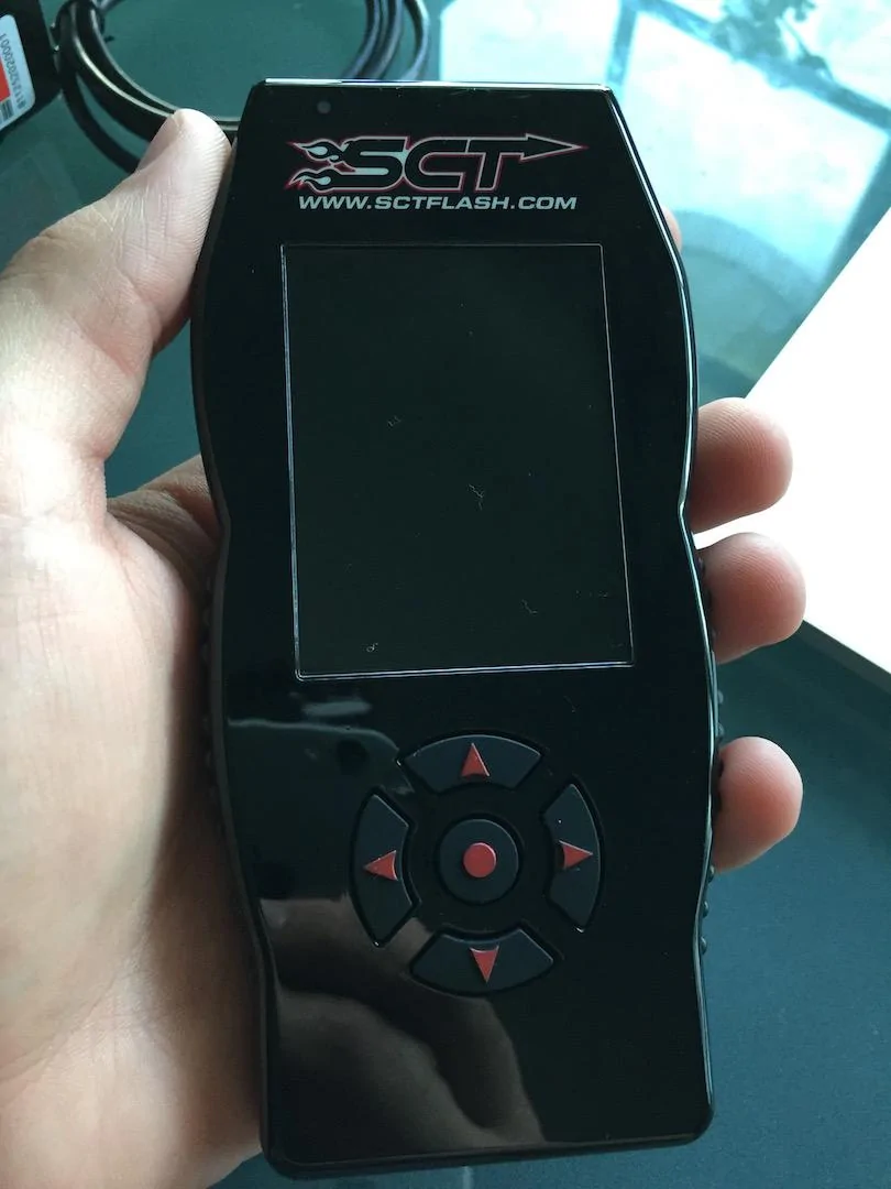

Did you receive the tune with the tuner as well?
No I had to mail Torrie the strategy code and serial number. Easy to do and he got back to me within 10min with the tune file! :headbang:
I love what he did with the transmission shifting! Just sent off the first datalog so we can get the tune dialed in. Once that is done I will be sure to do a full review and videos.

Let me know how it goes and what did you have to do to data log your car?
He requested a WOT run with these parameters monitored.
Throttle angle
Pedal position
RPM
IAT
ECT
Long and short trim fuel trims
Measured AFR both banks
VSS
Load
Spark advance
Knock retard
My damn 3k hesitation is still present.... Hopefully we can get that one figured out.

I need to send him my data log as well when I do it. How long did you have to do the WOT run?
I would certainly suggest doing the data log! I can send you the config file for Live Link if you would like. Pm your email and I will get it right to you. Just from the revised tune I just flashed I certainly noticed a increase in low end responsiveness and smoother overall operation.
Torrie did not specify a time for me. I did one that was no more then 12 sec I would say. Very easy to do on a decently flat and straight stretch of road.

Torrie is the man!! His latest tune revision has almost cured the 3k hesitation! There is only a slight dip in power and slight exhaust note change now. Waiting to hear back from him now on finalizing this tune revision.

Torrie's final tune revision is damn near perfect! Little to no hint of that 3k hesitation now. He said he needed to add more fuel sooner in the rpm band then what was there previously.
