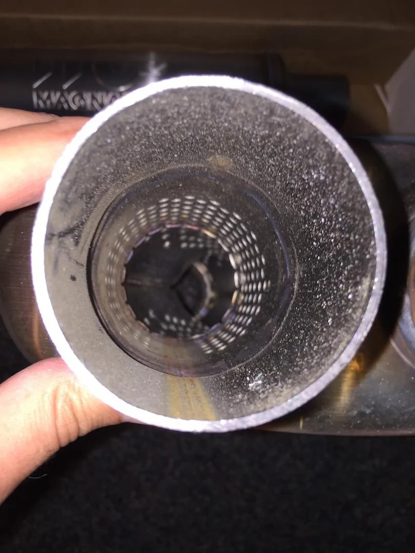

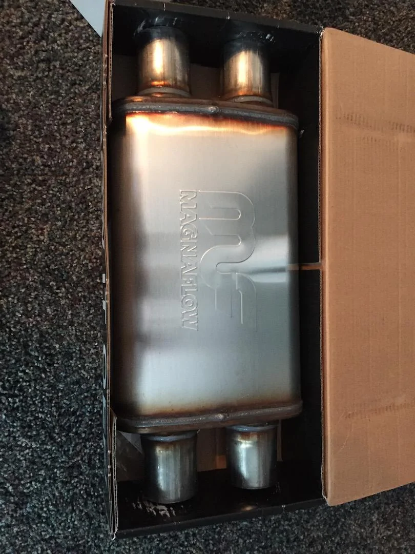

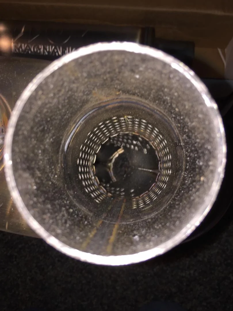

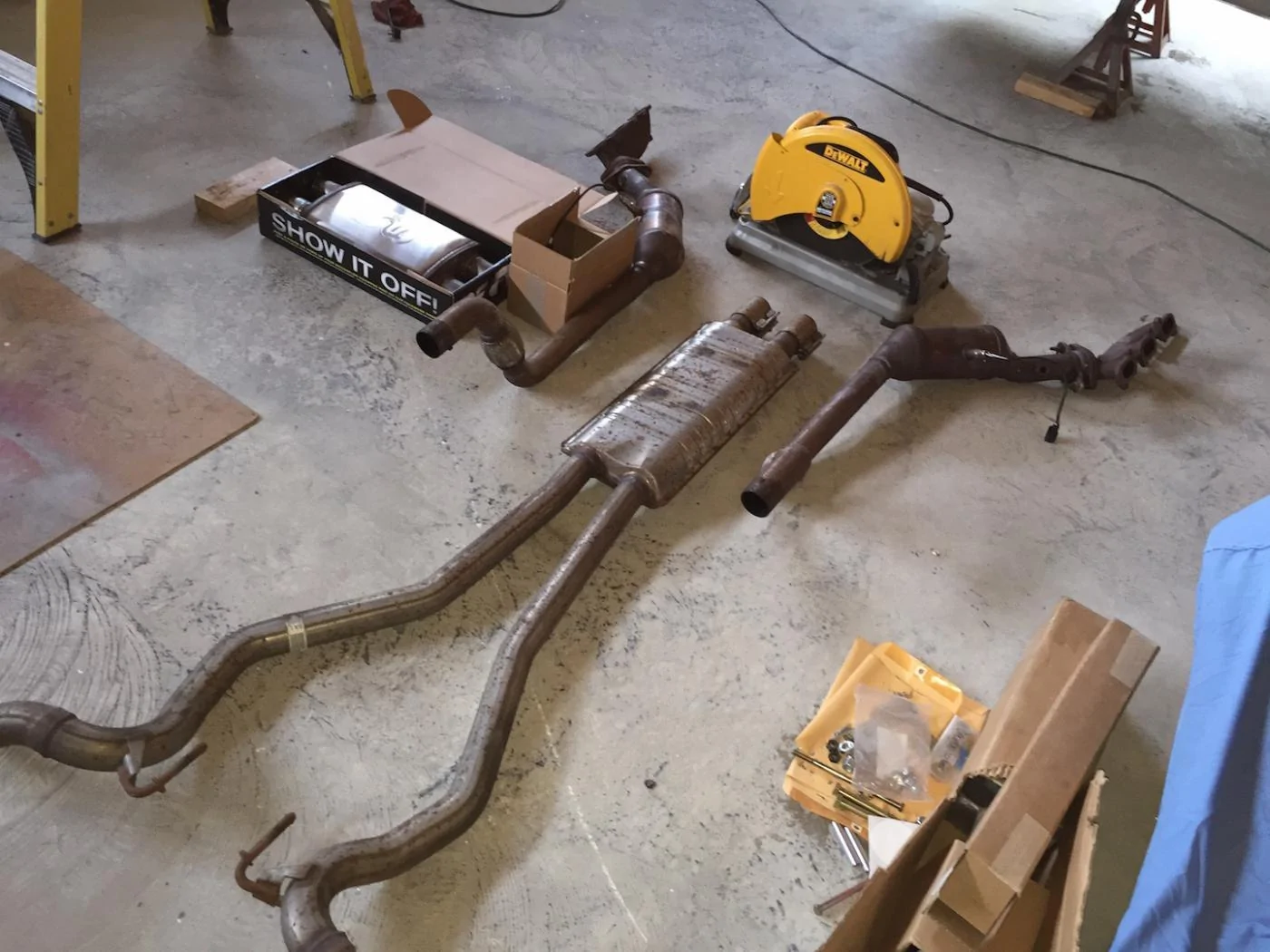

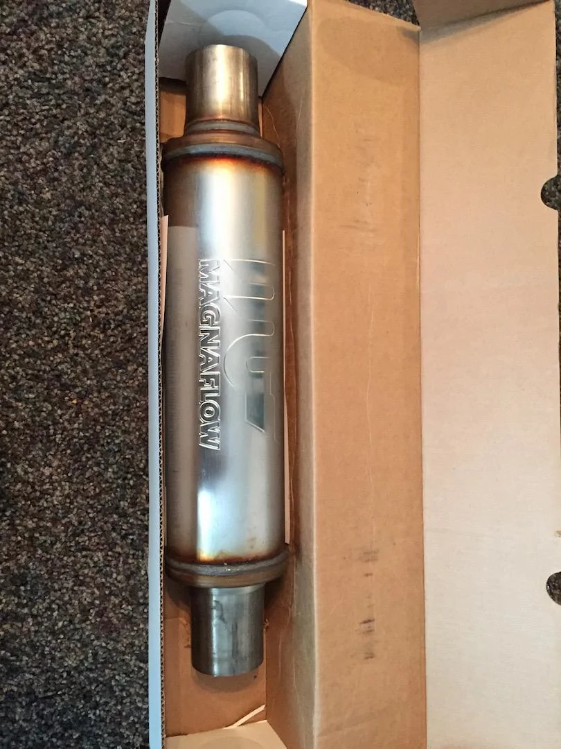

So it was like christmas when I got home from work today! I have to say, this is probably going to be the prettiest exhaust I have done thus far! :D

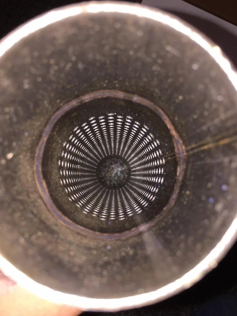

Last two pictures are the inside of the 11385 resonated x pipe.

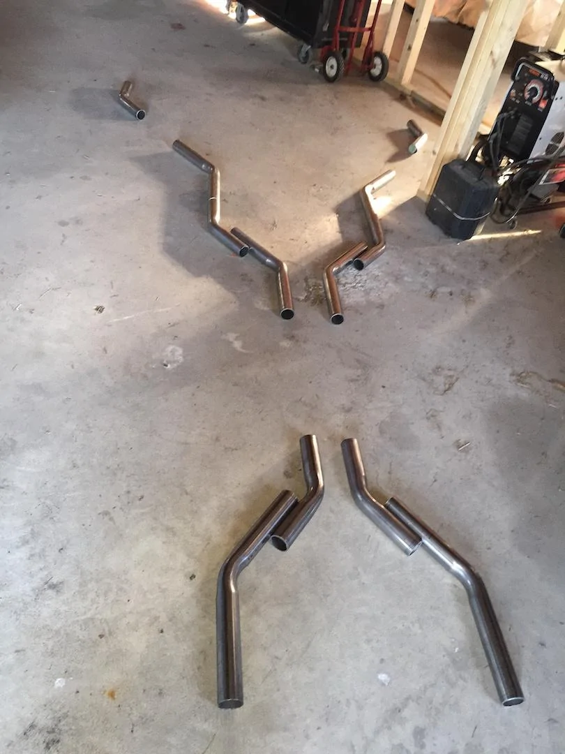

1970 Mustang, 1965 AC Cobra, 2023 Ford Bronco 2Dr

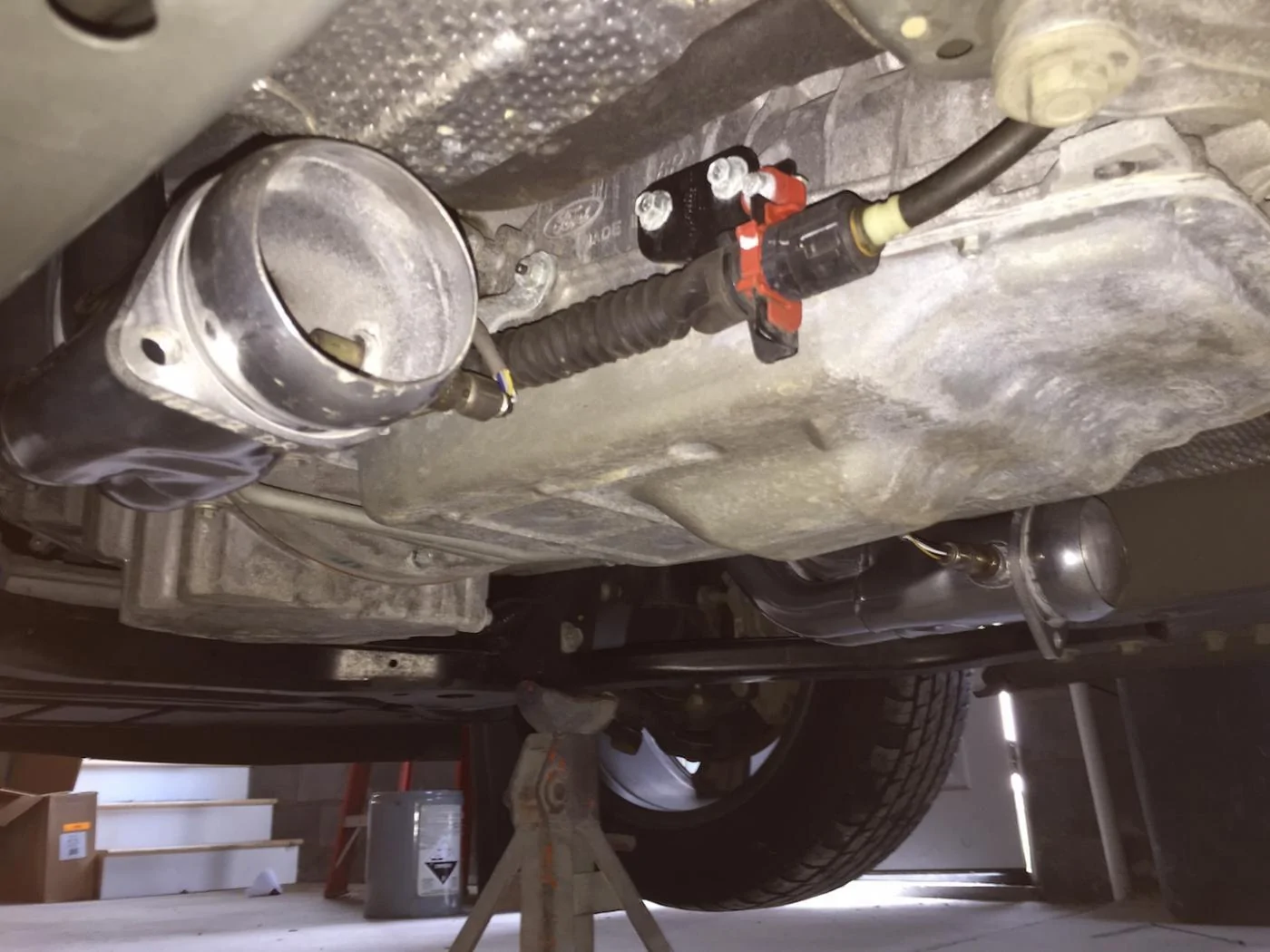

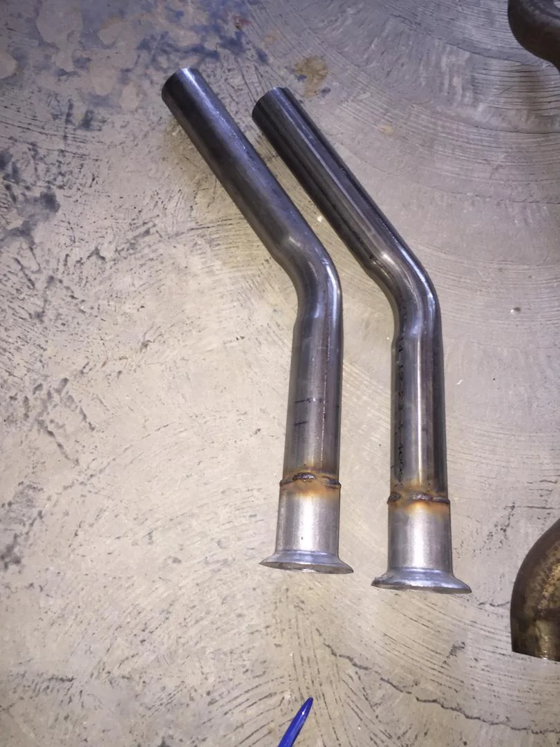

And the pipes have arrived! Everything is set now for this weekend. Tomorrow will consist of placing the car on jack stands, removing the OEM exhaust, and removing OEM headers. From there it will be installing the LT headers and getting the O2 sensors squared away (making extensions if needed). This will probably take the entire day. If not I will start on fabricating the mid pipe. Sunday will be completing the full header back exhaust and hopefully some sound clips!

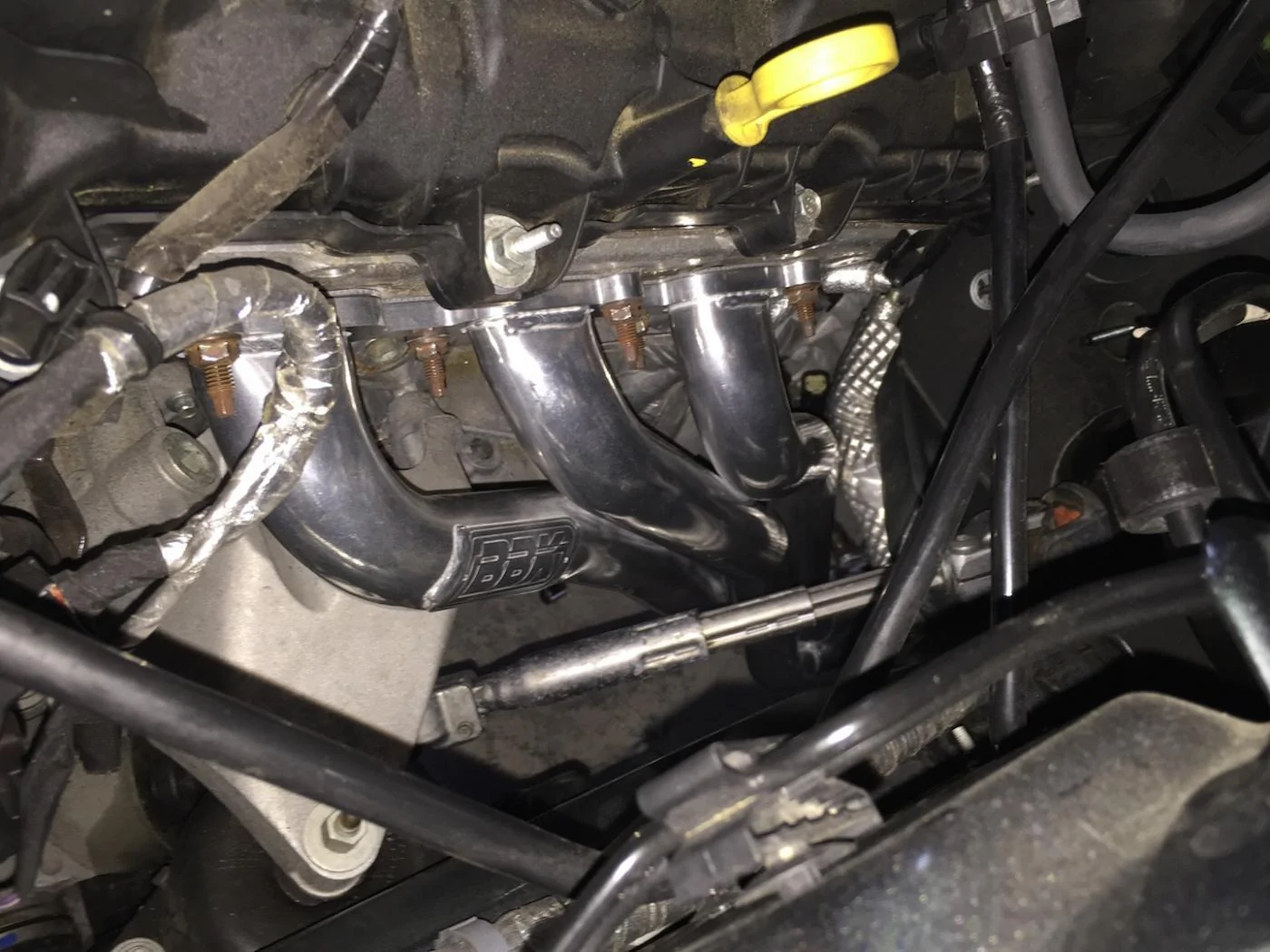

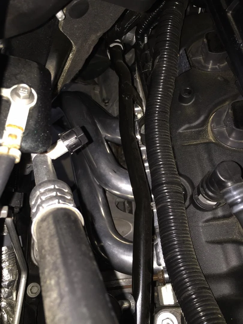

Progress!
Got exactly where I wanted to today!
