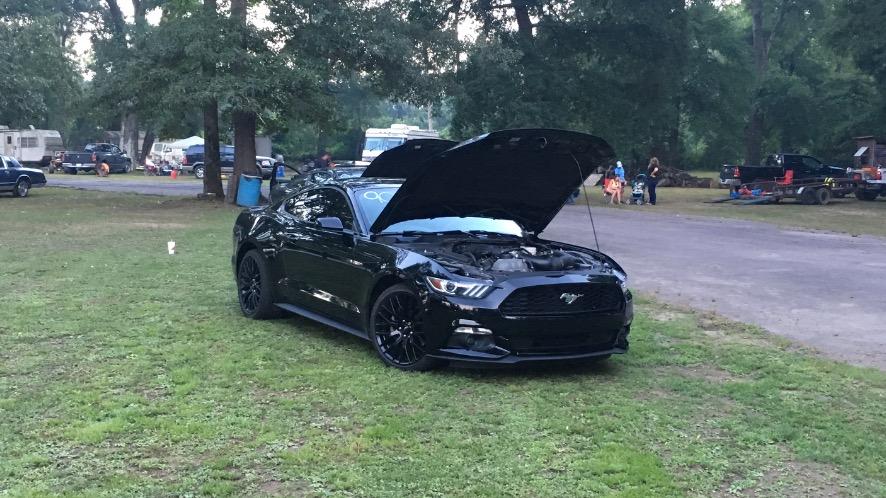

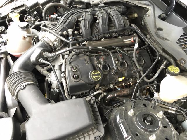

2015 Twin Turbo Mustang V6
So here, I have owned my car for a little over a year and a half and the time has come for some heavy modding :). I have been talking with Tom Y from Super Six Motorsports and he has been answering all of my questions that I need to know about this project.

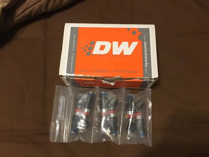

Yesterday I received my two 3.5 Ecoboost turbochargers with the exhaust manifolds from a 2013 F150. I have also purchased DeatschWerks 50lb/hr fuel injectors. I still need to purchase multiple items before I will be ready for twin turbo installation.
Below, I will post pictures of my car throughout my ownership (because I have never made a build thread yet) and throughout my journey on purchasing parts for this kit, installation, results, and performance videos.

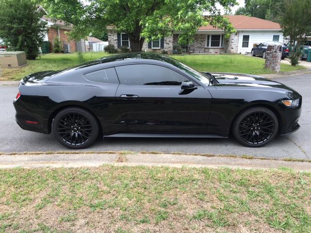

Current Mods:
BBK Shorty Headers
Muffler shop custom double X-Pipe
Muffler Delete
Unleashed 93 Tune
Mustang GT PP 19" wheels
Goodyear Eagle F1 255 (front) 285 (rear) tires
15% Window tint
Weathertech Floormats
Diode Dynamics LED reverse light
