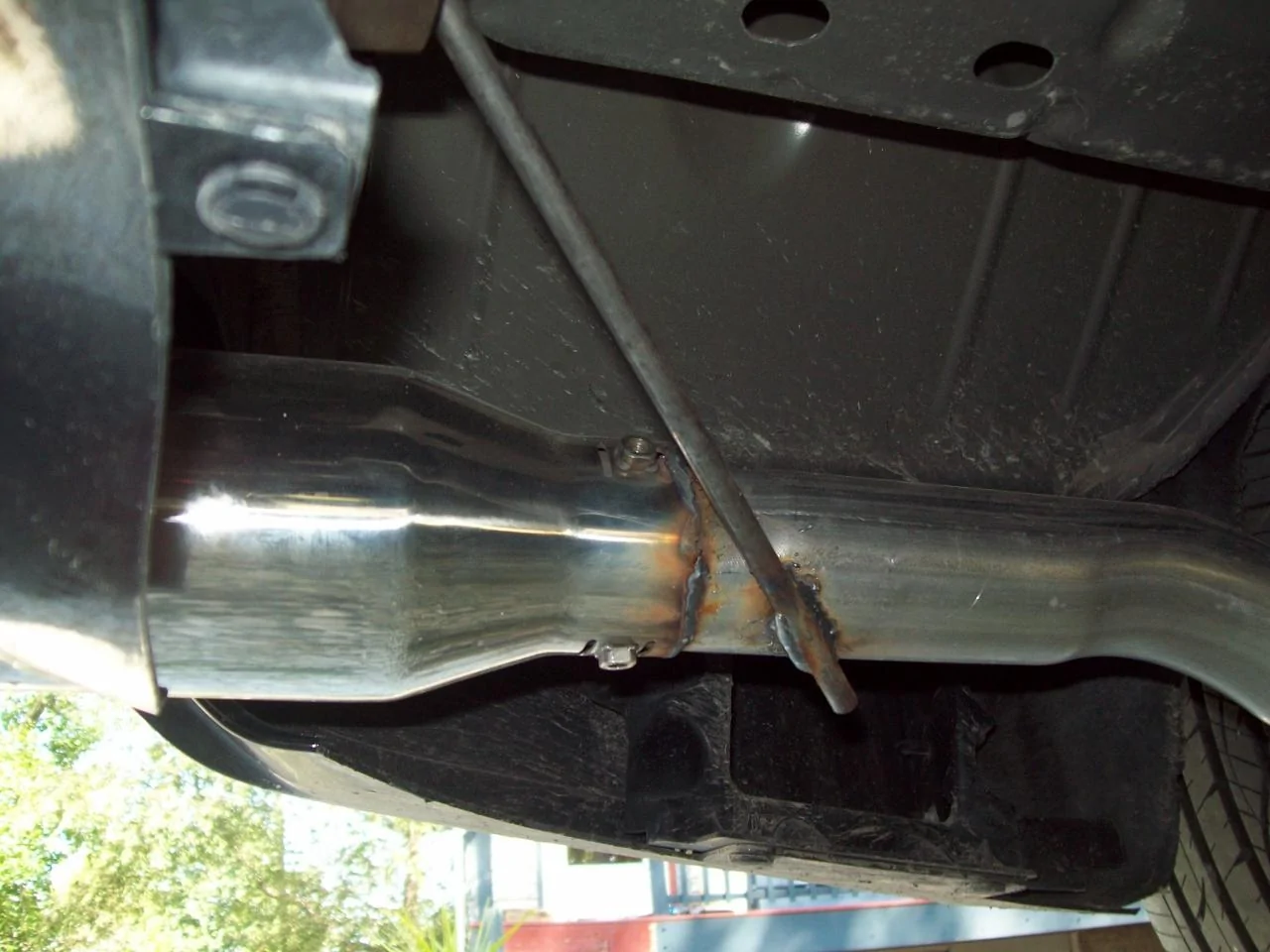

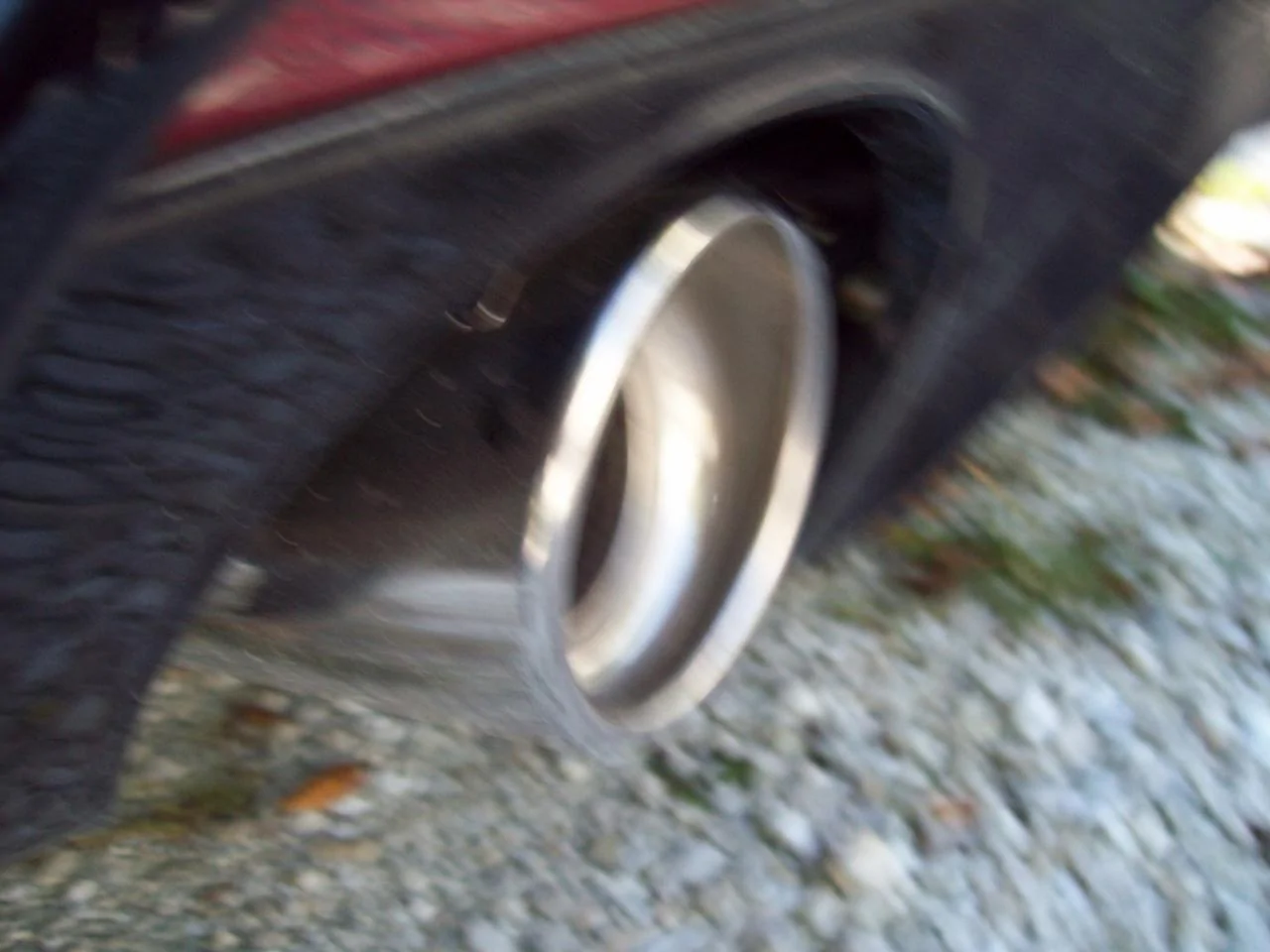

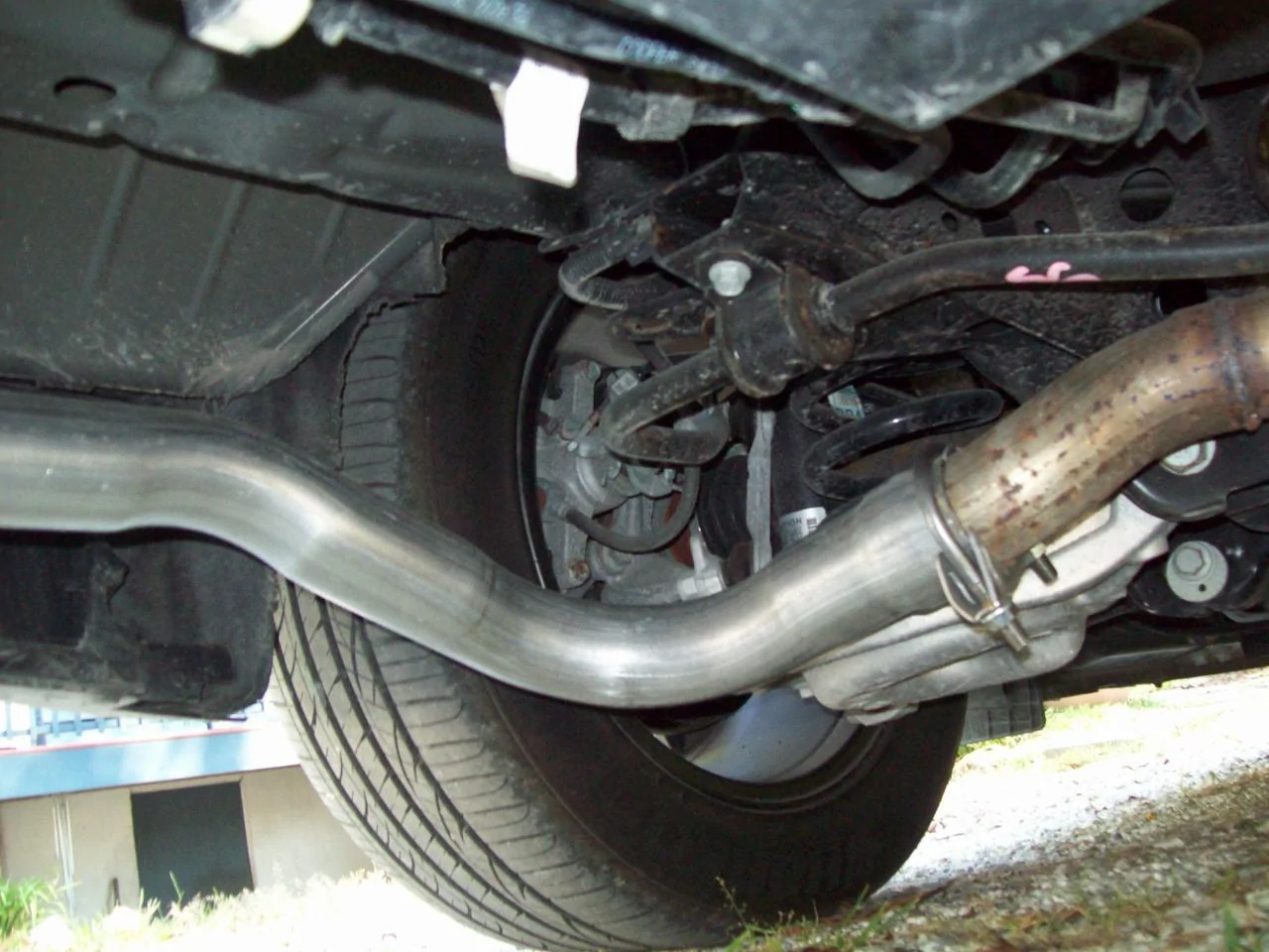

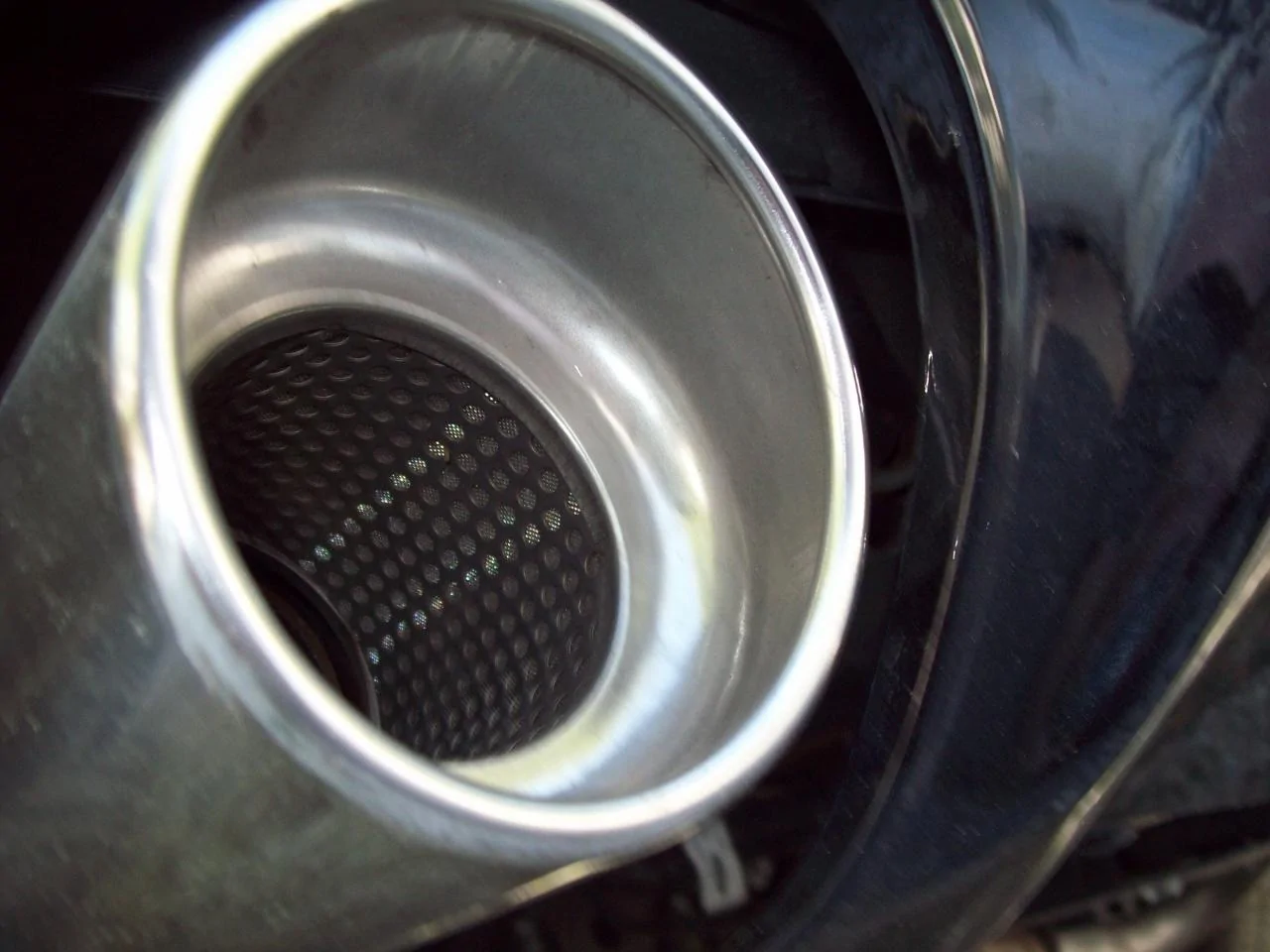

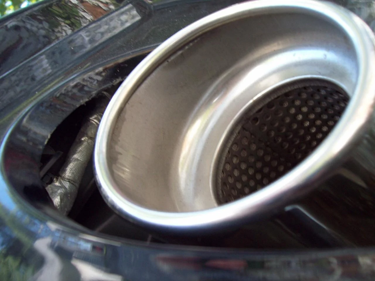

Hope these pics come through OK. Anyway this is whats been done so far. Notice the tips are recessed quite a bit. And yes no mandrel bends!

Everything looks good. The only thing that might help would be to have the tips moved out about another 1.5-2".
