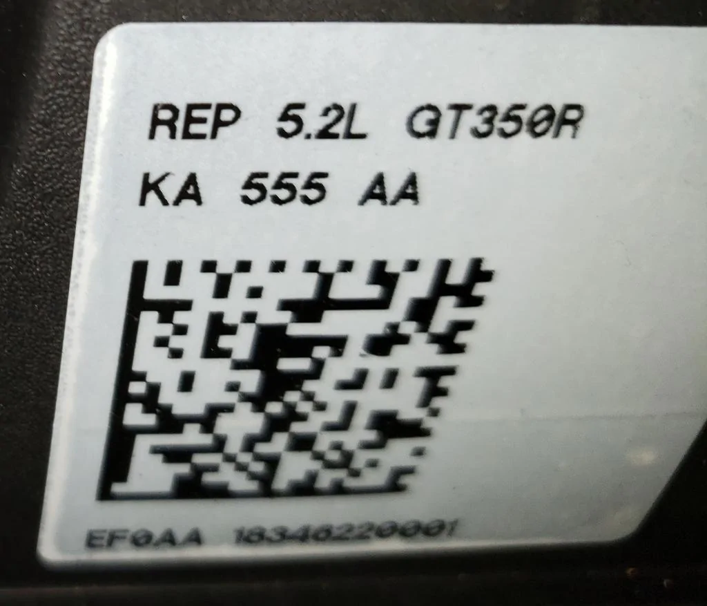

How much of a problem is this?
I Just had my Engine Replaced due to Oil Consumption and the Part number is different.
My Car is a 2017 GT350 H6088
They installed a GT350R Motor
You're lucky. That K at the start implies 19MY. So you got the newest engines with all the best bits.

Where is that code located? I’ll go look at mine.

R = replacement engine
REP = Romeo Engine Plant
the tech told me that the motor is an GT350R motor and he had to replace some sensors with "R"
versions since the intake manifold is re-used
I could have mis-understood what he said.

Not coded properly for R eng. The differences are mostly internal and the valve covers are different.
I am not aware of any external sensors that are different.
https://www.fordnxt.com/tech-storie...ms-build-the-shelby-gt350s-voodoo-5-2-engine/
From what I can gather, there are no Differences between the two engines,
the Valve covers are the same, I cant find different part numbers for internals. the only difference is the Engine identification Label.
I have been collecting data on this and check this thread on the information I have discovered.
https://www.mustang6g.com/forums/threads/gt350-r-engine-build-date-codes.117482/

So
So from what I have been able to figureout from my data collected is that the two engines are slightly different.
Data here https://www.mustang6g.com/forums/threads/gt350-r-engine-build-date-codes.117482/
the label is coded correctly for an "R" Engine
the fordnxt.com article is not correct in the statement that "the valve covers are different" nope, they are not.
the code 151, may be an internal code but not anywhere on the engine. the ID label shows the GT350R Engine has a code 555
the GT350 has a code 557. this is consistant between the 2016 - 2019 engine builds.
again, look at the data here https://www.mustang6g.com/forums/threads/gt350-r-engine-build-date-codes.117482/
