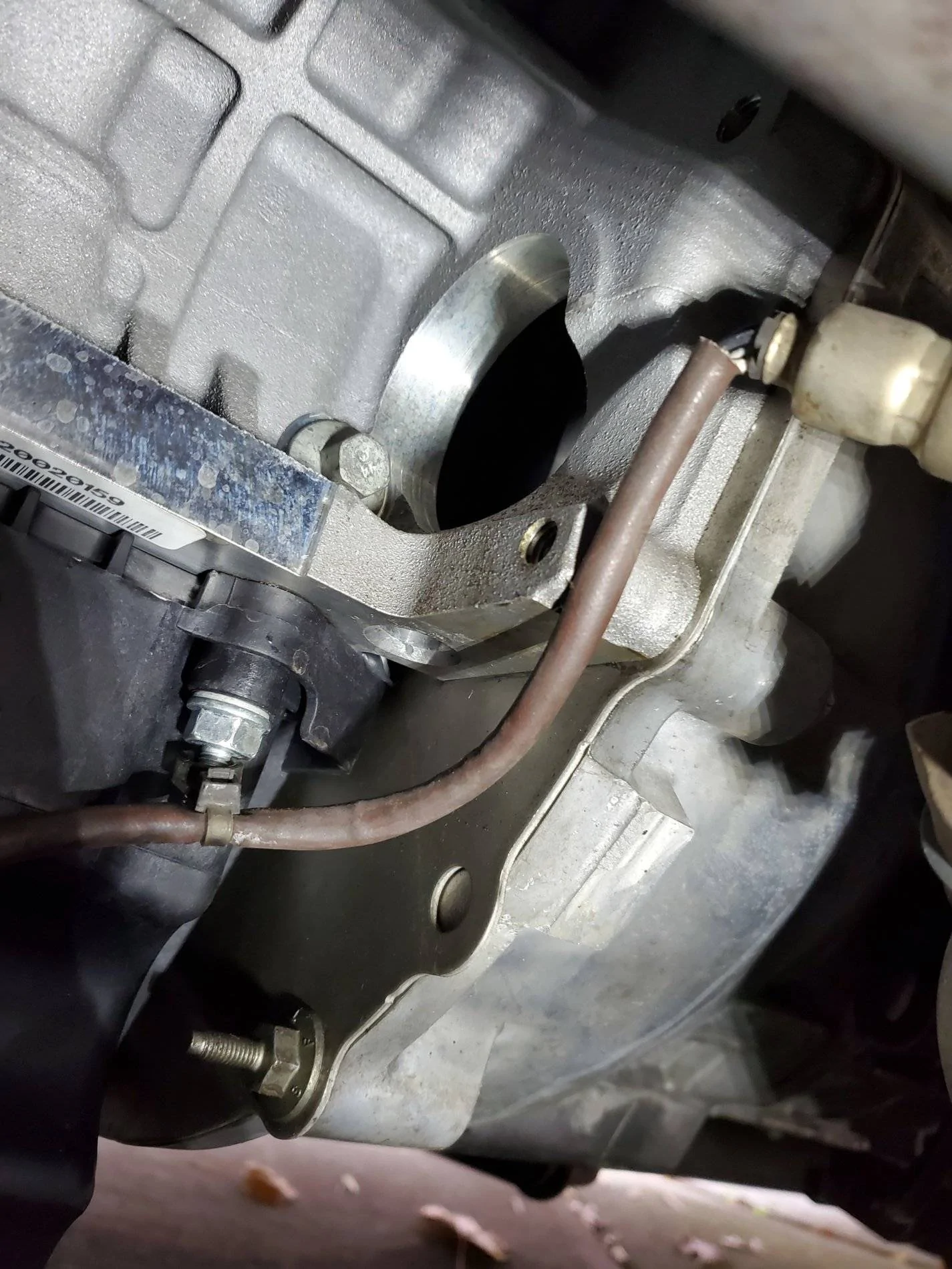

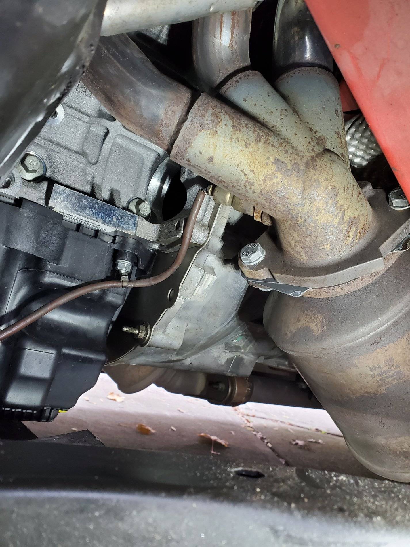

fmc_smt
Jun 4, 2018
39
1,293
2,622
Cottonwood , Arizona
2015 gt , 2015 Escape , 2015 F250
What's supposed to be here
There should be a rubber service plug there . Usually you will get a noise at cruise speed if it is missing .
