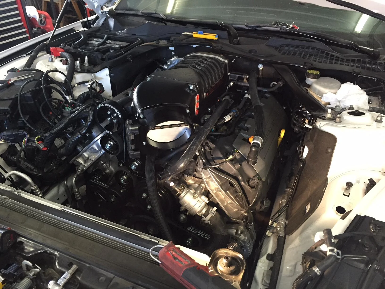

Well the Whipple is almost installed! Waiting really is the worst..lol..also I still have the stock cats. Is a high flow cat any better or should I just eliminate them altogether?

Update! Car has been running the Whipple now since March of this year. Switched to a PB Dyno tune and has been making 709WHP on pump 94 for over 15000KM's (9300 miles) and a drive from Alberta to California and back and the car has been running perfect. Runs no different then when it was stock until I punch the gas. Now I have OPG done and 3.6 pulley with LT headers and 800whp. Switched the oil to 5W50 and is now put away for the winter. See how it holds up next summer I guess.
