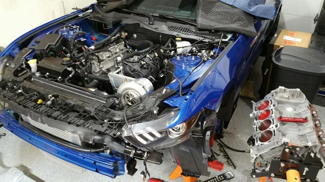

I'm one of the ones where it didn't work out. My car dyno'd 580ish on a mustang dyno, which would be a little over 600 on a dynojet. I'm not blaming anyone or any power adder. I managed 9000 miles supercharged and lost compression in two cylinders. But I did not baby it. I'm kinda glad it happened, because now I get to make it better. Just be prepared for this...
Man, sorry about your luck but that thing will be so sweet once it's done...it looks bad ass just sitting there stripped down like that! :hail:

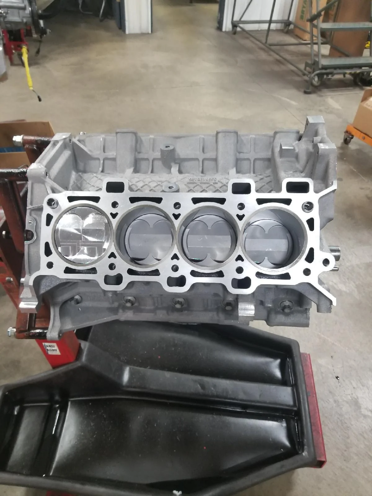

Just curious.. How much money is all of it costing you? Labour, parts etc.
It can vary a lot depending on when you buy, what you buy, etc.
For me I have over $7k in the shortblock with extras that are likely overkill, but nice parts... like billet rear main cover, billet chain guides, etc, etc. ARP bolts everywhere which get pricey. And I didn't even get it sleeved. I probably should have, but you have to draw the line somewhere.
Plus, I might as well change the clutch and I haven't decided what to do with transmission yet. So figure at least another couple thousand.
Labor, that's all me.
PS. I also want to say, this should not scare you from adding forced induction. There are many people out there pushing way more power and do not have issues. There are a ton of factors involved (factory tolerances, heat, gas, tune, etc) You can't point your finger at specifically one reason. I would supercharge a stock one again in a heart beat. But you can't be all pissed off when you double the horspower of your motor and it doesn't work out.
