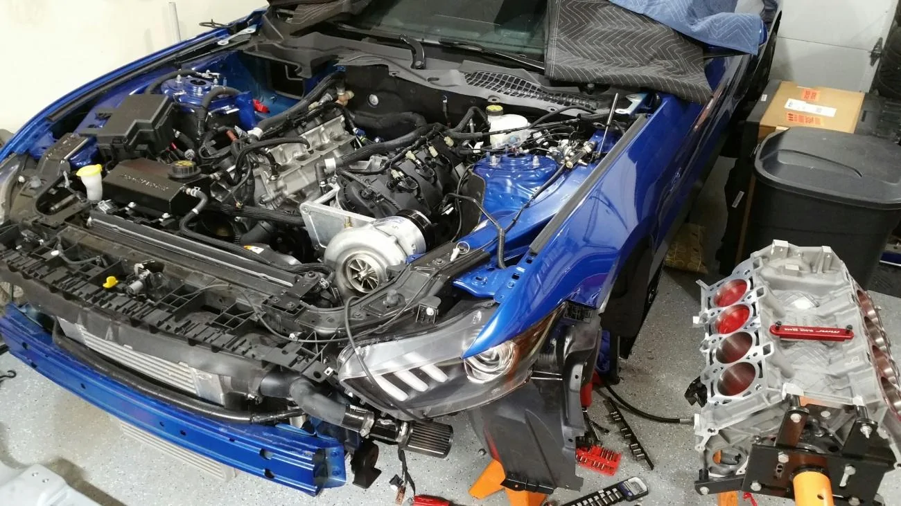

I'm one of the ones where it didn't work out. My car dyno'd 580ish on a mustang dyno, which would be a little over 600 on a dynojet. I'm not blaming anyone or any power adder. I managed 9000 miles supercharged and lost compression in two cylinders. But I did not baby it. I'm kinda glad it happened, because now I get to make it better. Just be prepared for this...
