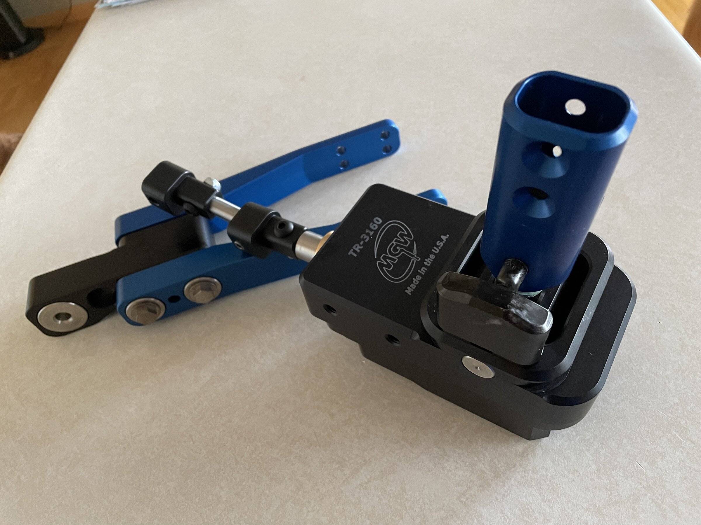

Just got mine yesterday! Excited to see how it feels once installed. The construction of this thing is amazing.
