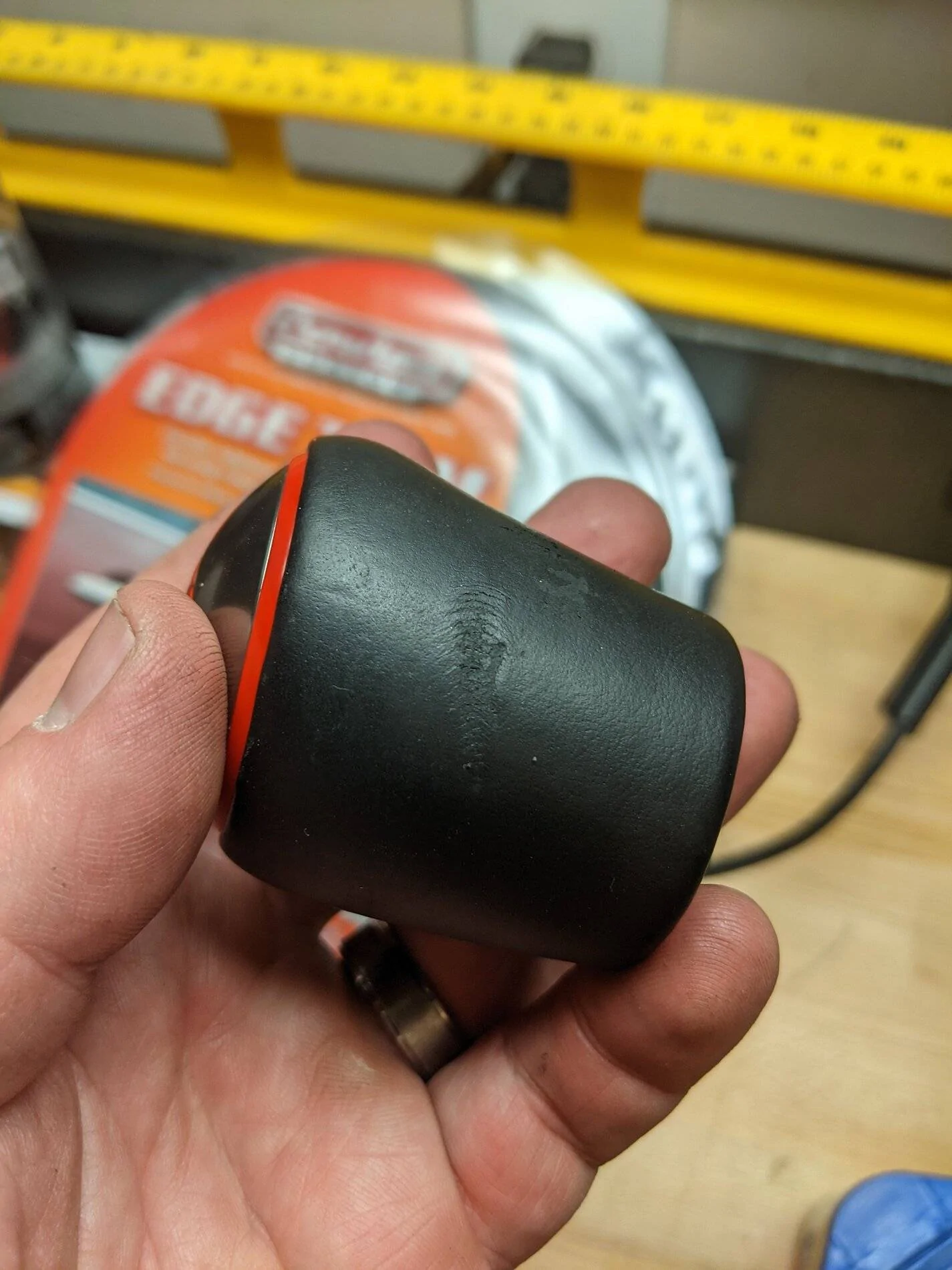

I did have some minor damage to the knob from my attempts with the strap wrench - I wish I had used heat earlier!

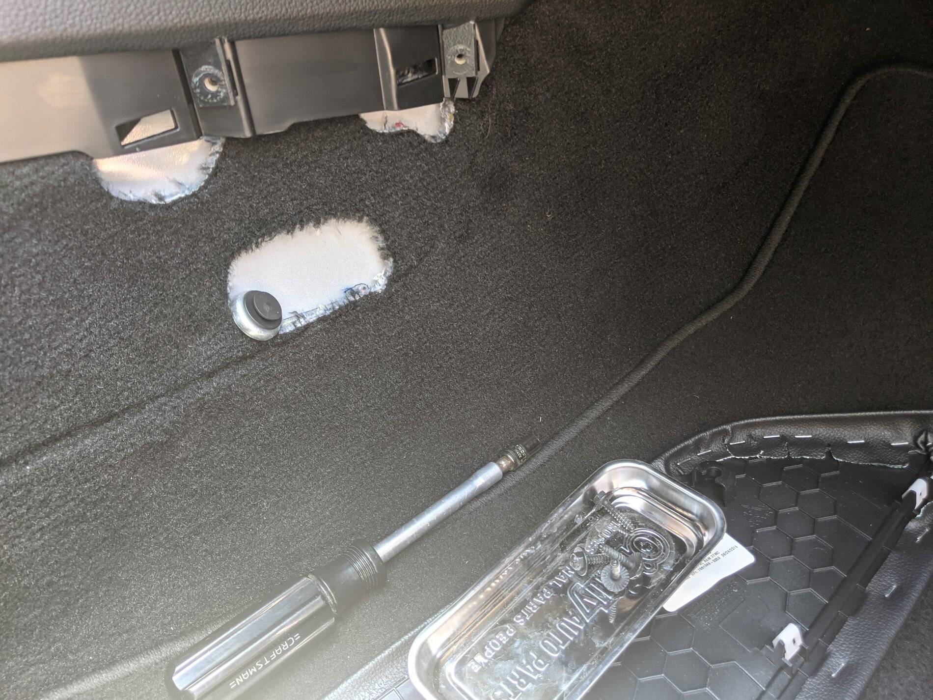

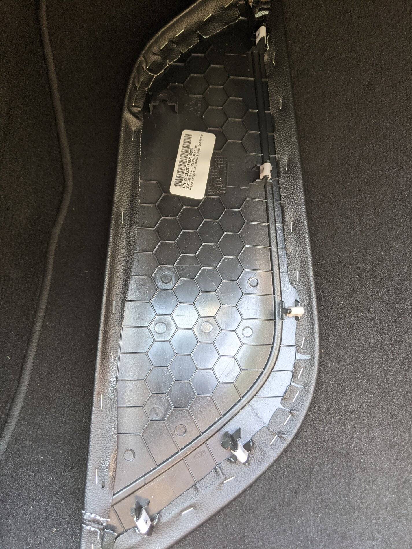

Ok, with knob removed, time to pull the console. First, removal of the side panels. One note is that they have magnets in slots on the inside to hold to the transmission tunnel. In my case, for one panel the magnet stayed behind.
No big deal, it just slides back in.

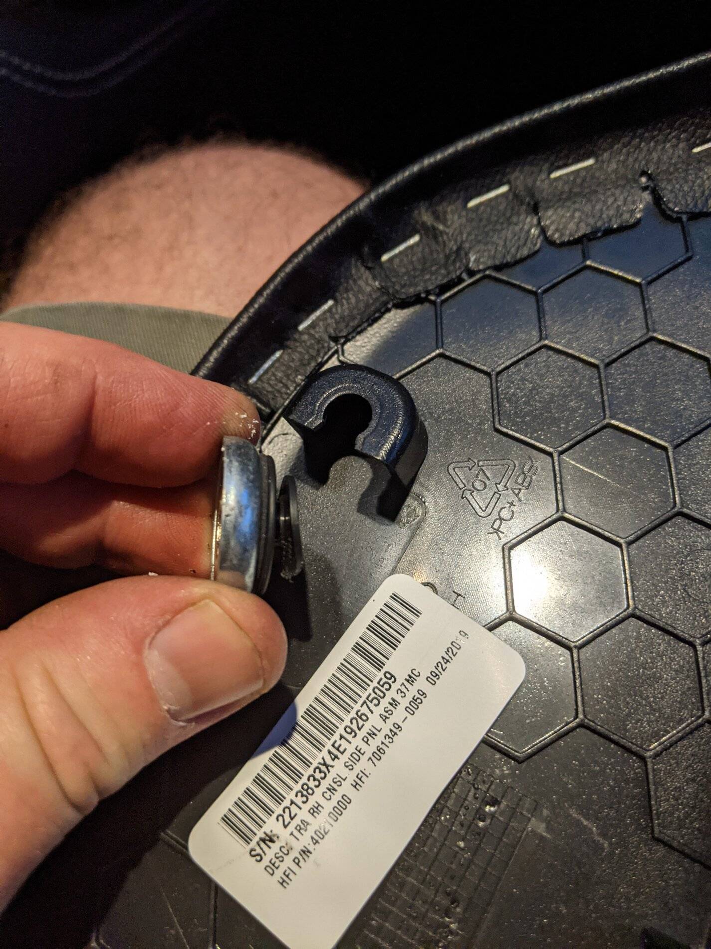

Now take the console off - mine came off with shifter boot still attached. There are a number of clips, and one of the clips on mine was lost to the inside of the car someplace never to be found again, but there's been no noticeable impact to fit of the replaced console nor any movement or rattling.

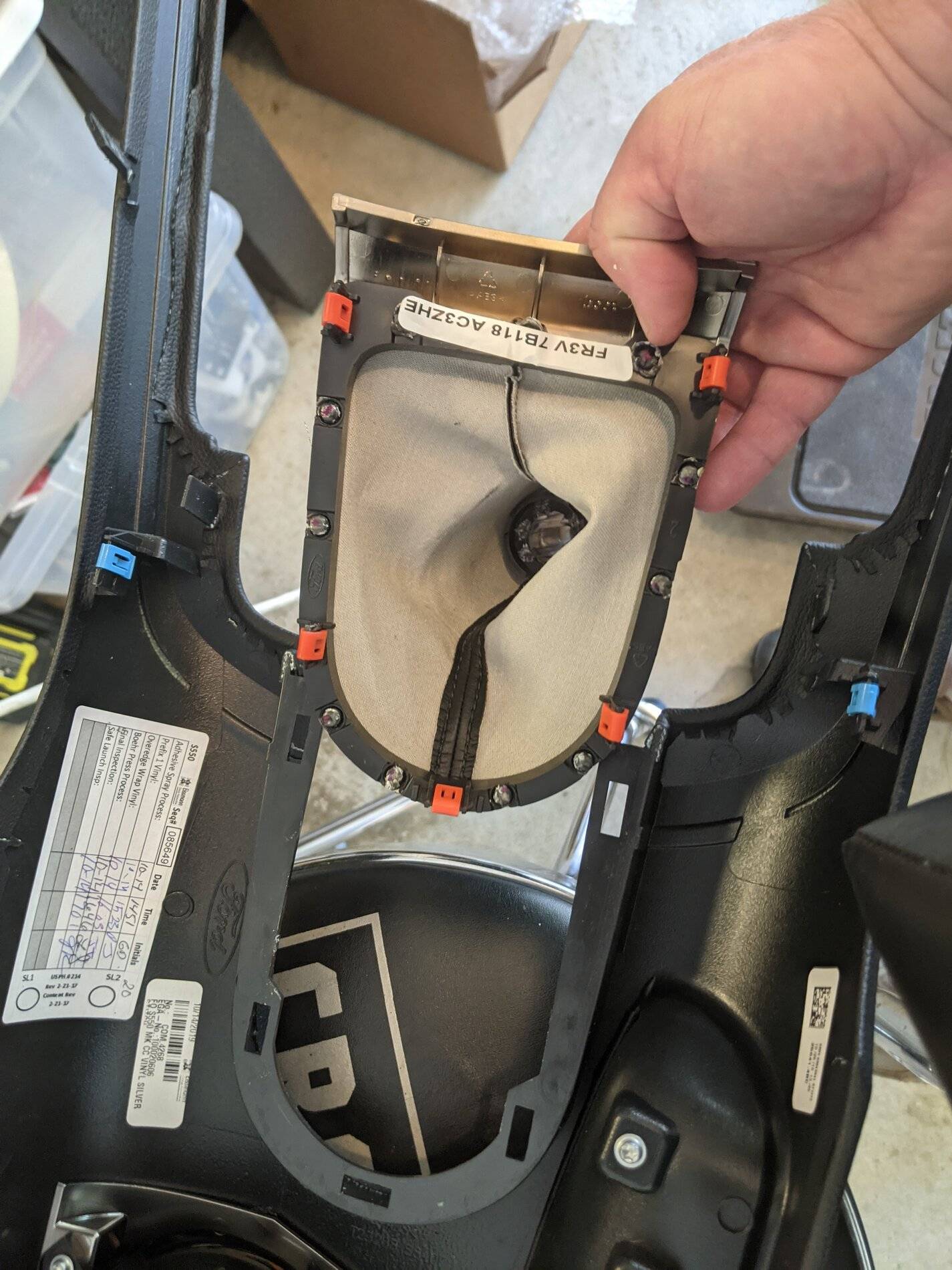

Remove the shifter boot from the console. The blue clips you can see below are the ones I referred to earlier - one of which is apparently gone forever like a lost sock in the dryer.

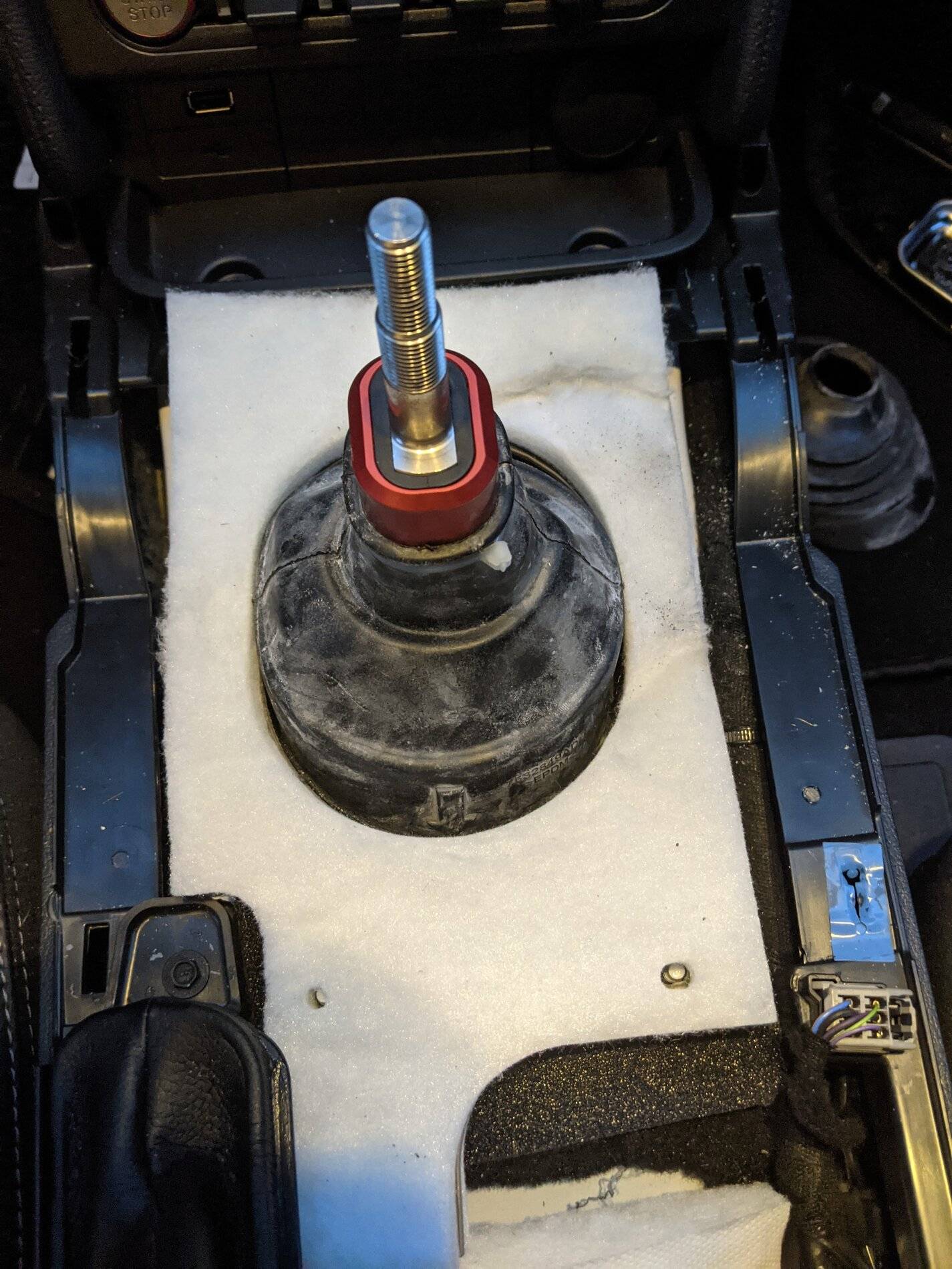

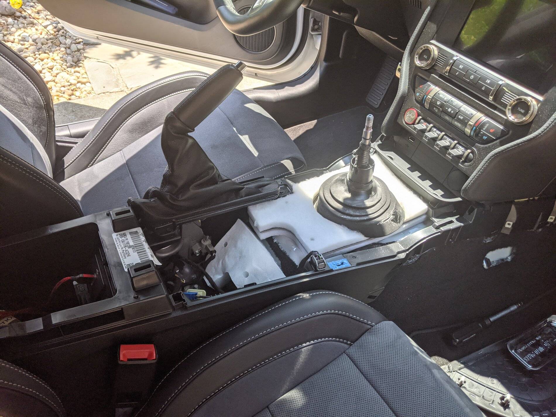

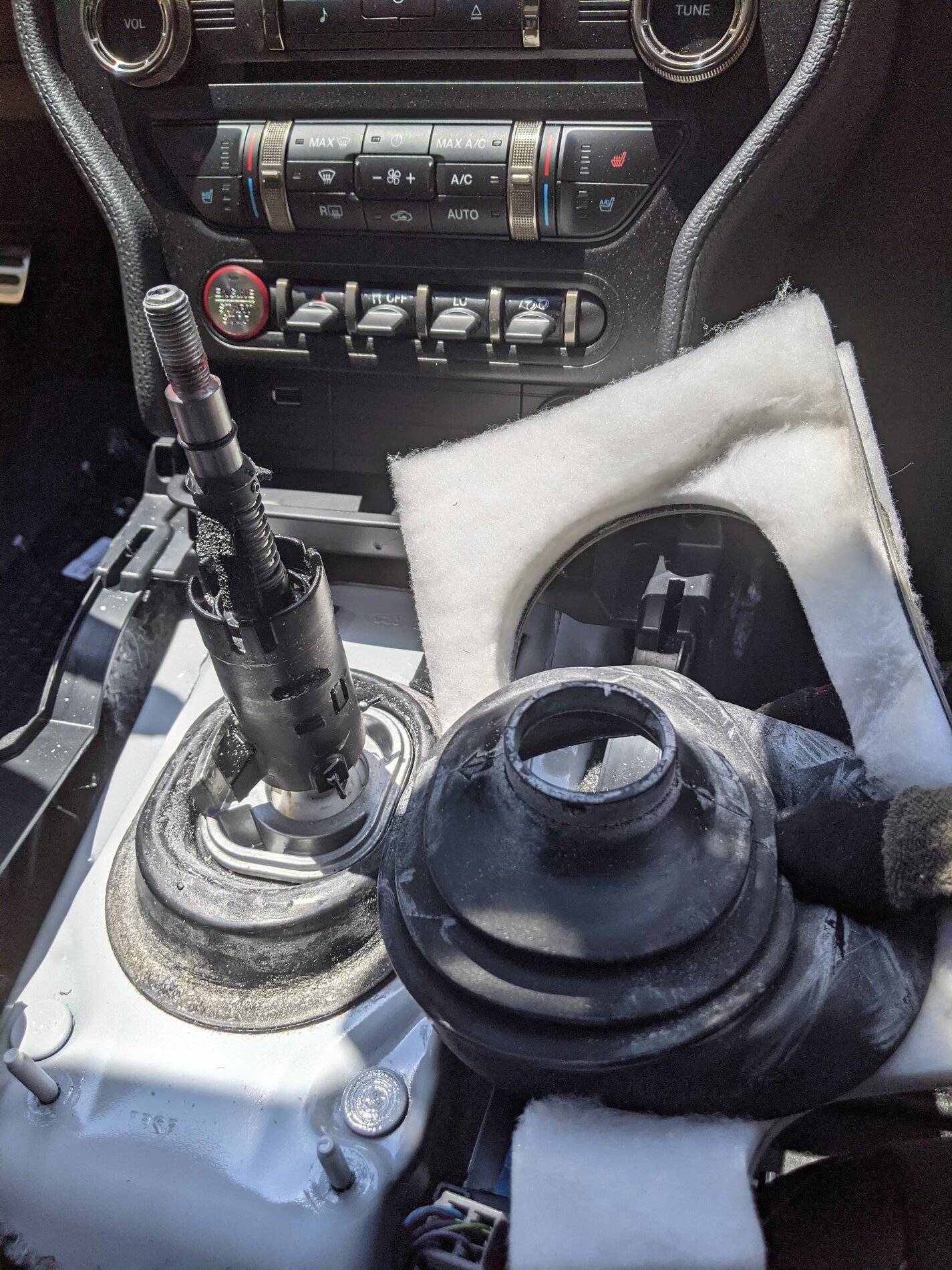

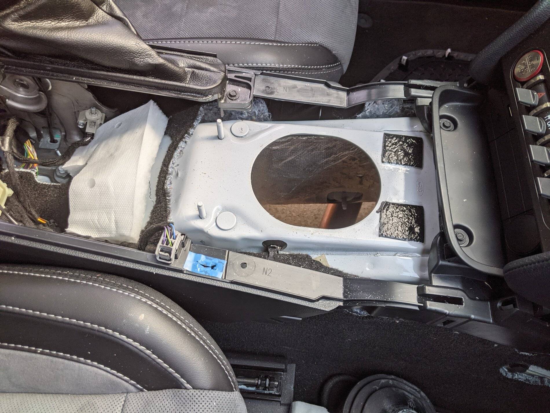

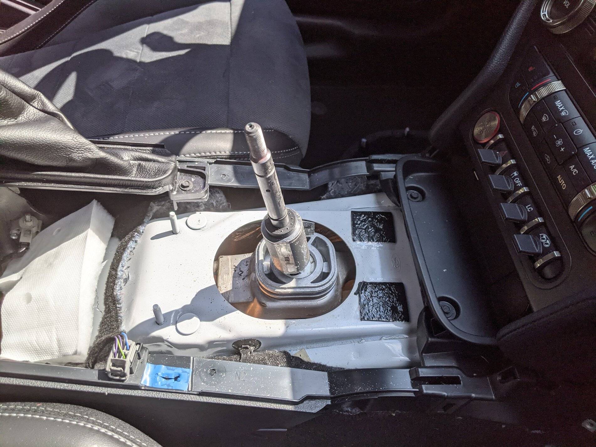

With this out of the way, remove the dust boot and sound padding.
Remove the reverse lockout.

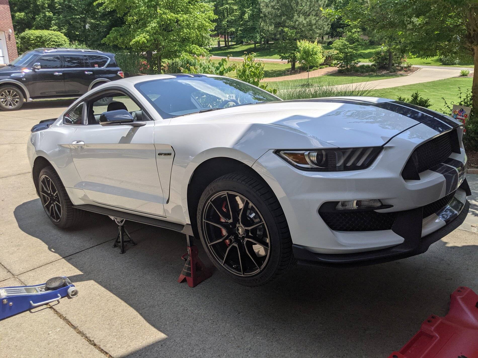

Ok, time to get dirty! As my brother hasn't freed up time yet to build my detached garage mahal, I'm stuck doing this in the driveway, so up on jackstands she goes.

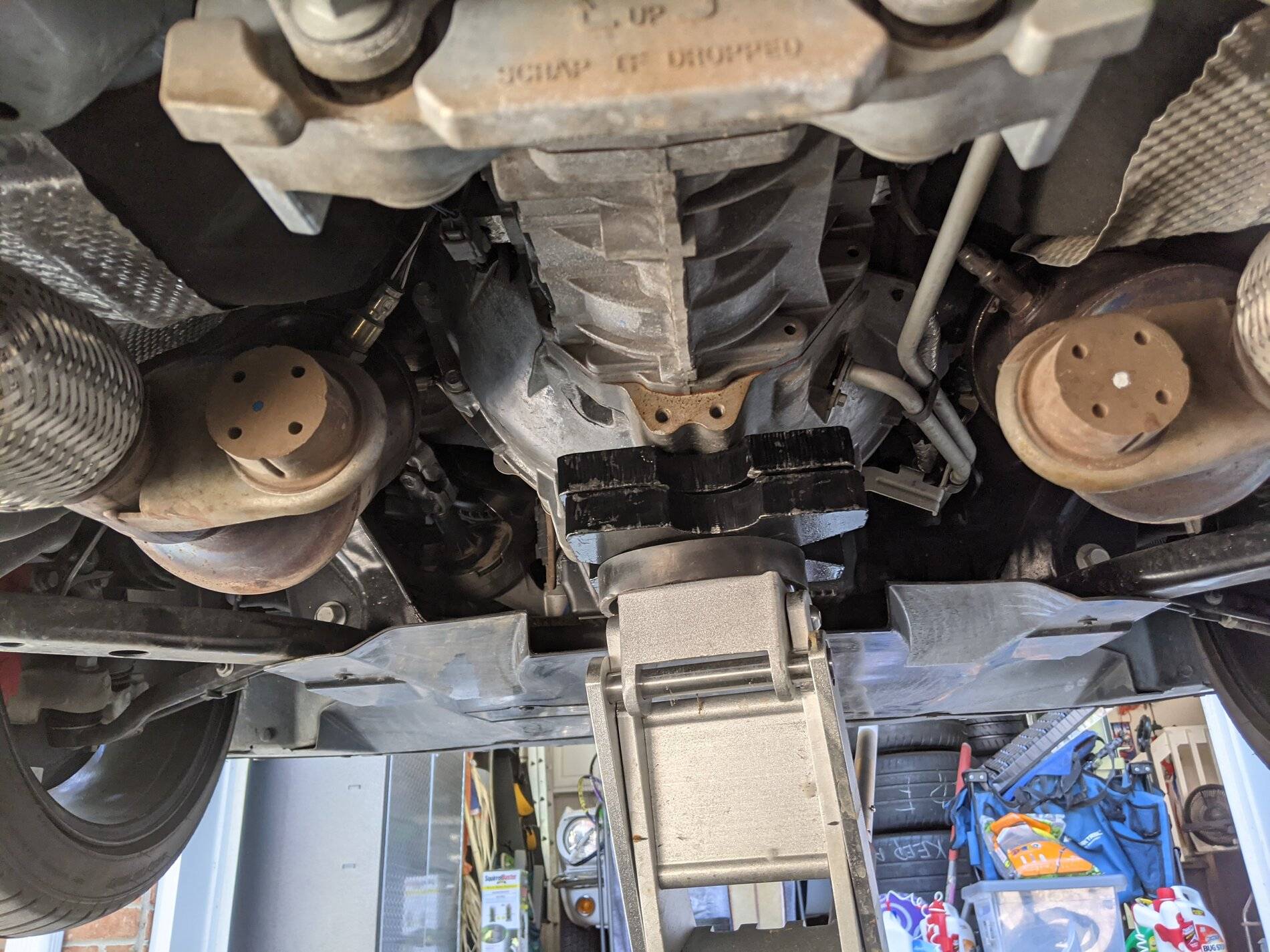

And now it's time to drop the transmission. I don't have a transmission jack, and my floor jack doesn't have quite a long enough throw with the car up on jackstands, so I used press plates from my shop press to make up the difference.

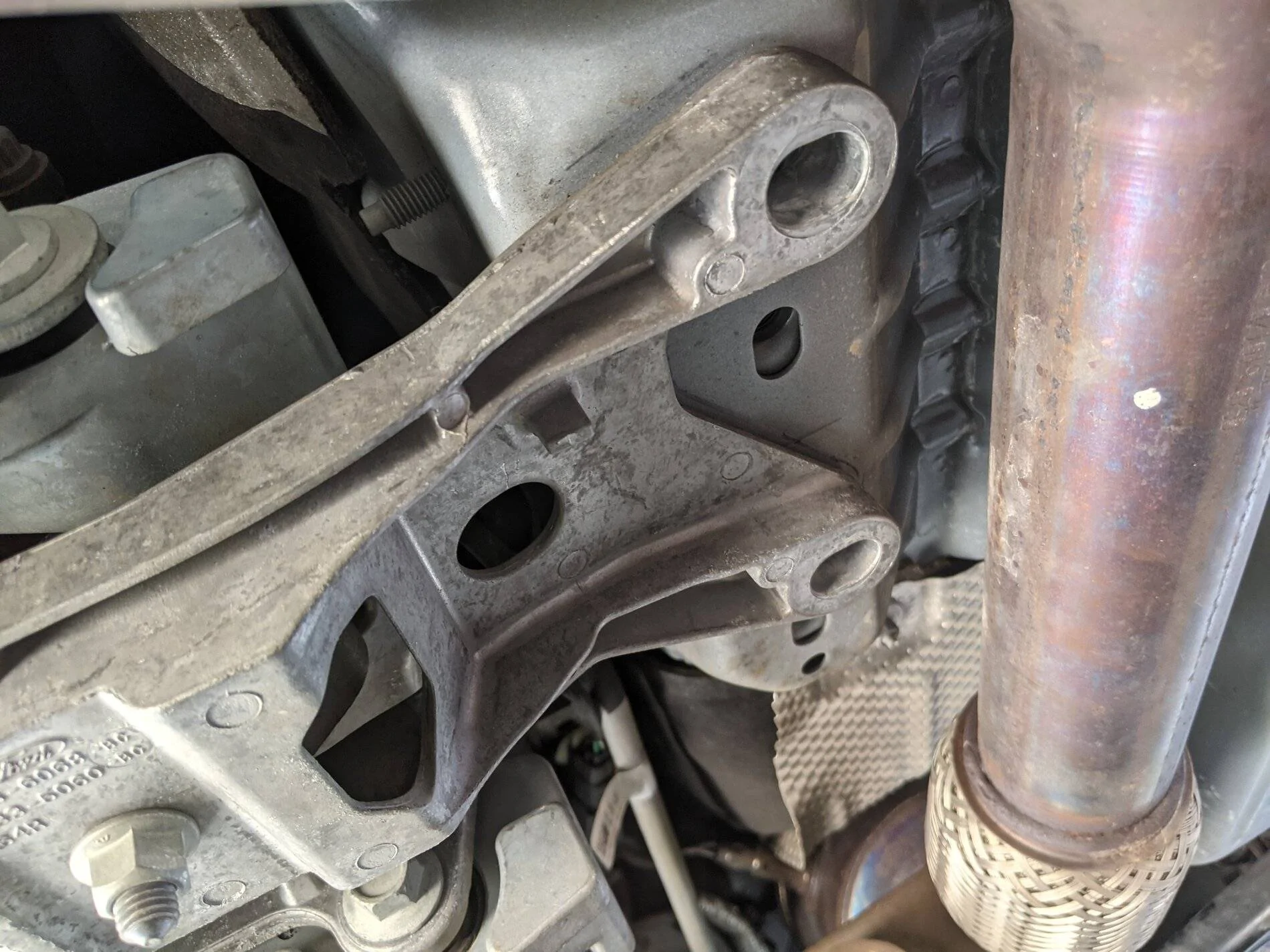

With the transmission lowered, the rear bracket can be removed.

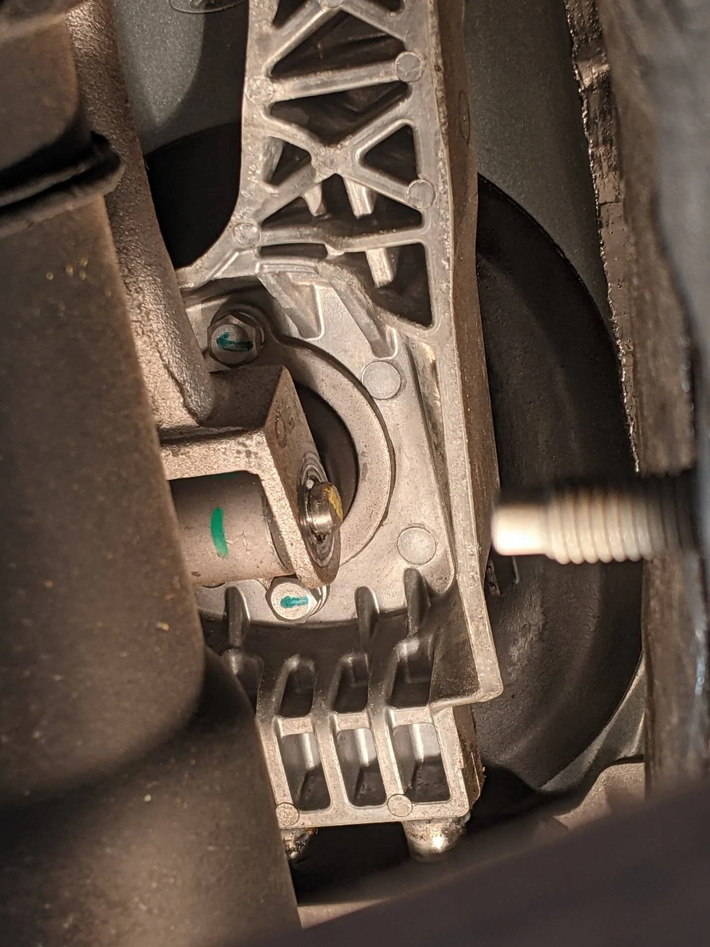

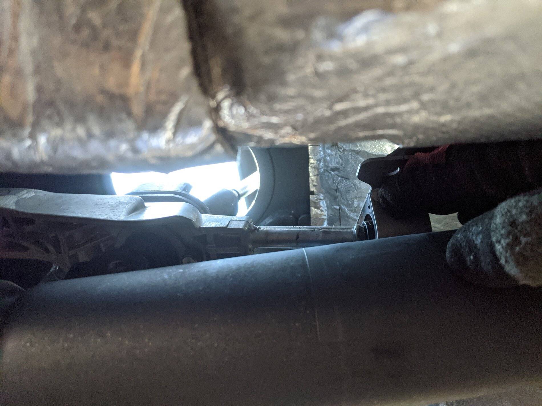

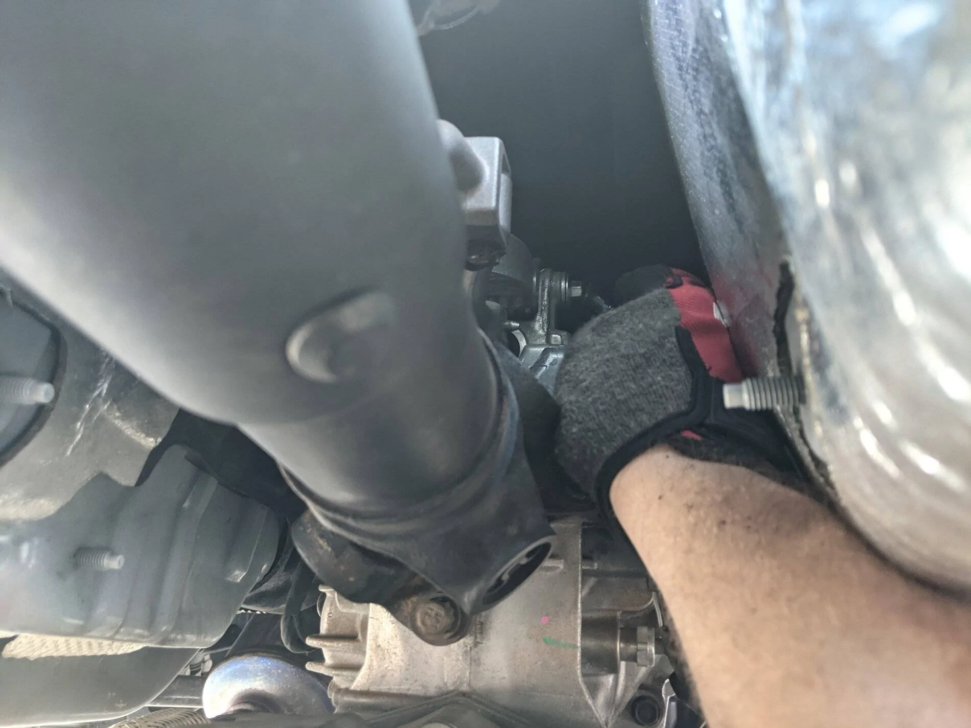

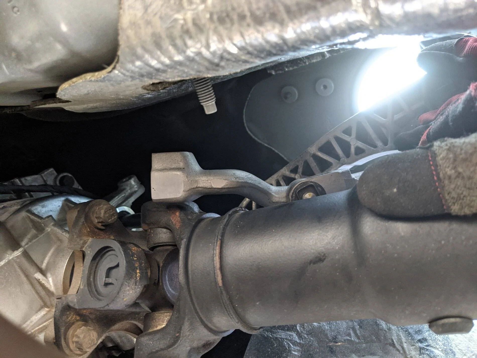

Next is the top arm bolt, which can be awkward to get to. I don't have skinny forearms or slender hands, but was able to get to it by coming at it along the driveshaft from the back rather than up from underneath. Just be ready for some scratches and bruises - typical wrenching damage.

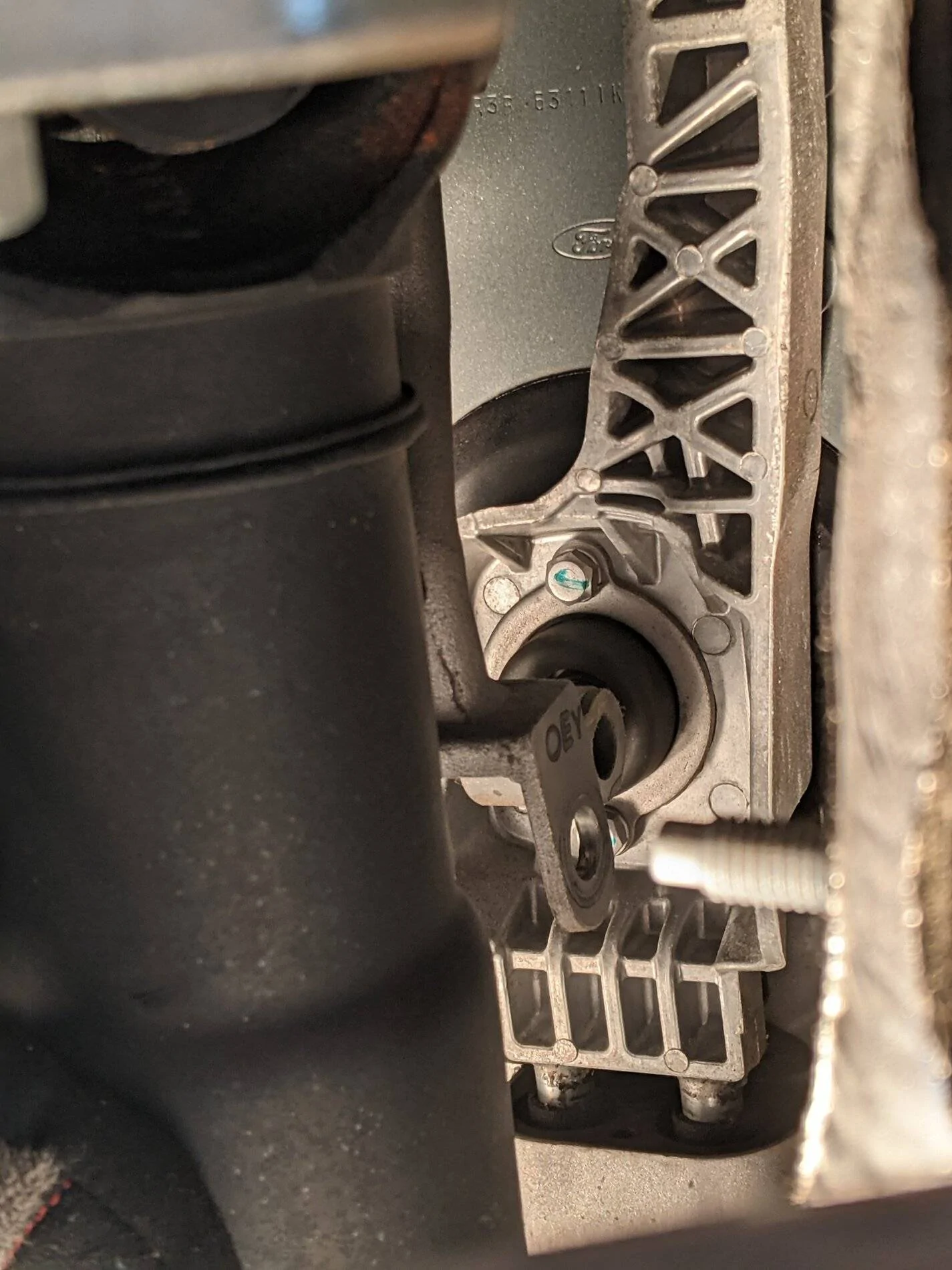

Next is removal of the linkage arm bolt.

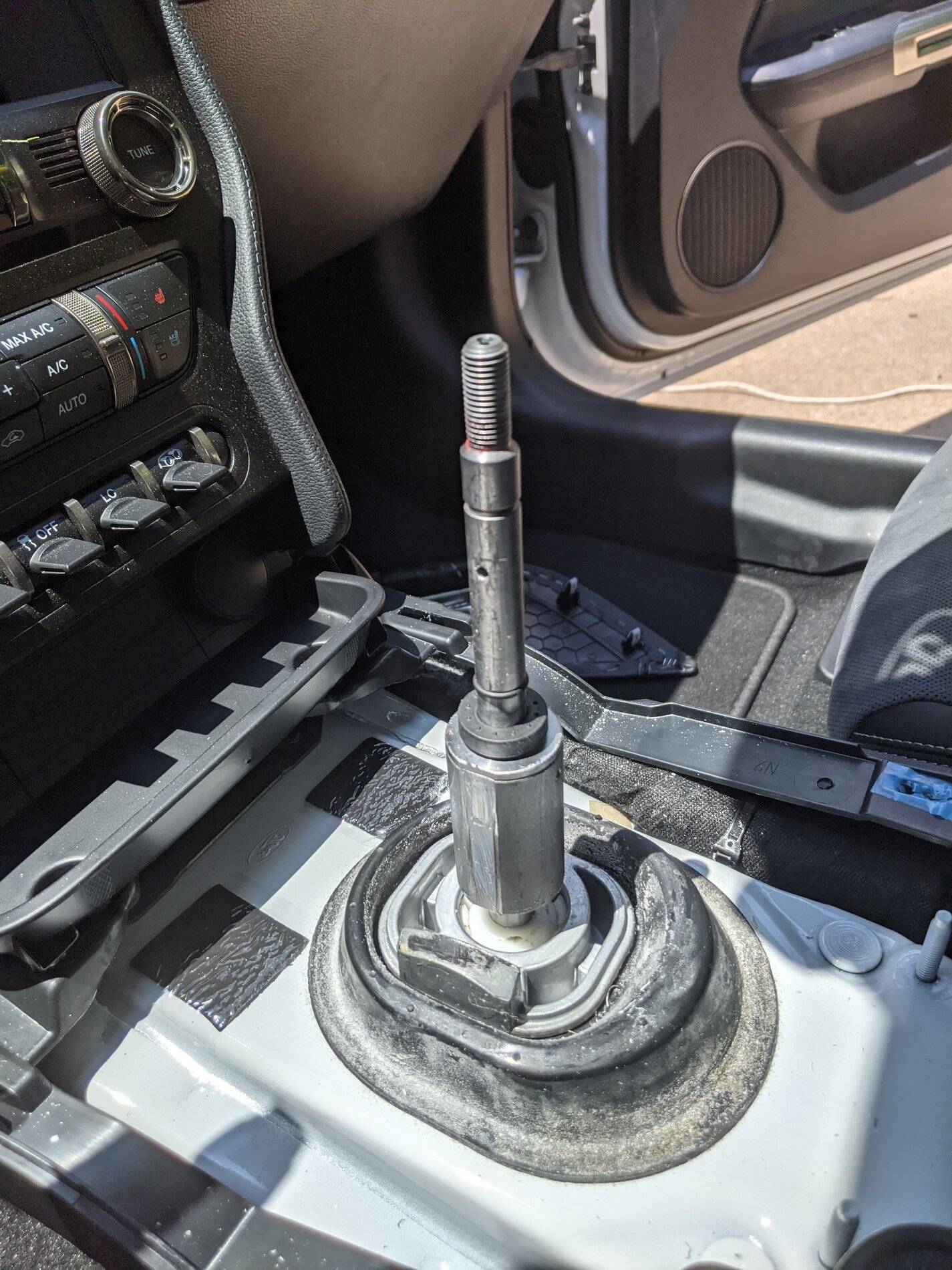

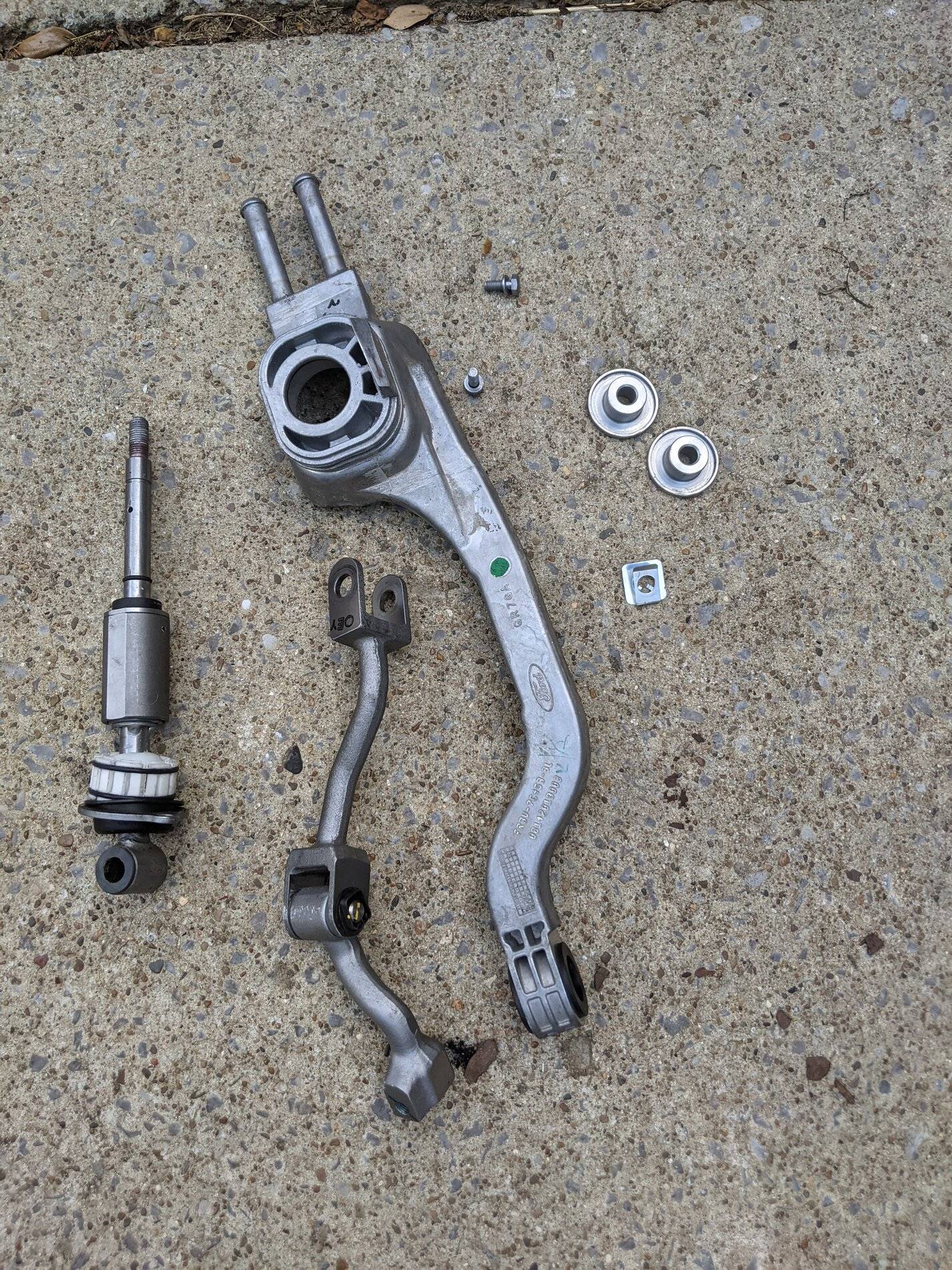

Then it's time to disconnect the center shaft so you can fish the stock shifter out in two pieces, one from below and one from above. Here's the stock shifter out of the car. It certainly looks a lot less beefy than the MGW!

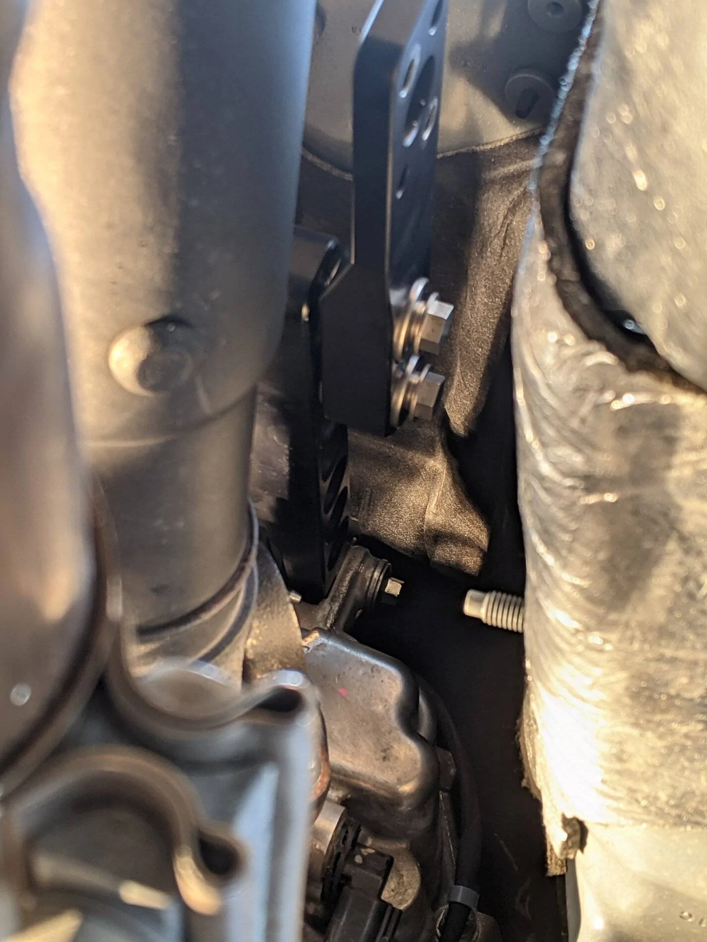

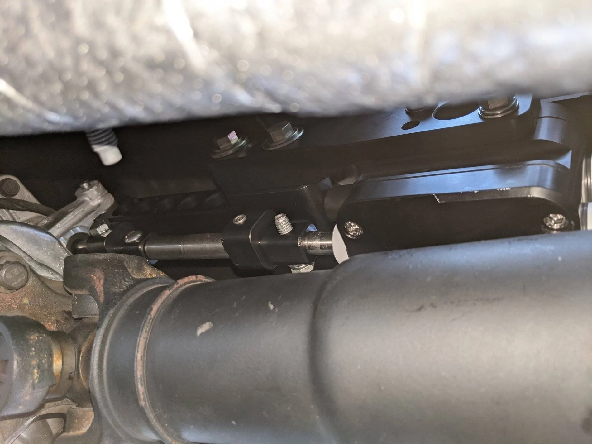

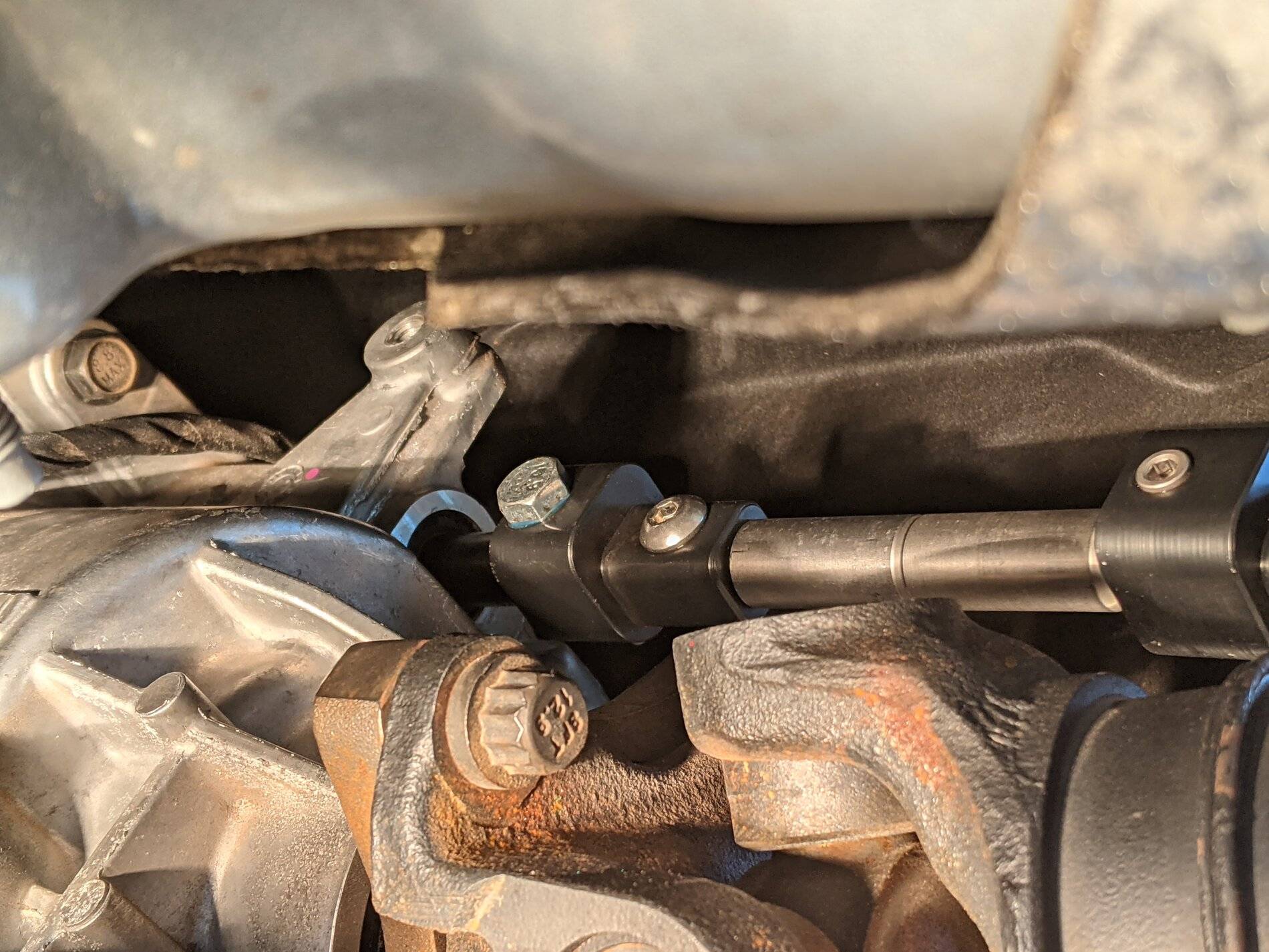

Ok, "out with the old" accomplished, time for "in with the new"! First is installing the MGW linkage. This was the most frustrating step for me, which was surprising as it doesn't seem like it should be. However, it took me FOREVER to be able to get the linkage bolt to engage with the threads and get started. I probably wasted 30+ minutes just cussing this one up one side and down the other as it spun merrily without tightening. However, once it magically managed to grab a couple of threads, all was once again right with the world.

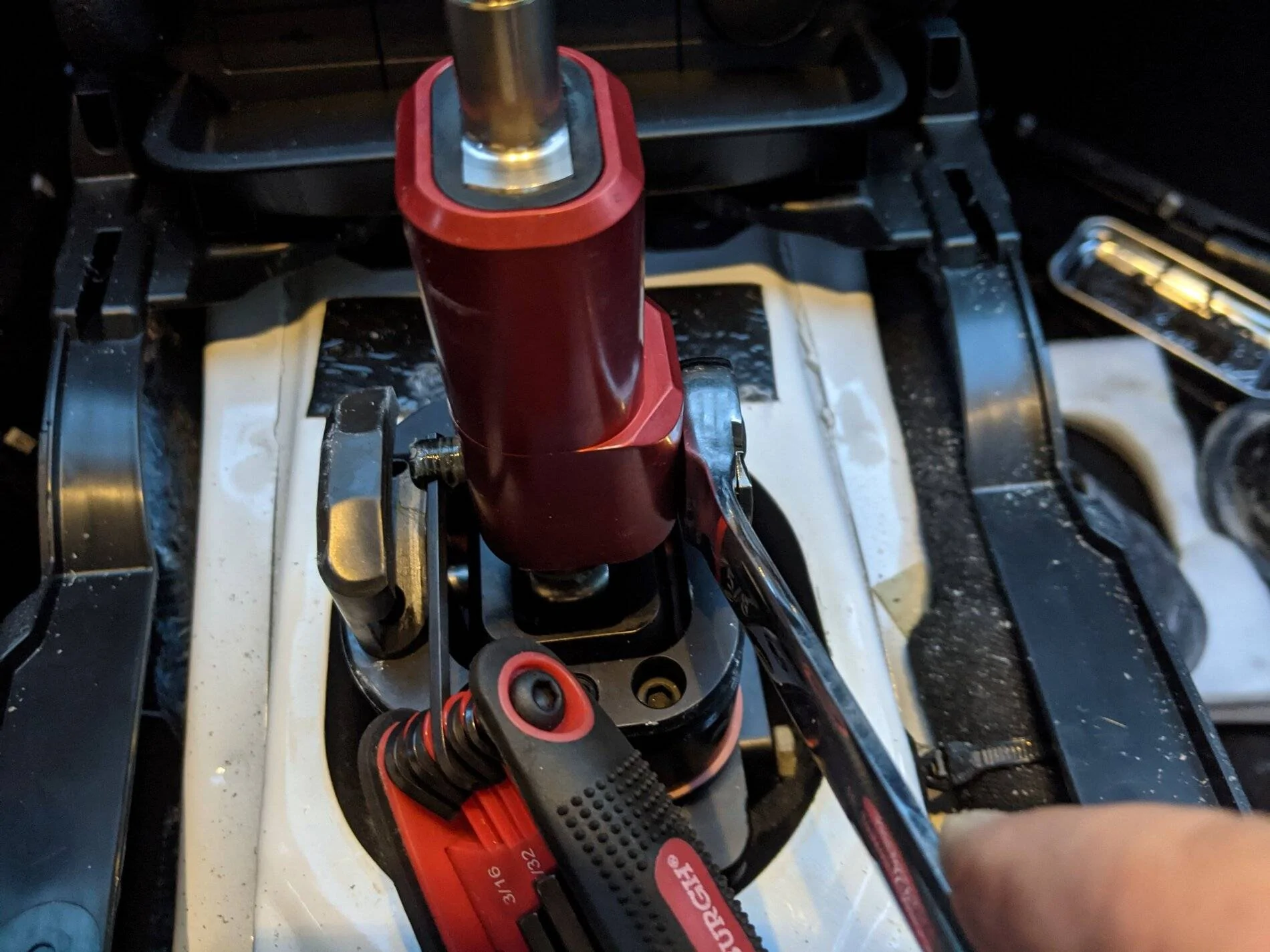

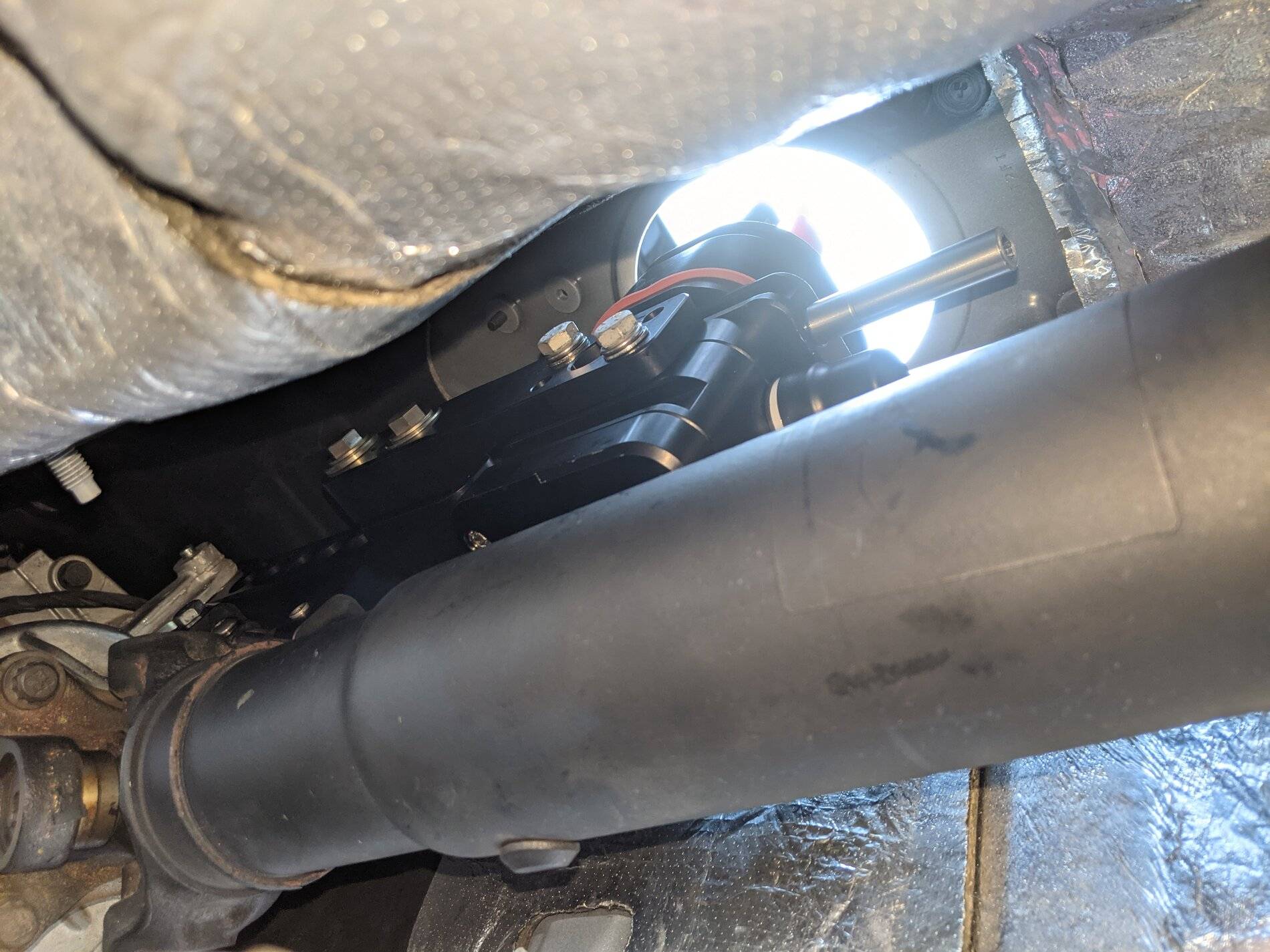

Then drop in the shifter body from the top and install the support pins.
Connect the linkage.

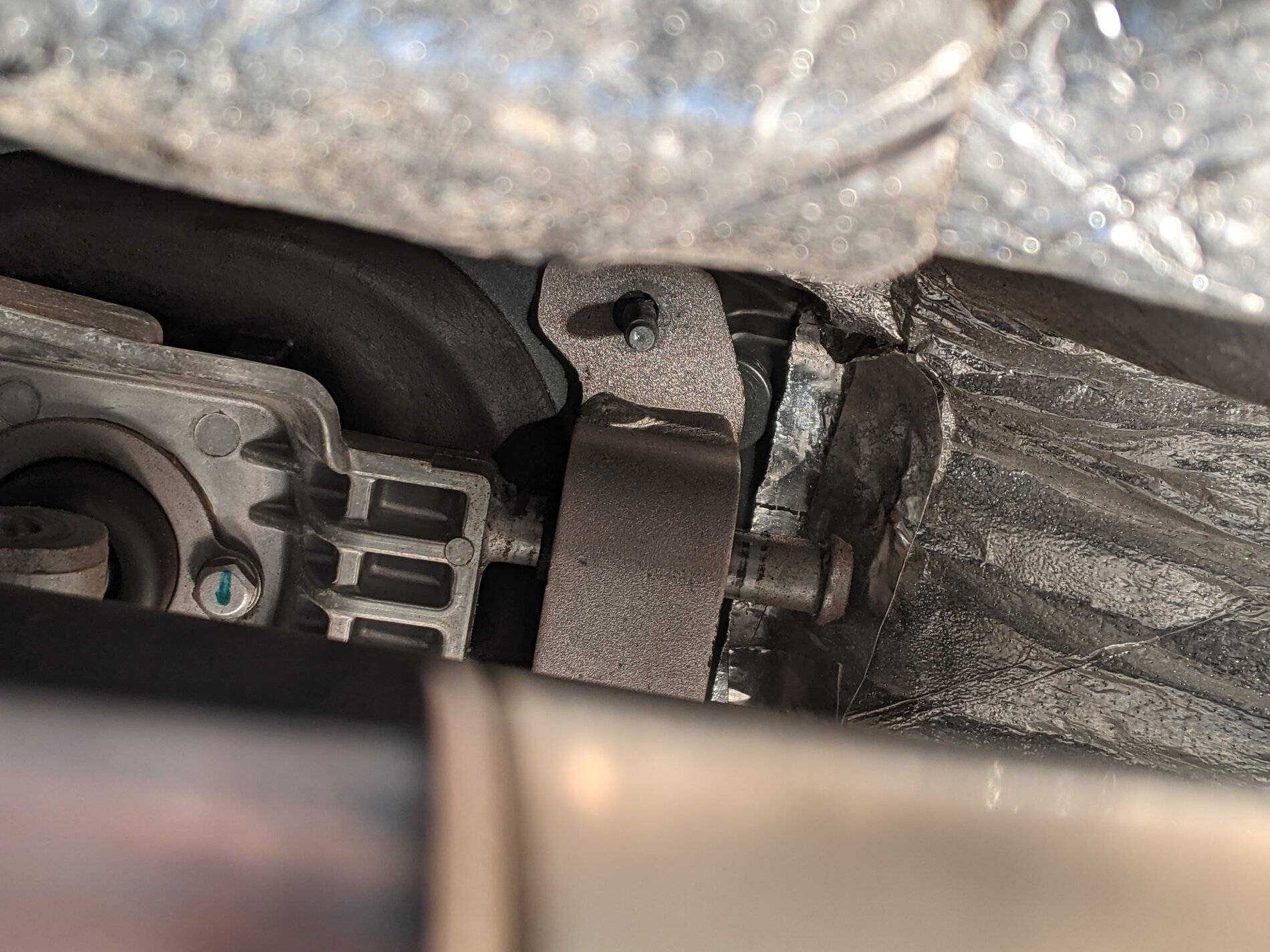

And slip the rear support bracket on.

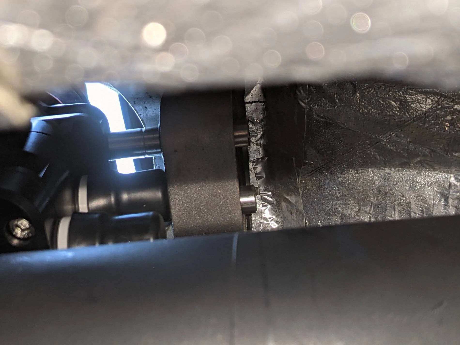

At this point, raise the transmission, bolt the crossmember up (mine went back in the same position, no problem), then install the rear bracket nuts and tighten all the fasteners, apply the MGW-supplied heat barrier, then put the car back on the ground. Dirty part complete!

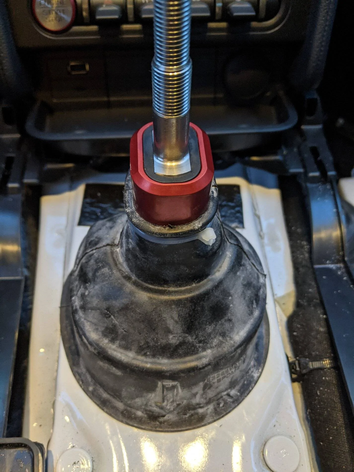

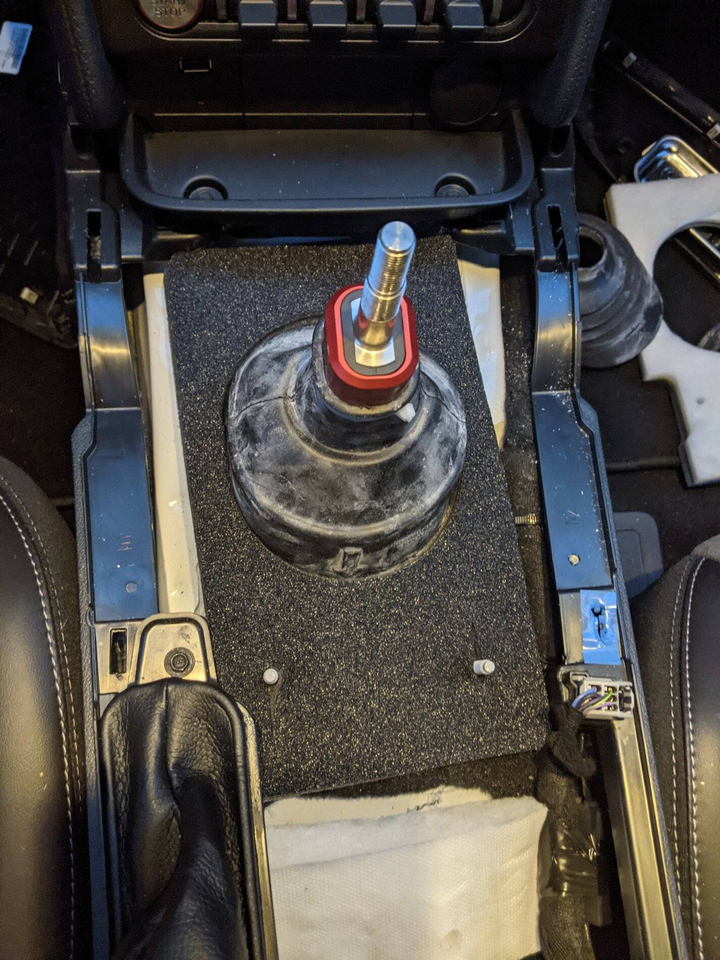

and it's time to start buttoning things up. Put on the dust boot - I stretched it out by hands for a few minutes before installing which made it much easier.
Put on the MGW pad and OEM sound pad.

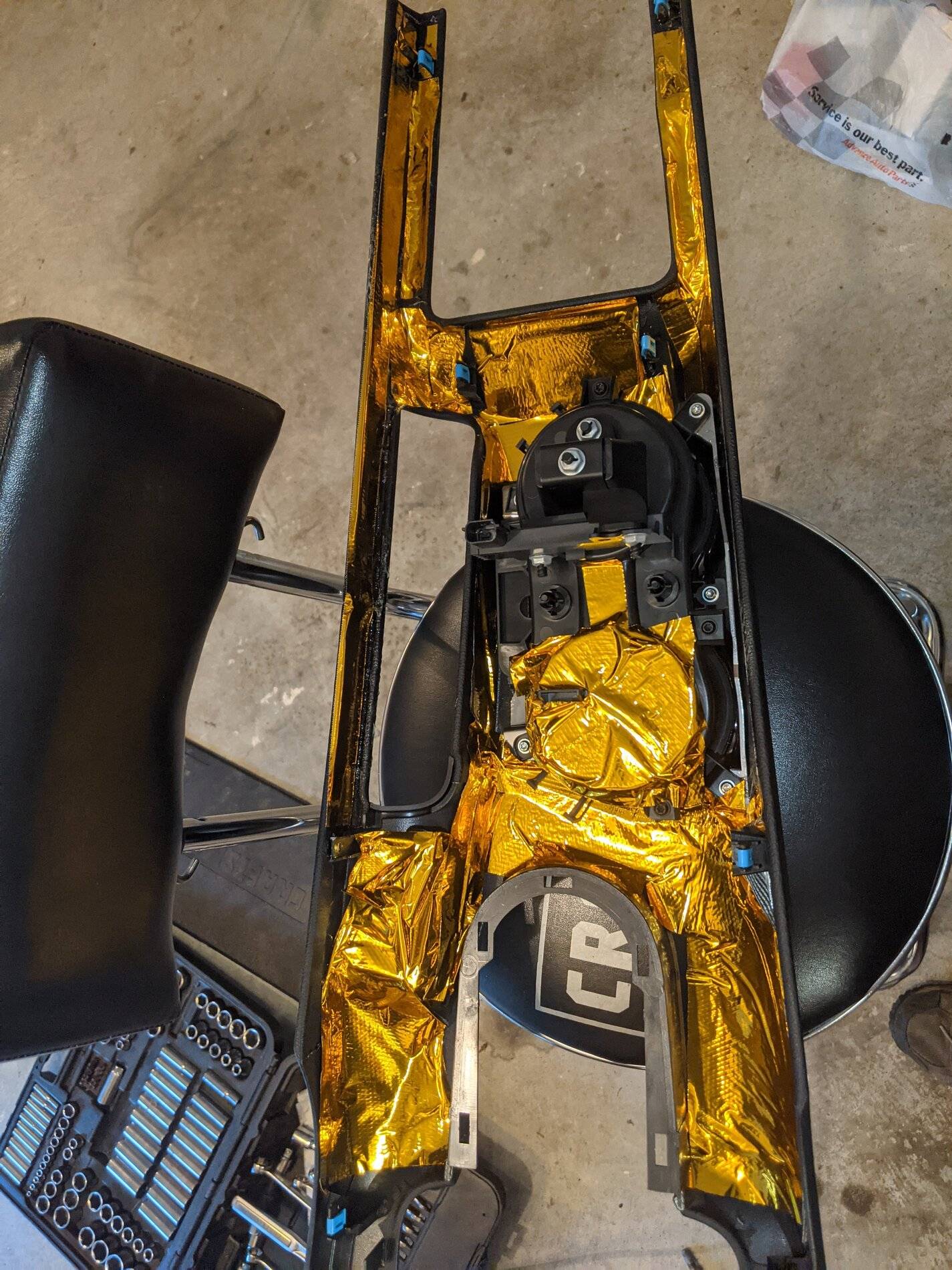

Before the last few steps, a couple of tweaks. First, I decided to line my console with head shielding before putting it back in.
Then in it goes.

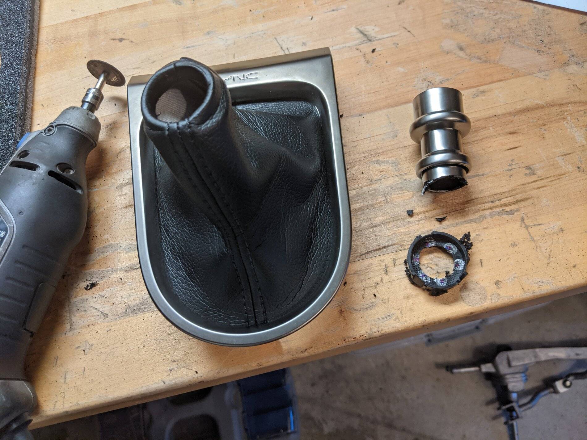

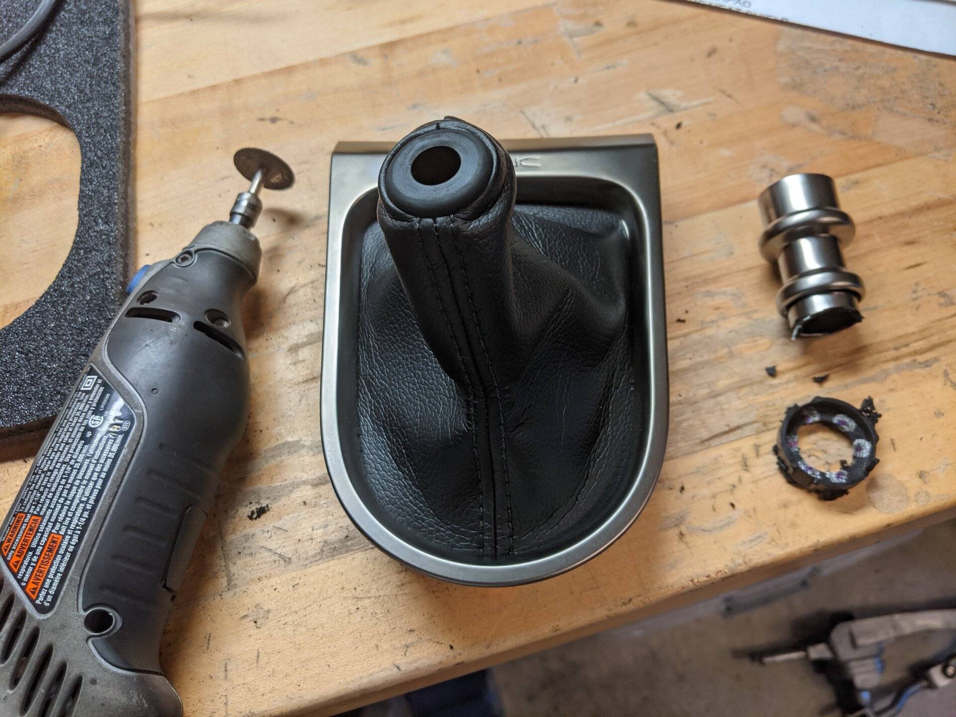

and then you need to remove the reverse lockout piece from the shifter boot and replace with a grommet.

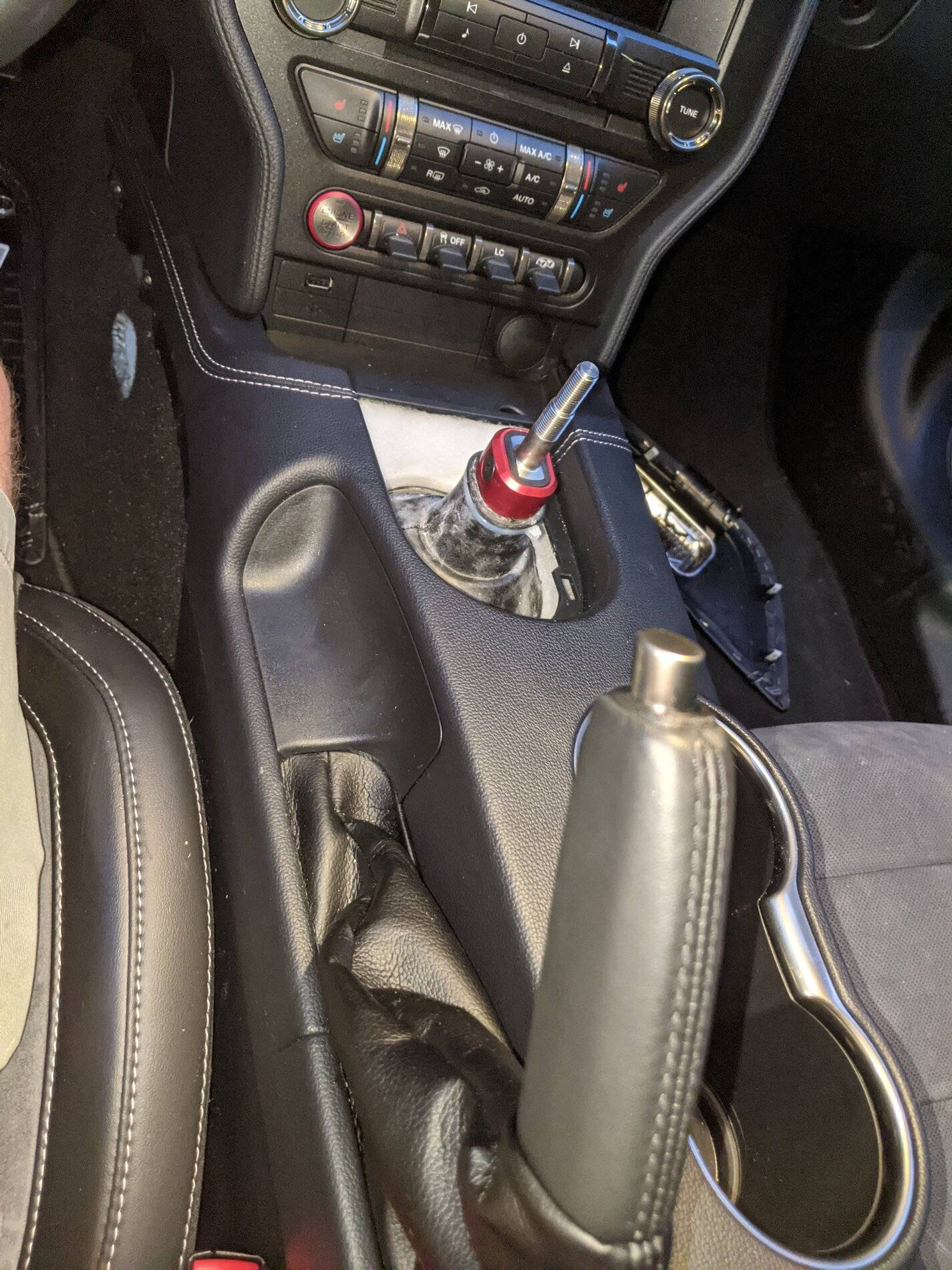

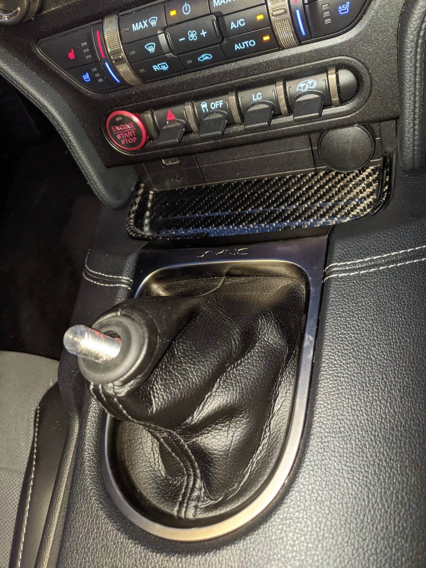

Finally, put the boot back on...

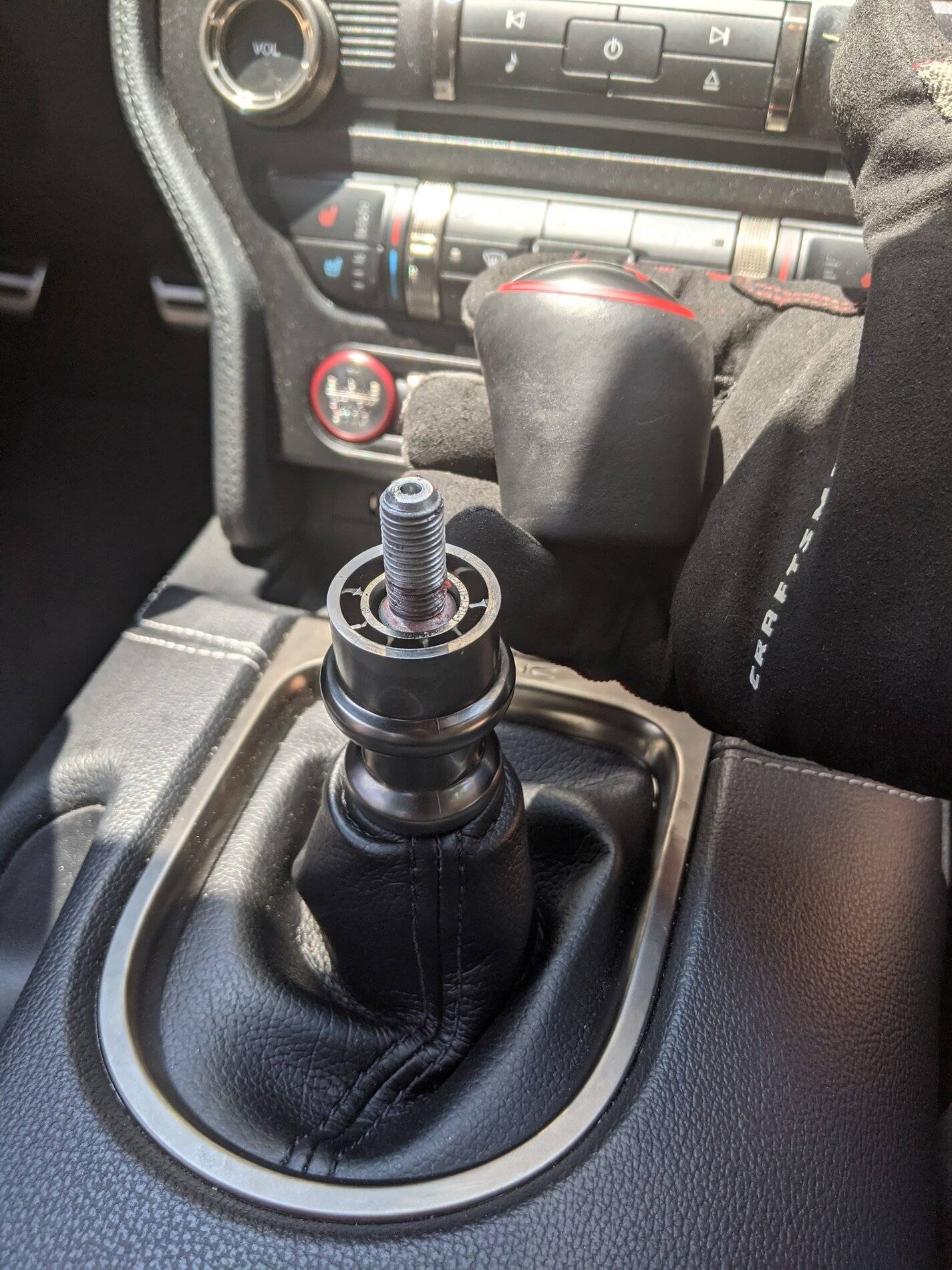

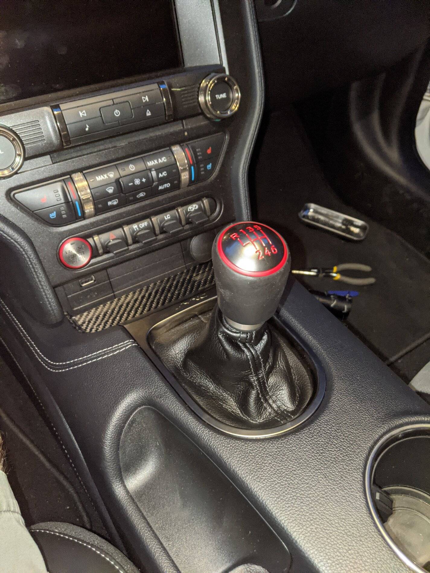

Install the knob, and finished!
Now that I've had some time driving it, throws are shorter, more positive, and MUCH firmer - it definitely takes more force to move the shifter, and especially to get it into reverse. That said, you can really bang into the next gear with confidence.

Nice job. Just a question... it looks like your Jack stands are and different heights, placing the car at an angle. Did you put any blocks behind the rear tires? Looks sketchy from here.

Yes, I have 2 sets of jackstands, and one set is shorter. There are sturdy wheel chocks behind the rear tires. I pushed and shoved on the car before crawling underneath - nice and sturdy. I have no interest in getting a rapid closeup of the underside.

Couldn’t make out the chocks. Glad to hear that. Was worried you were tempting fate. Lol
