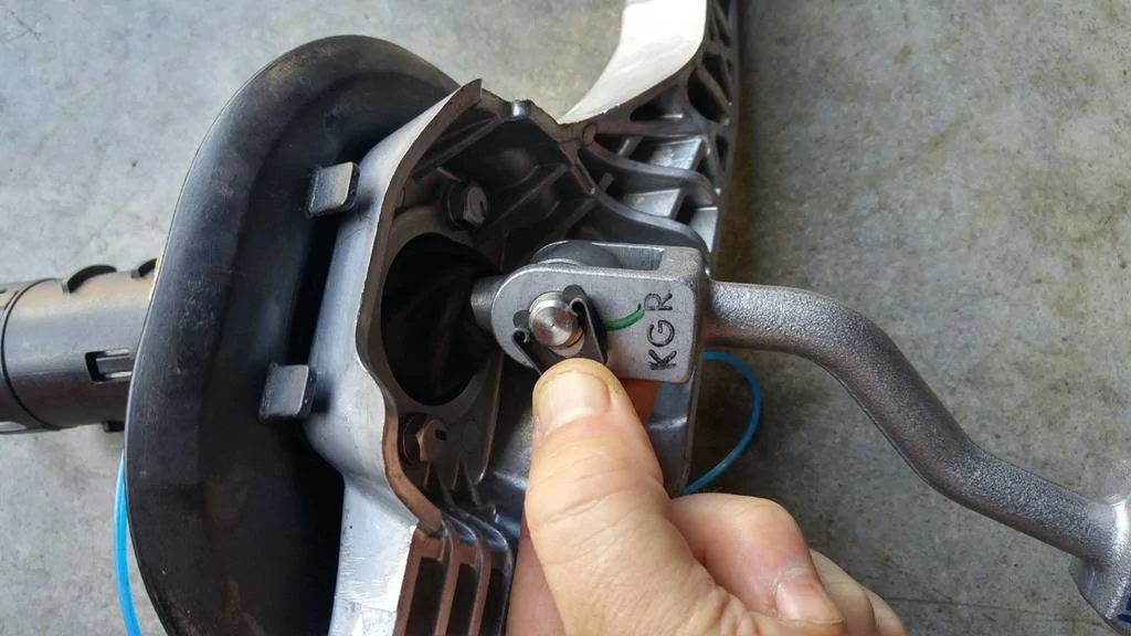

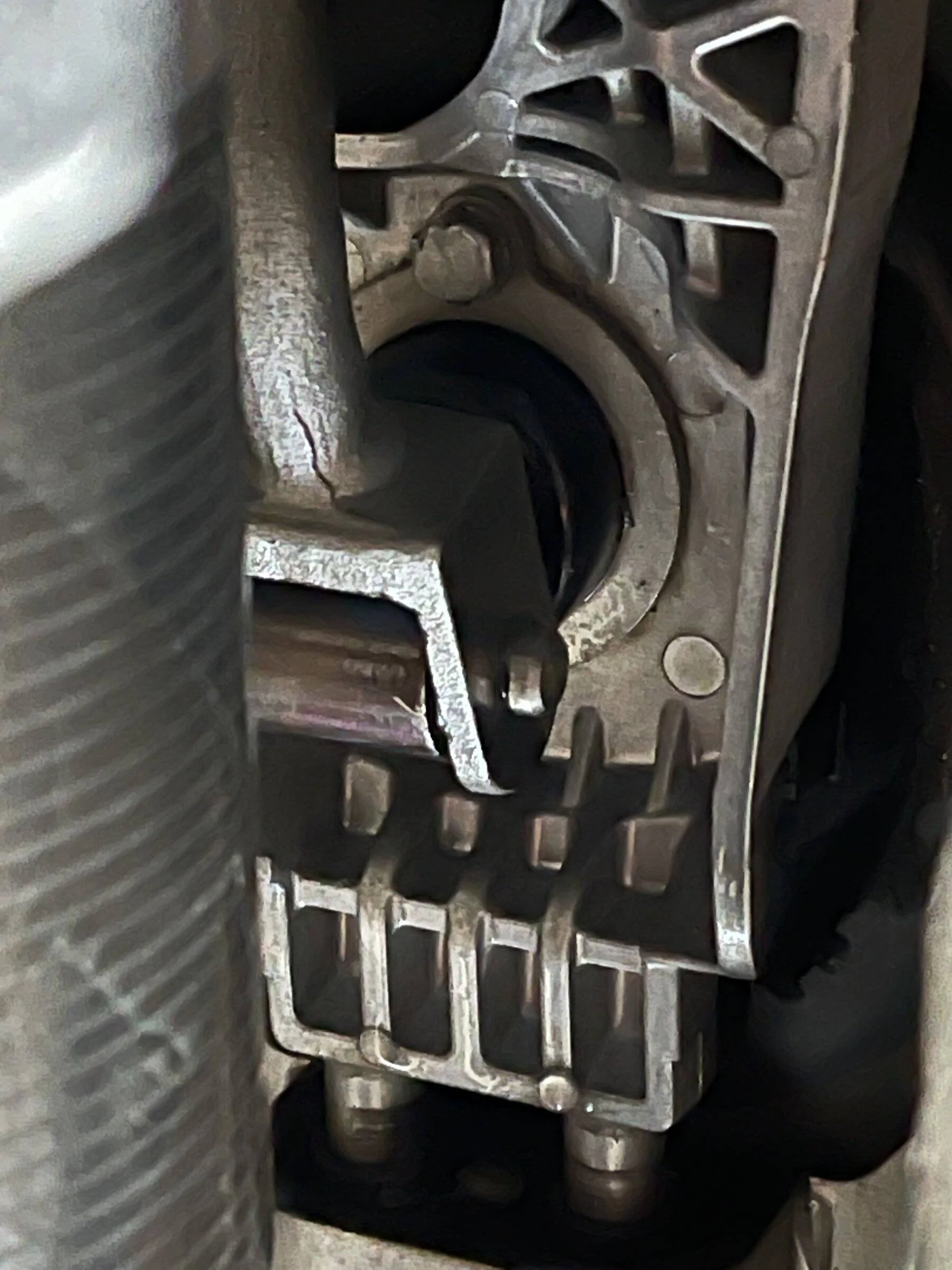

I cannot get this pin to move! Any tips?
Hard to tell in the photo, did you get the clip off of the pin? Flat blade screwdriver or similar to push the black circlip off of the end of the pin. See roughly 3:40 in the video I link in the first post.
Epiphany
Oct 11, 2015
78
7,994
13,665
Global
I like to disassemble things.
If even after the clip is removed and it won't come out it's just seized up a bit. Liquid wrench and a good rap or heat if necessary and it'll bang right out.
Deadly0ne
Dec 7, 2018
122
52
OK, USA
2020 GT350
It’s seized pretty solid.. and all the clips are off. Car was in neutral. No amount of penetrating oil and what little force I could put on it would budge it. Frustrating to be stymied by one stupid pin.
