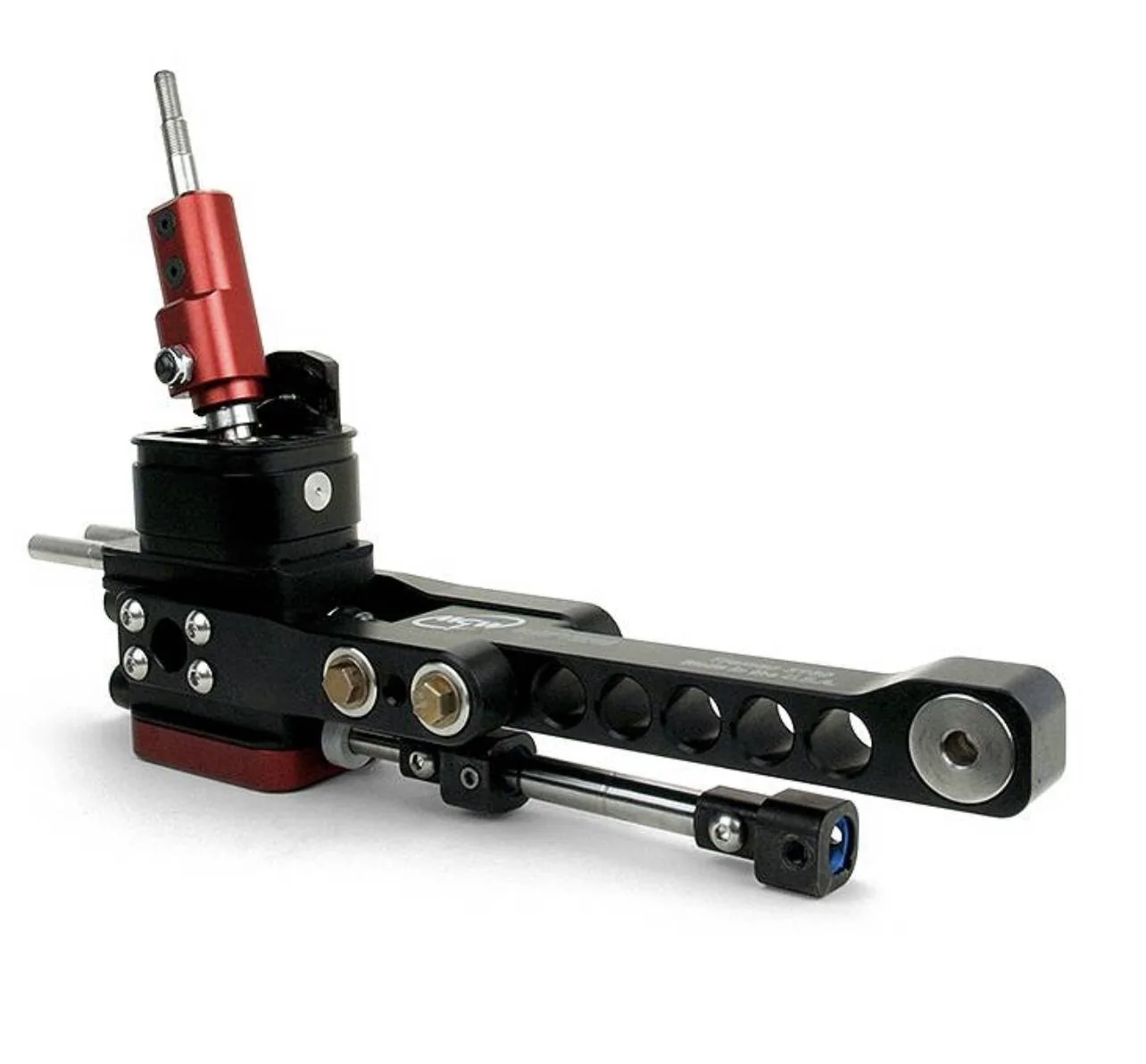

Interesting... who told you the Barton has more “adjustability”? I can tell you that George, himself, has answered many, and all my questions regarding the MGW.
There is a reason MGW has a ton of shifters in 350’s. Here’s a few reasons:
Look at the center backbone and the hardware utilized. MGW has 12, grade-8 bolts attaching the main shifter body to the rigid support arm.
It’s pretty damn robust, and there’s a significant amount of adjustability. I can’t speak for George, but I can tell you that I have witnessed George field calls on his shifters and walk customers though their installs despite the time it took him away from his biz. He’s a true gentleman of a builder. In fact, the man installed his shifter in my R first of all R’s. The shifter, from Ford is good... George made It great!

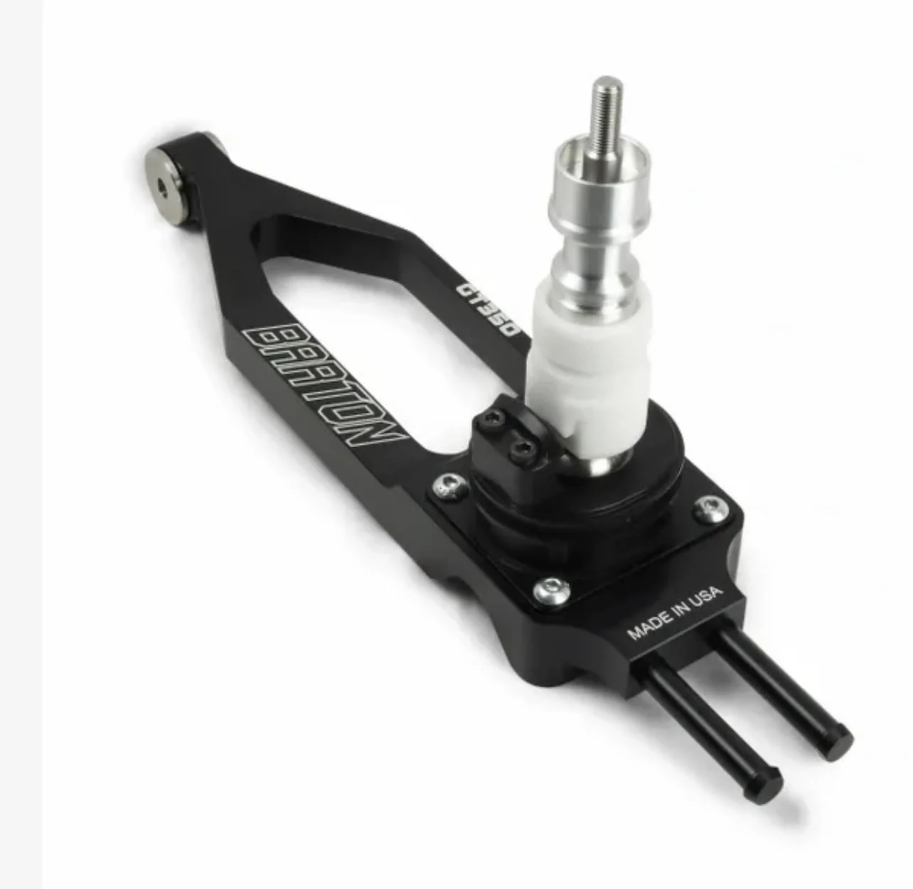

As for Barton, I won’t knock their product... neither will I elevate it on, or above the level of the MGW. Just look at it...
lateral supports, still appears to use nylon extensively, and with less bottom end than the MGW, someone still claims it has “better adjustability”. I can’t honestly say it does or doesn’t, but if I had to go alone on pics, it looks like Mayweather picking on Tyson.
I am not knocking your choice, just intrigued by the claims which appear to be hard to justify by looks alone... yet, I can tell you from experience, the shifter is near bulletproof.

The question is: Why does those "12, grade-8 bolts" matter other than justifying an extra $100? If the feel and durability of them is so slim that its a tossup on which to buy clearly those 12 amazing bolts, are not needed. If anything I'd say the feedback others give on the Barton proves that the MGW's overkill just to justify a higher price..

Insurance, especially given the NVH of the Voodoo powertrain. If you look at the two shifters side-by-side, as I posted above, you can see right off the bat that the MGW is a more robust appearing unit.
If you’re putzing around town and the occasional back twisties, then the Barton will likely do just fine, as well as the stock shifter, and even then how can you justify $380? I am not sure what prompted @wingnutt to purchase a Barton, but he felt comfortable in doing so. I just wanted to know about the claim of more “adjustability”.
Bear in mind, both the stock shifter and the Barton have a considerable amount of nylon. It costs to replace nylon with durability and reliability. And as a professional who relies on people in the aersopace industry to do my job, I can deal with $100 for assurance... and, that’s my opinion.

In a nutshell, the Barton GT350 shifter and the MGW GT350 shifter are completely different animals. Barton uses the factory shifter "pendulum" desgin whereas MGW engineered a twin pivot bolt-action design. The MGW is far more hardware intensive beyond mere bolt count. I've posted plenty on all of this in the past so a simple search should provide plenty of reading on the matter.
