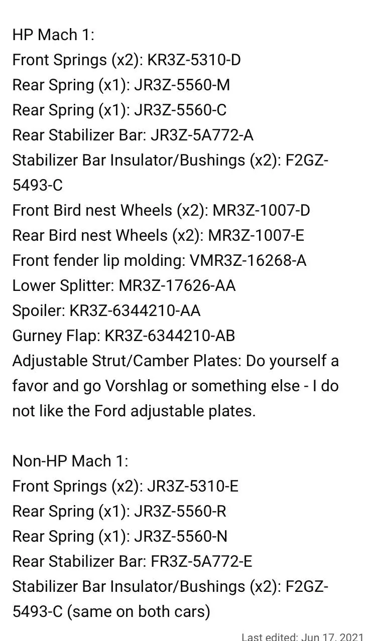

I just ordered the rest of the handling package Mach one components to add to my 2023 non-handling package Mach one, I purchased the front and rear springs the adjustable camber plates, and the rear swaybar. I used the parts numbers that I have listed below,
I provided the parts guy with both a non-handling package Vin number and the handling package Vin number and he told me that these parts are not a fit for either,
Given my endless research on this form, as well as Posts I went ahead and ordered the parts regardless,
Can anybody confirm that these are indeed the part numbers that they ordered for their handling package conversion?

I can confirm the front and rear springs from your list.
Those are the only HP parts I've ordered/installed.

Which part numbers for the springs did you order? If you don’t mind me asking, just to confirm we’re on the same page,

Got it. Thanks. I had read several places where the magneride tuning was different for the hp cars. Good to know that it’s not. I order the following parts:
KR3Z-5310-D - front springs
JR3Z-5560-M - RR Spring
JR3Z-5560-C - LR Spring
