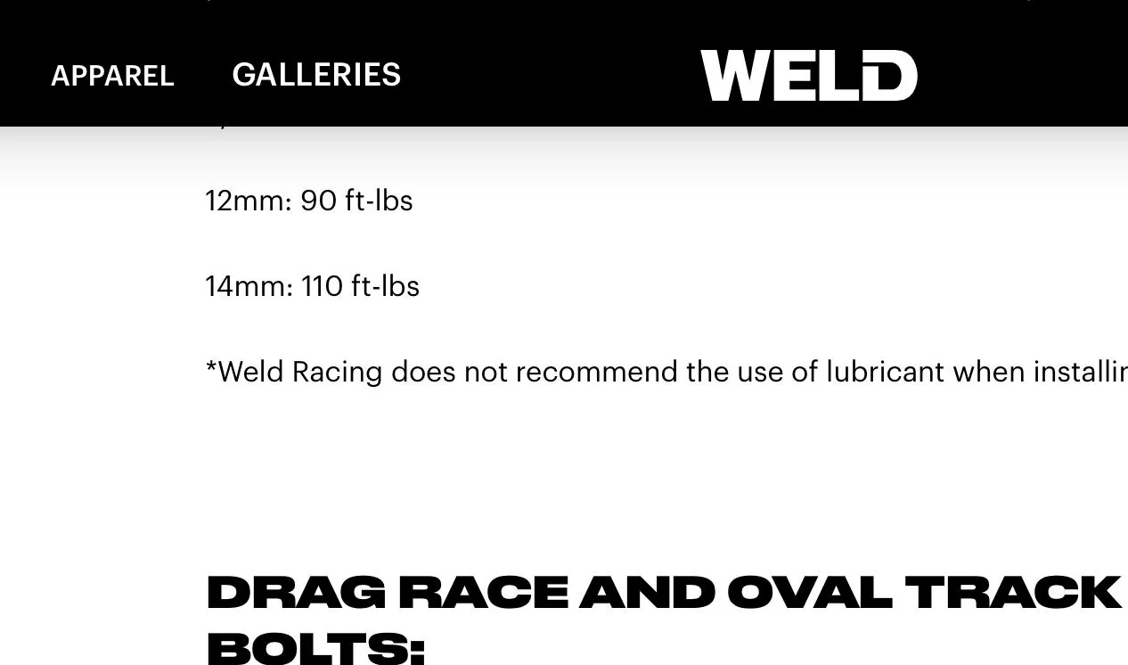

Some wheel manufacturers will suggest other torque values for their wheels as well
robvas
Nov 18, 2023
3,804
3,598
MI
2011 GT
I don't understand why people are so dead set against torquing lug nuts to what Ford specifies. It's not like it's difficult to just do what the manufacturer says it needs.
A lot of people change parts on their cars or do other things Ford doesn't specify.

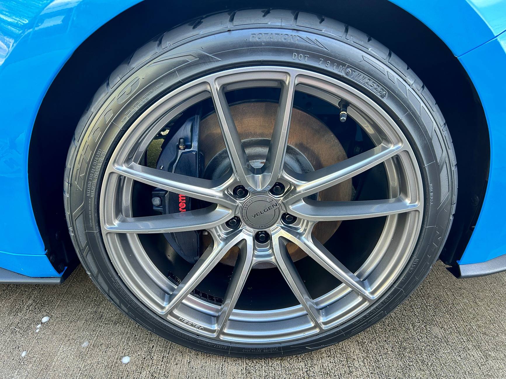

When I asked It was recommended to me to torque my Velgen wheels to 110 Ft.lbs I haven't received them yet and I'm on the fence on what I should actually torque them to. I will also be using Gorilla lugs
I torqued my Vegen on my 22 GT to 150 just like Ford says. No issues at all.
