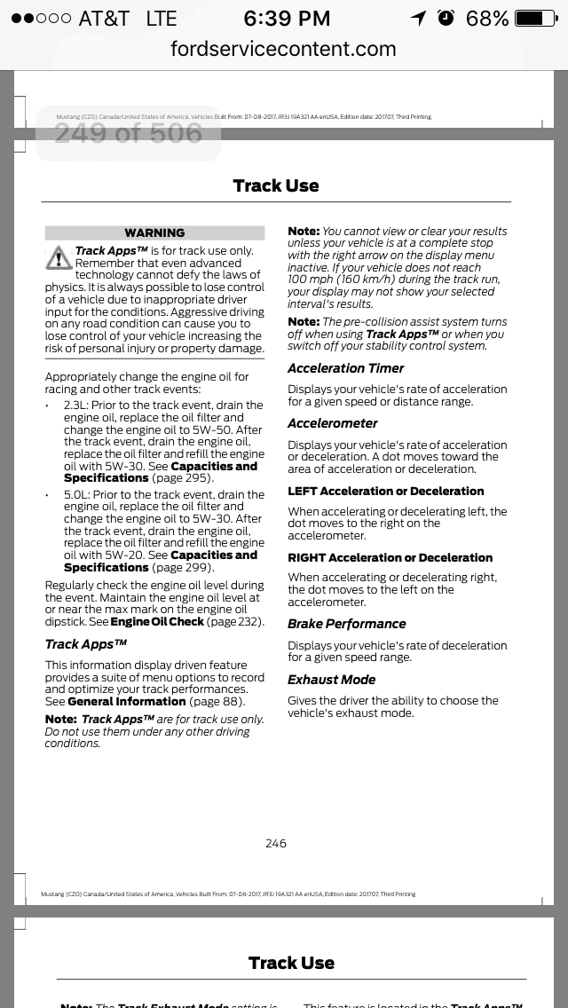

I have an '18. Its in my manual. Dunno if a '19's manual wording was changed since I don't have it to reference. I'd have to open mine again to tell you the exact page, I don't remember it, but I do remember the wording well. When I get time, I'll give it a look to try and find the exact page, but it was a reference that included changing oil to 5W50 for track days, then draining and replacing with 5W20 afterwards for daily street usage. Most drag racers in the know use either 5W40 or 5W50 (which Roush and Whipple do suggest, but well after it was made common by plain ole mechanics in the know) even in n/a cars. I use full syn. Rotella T6 because its also a Euro spec diesel grade which has additives that extends its life and is helpful in also dealing with the extra acidity that comes from using ethanol as a primary fuel (E85) as well as diesel fuel. I believe the extra additives are Sulphur which helps negate the extra acidity.
My '18 manual says 5w/30 for track days for the 5.0 (page 246).

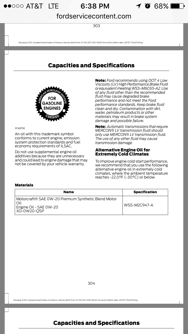

I think there must be some confusion here between the 5.0 and the 2.3. I've read my owner's manual from cover to cover. For the 5.0, it recommends 5w/20. For track use, switch to 5w/30, but switch back to 5w/20 afterwards (p. 246). You can also use 0w/20 for extremely cold climates (p. 304). I see no mention anywhere else for anything different.
