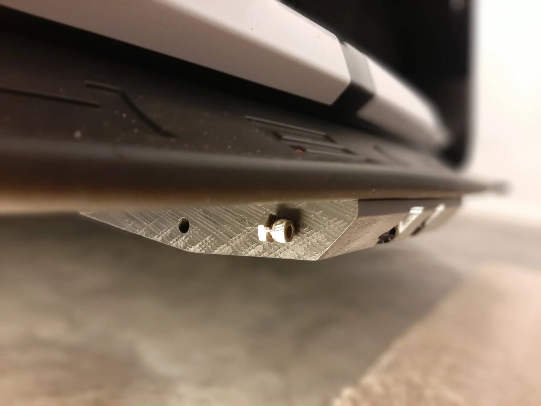

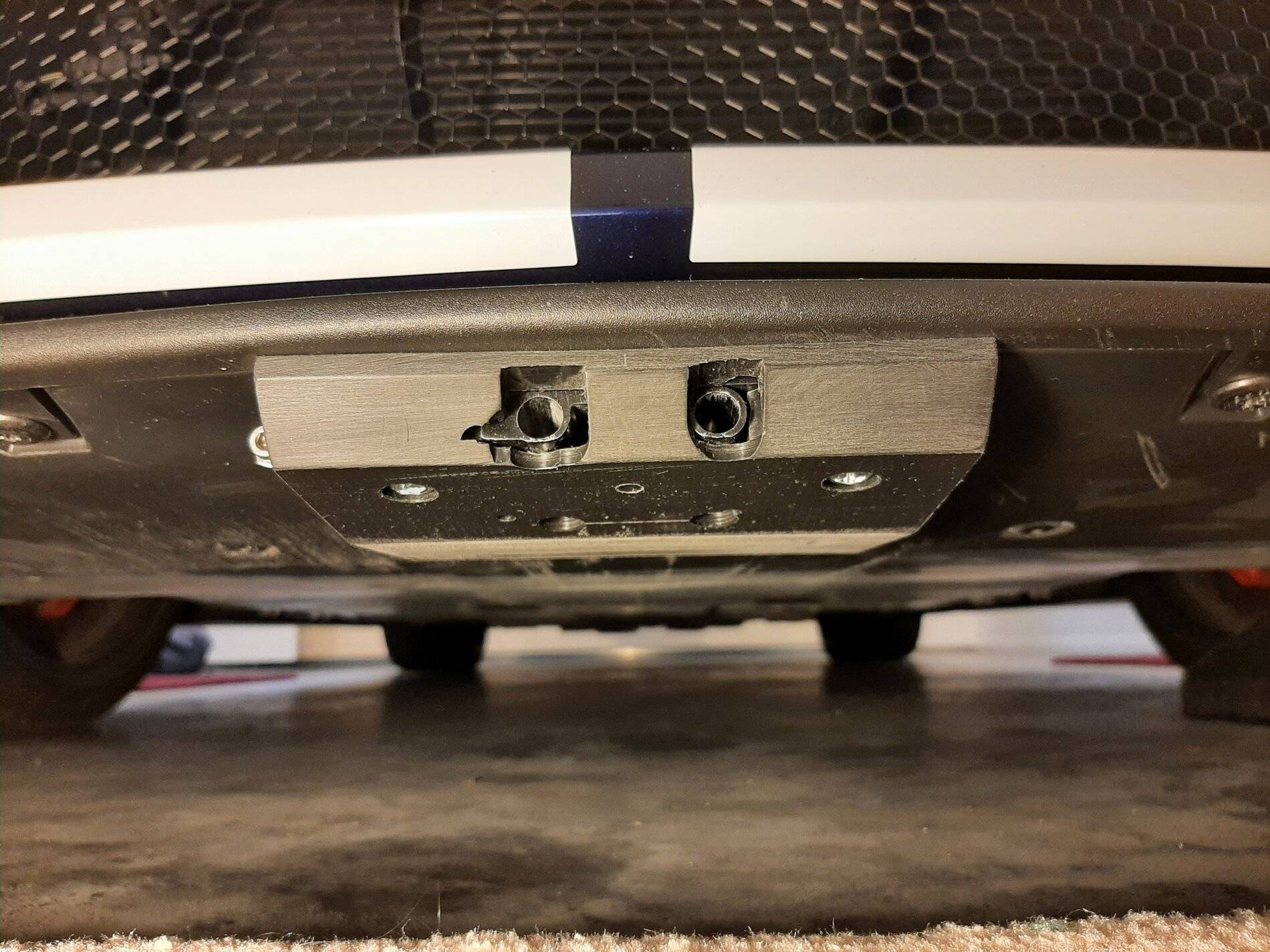

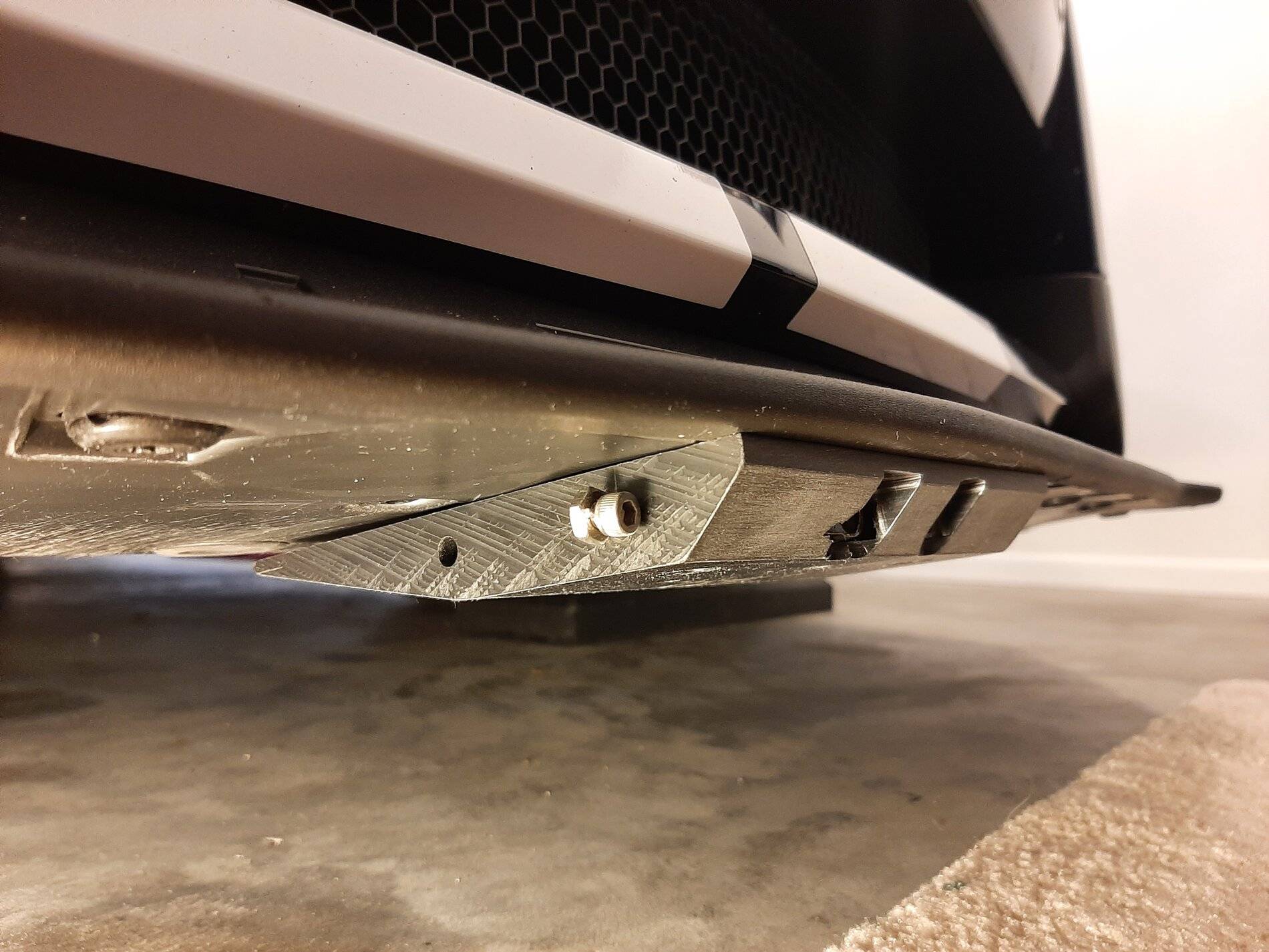

I added an abs skid plate to protect my sho n sto plate bracket. Made out of a 6x6x3/4" abs block. Its sort of like a super slip low and is held on by the 2 splitter bolts. It takes lots of abuse.
