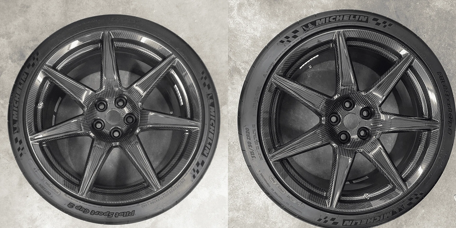

Got the first of two coats of ceramic on the wheels this morning and I have to say, the hype regarding the alleged "difficulty" is just that. After too many toob clips on the subject, I was concerned about high spots and letting it sit too long.
Neither turned out to be an issue AT all. At least this Gyeon Rim ceramic was pretty darn easy to apply. Tedious, yes, and to me it felt like a greasy wax when removing. But, short of simply missing a spot with your buffing towel, I can't see how you could create one of these "high spots."
I'll put the second coat on in the morning and then do the calipers and hats.
So for any ceramic newbies worried about the difficulty of application...don't. Get the surface as clean as possible and go for it.
Probably can't see it well enough in this Before & After image, but it's definitely noticeable visually.

Hey Kent , nice job. Is one 30ml bottle enough for 4 wheels? Where did you buy it from?

Thanks, David and yes, it is more than enough.

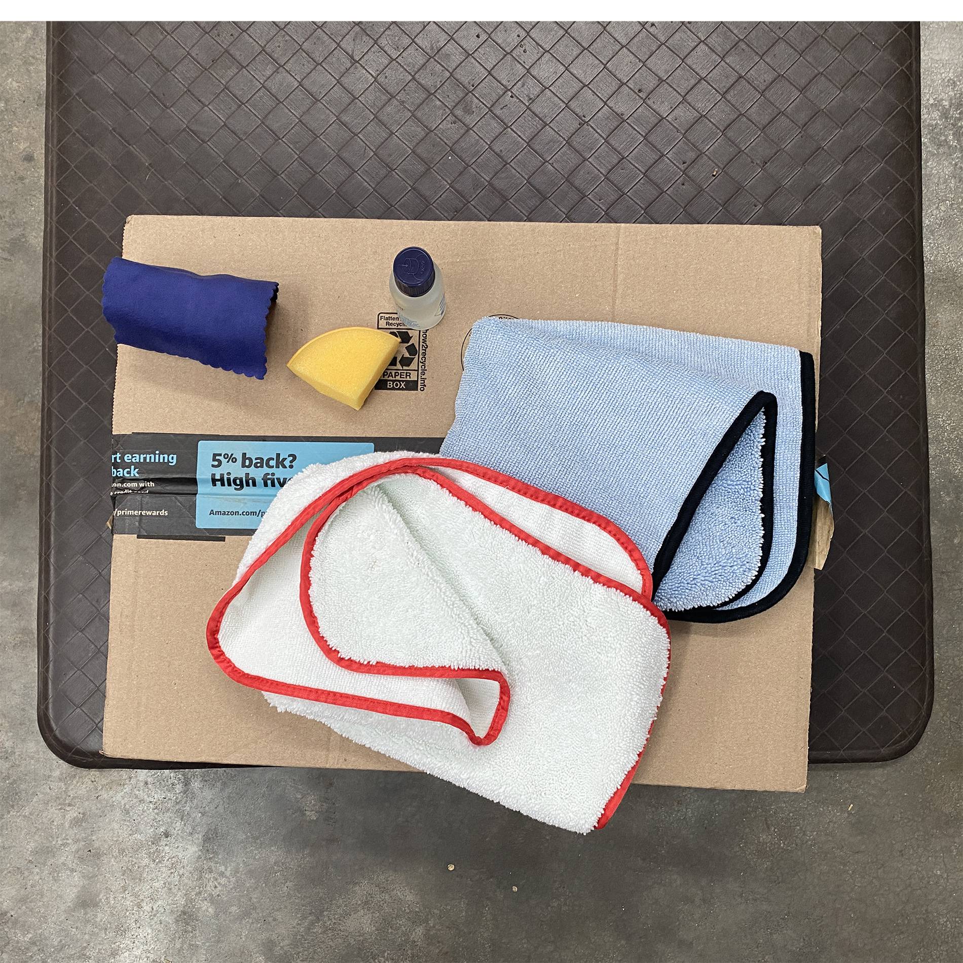

Got the stuff at Kamazonski, amigo. Fifty bones for the kit but I did order a pack of those cloth-coated sponge bars for application. The kit comes with a firm, flat-edge sponge which might be OK for large body panels but for rims, you need curves. I also picked up some additional suede cloths to wrap around the sponge thingies.
Picked up another tip from the Toob which was to cut up some Meguiar's sponge applicators into quarters for close in "corner" and circular type work. It's a good tip and excellent for the nooks and crannies of wheels.

Two things to mention. Always wear gloves when doing this. Most kits contain them. You do t want your natural oils interfering with your hard work. I use the Adam’s ufo applicators on paint and their suede rectangular applicators for wheels.

The biggest bummer for me though is realizing that I have to throw SO many of my precious MF towels away once they've come in contact with the ceramic. (Didn't want to use the cheapo MF "rags.")
But, better to go with the theme "Cleanliness is next to Godliness" on this car as once that stuff hardens, it could really do some damage to clear. Plus, towels can be replaced. Threw eight away yesterday and I'll be pitching another eight today. Lord knows how many will bite the dust after a full vehicle coating...Shice! I think I better get some more, now. <laughing>

When I went out to get started this morning, I saw that I had less liquid remaining than I thought. PROBABLY could have put a second coat on the wheels but then, I would not have had enough for the calipers. So, decided to just do the latter and worry about another coat down the road.

Final Update: As it turned out David, 30ml was JUST enough for these four wheels and the calipers but I used every last drop. Reminds me of an old coffee commercial...Maxwell House I think?
But David, I got to thinking, (big mistake, I know,) and realized that 30ml would NOT have been enough for wheels and calipers on rims other than these with the "heat resistant" coating on the barrels of the fronts that did not receive the ceramic. Fact is, 30ml probably isn't enough to do the Base wheels alone, forget about the calipers.
However, I would think two 30ml bottles would double coat the wheels and maybe even a double coat on the calipers. Depends on how obsessive you get about stretching the liquid. I discarded my little sponge quarters and MF towels after every two wheels and every two calipers so I did pitch a fair amount of the liquid in the old applicators.
I'll be washing her again in the next few days so I'll report back on the hydrophobic qualities of the Gyeon Rim goop.
