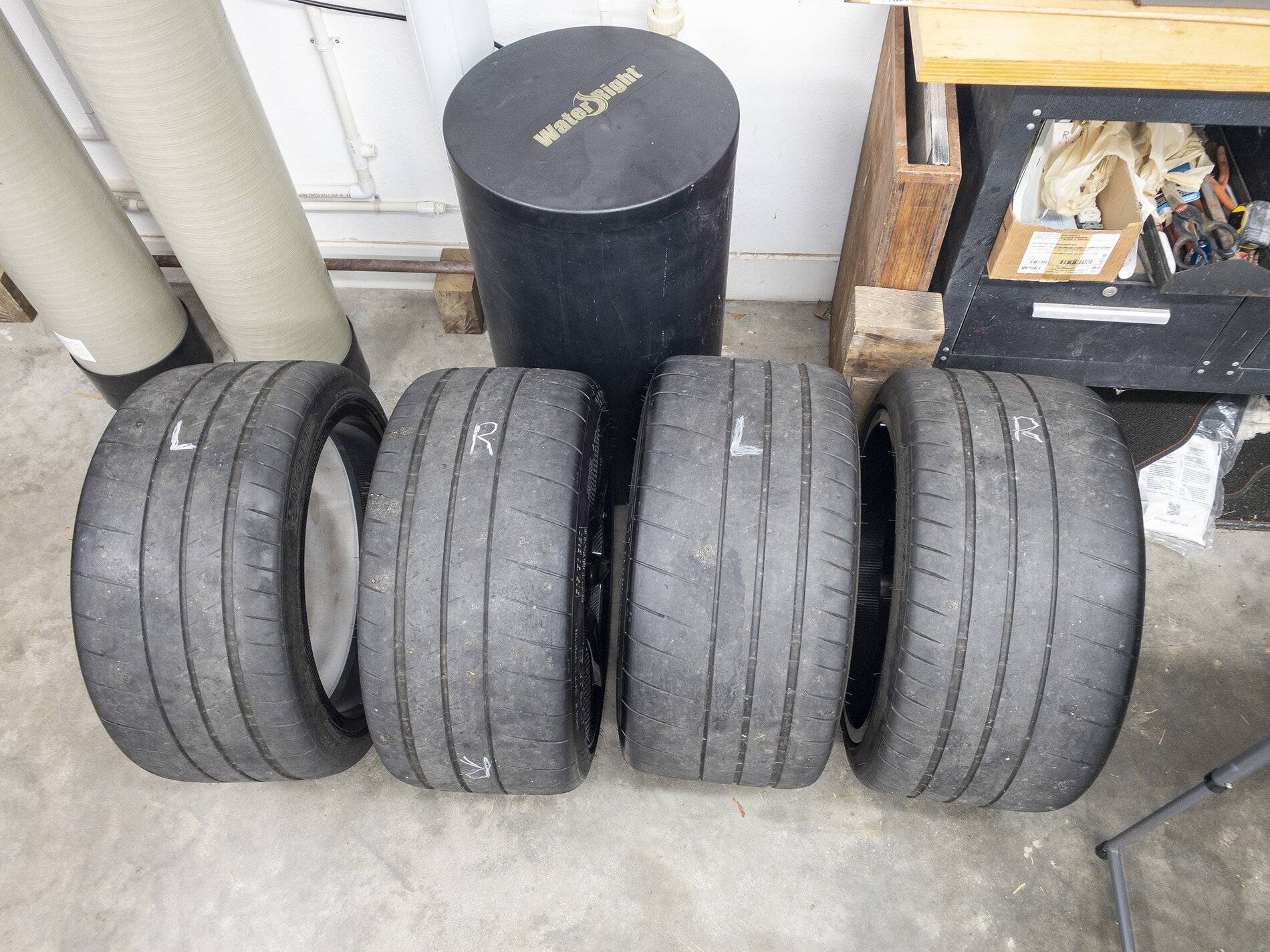

The Tar Question...
I thought PSC2's were not directional and I double checked that with Mr. G. Seems that is the case but no one seems to know why then is the outer tread reversed on some? What I found is that apparently, they aren't even sold in pairs.
Is any of that true my friends and experts?
These are how my tires were from the factory.
Right? Wrong? Doesn't Matter?

I too wondered on several tires, that are NOT directional, then one side the channels would be the opposite of others.....SURELY one way is better for water so it has to be a compromise, or maybe on monster meats that shouldn't be seeing rain they just don't care enough to make L & R.

Doesn’t matter. The Pilot Sport Cup 2 is not directional, it is only asymmetrical (different tread on the outboard and inboard sides).

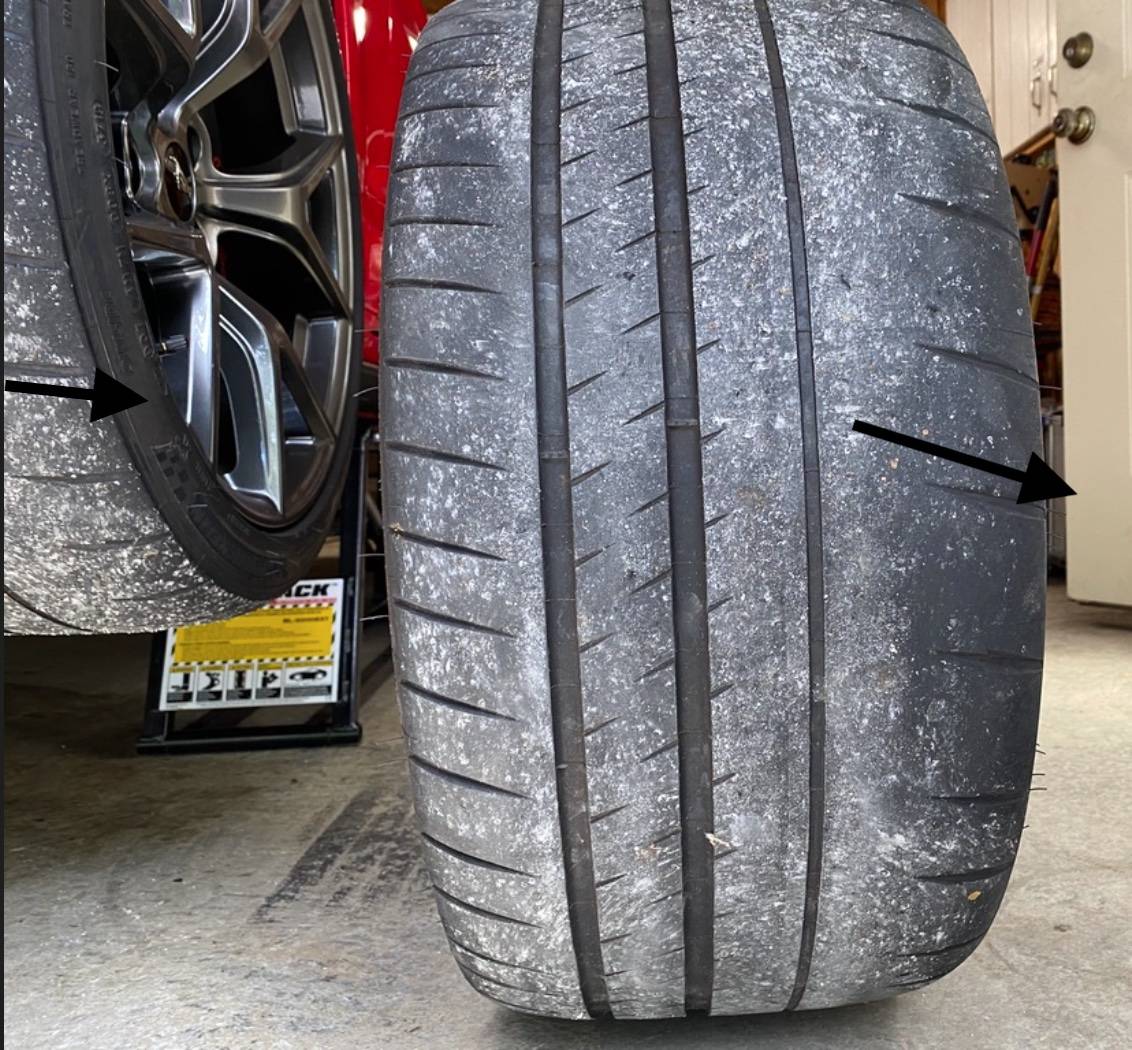

Tire rotation being L&R swap front & rear. Are you thinking the pattern will be reversed? And the tire will look like it is running backwards.
I had the same idea, if I'm reading your question correctly. Wanting to see a visual, removed PS tire rolled over to the DR side and snapped a picture.
As you can see the pattern remained the same

I get that they are identical tires, Tom but my question was why the outer tread is designed the way it is making them the same PER side but reversed side TO side. Surely an all-knowing, all-seeing Air Force type would know why, right?

Because they don't want to have two seperate molds and have each tire made per side I suppose Kent?
