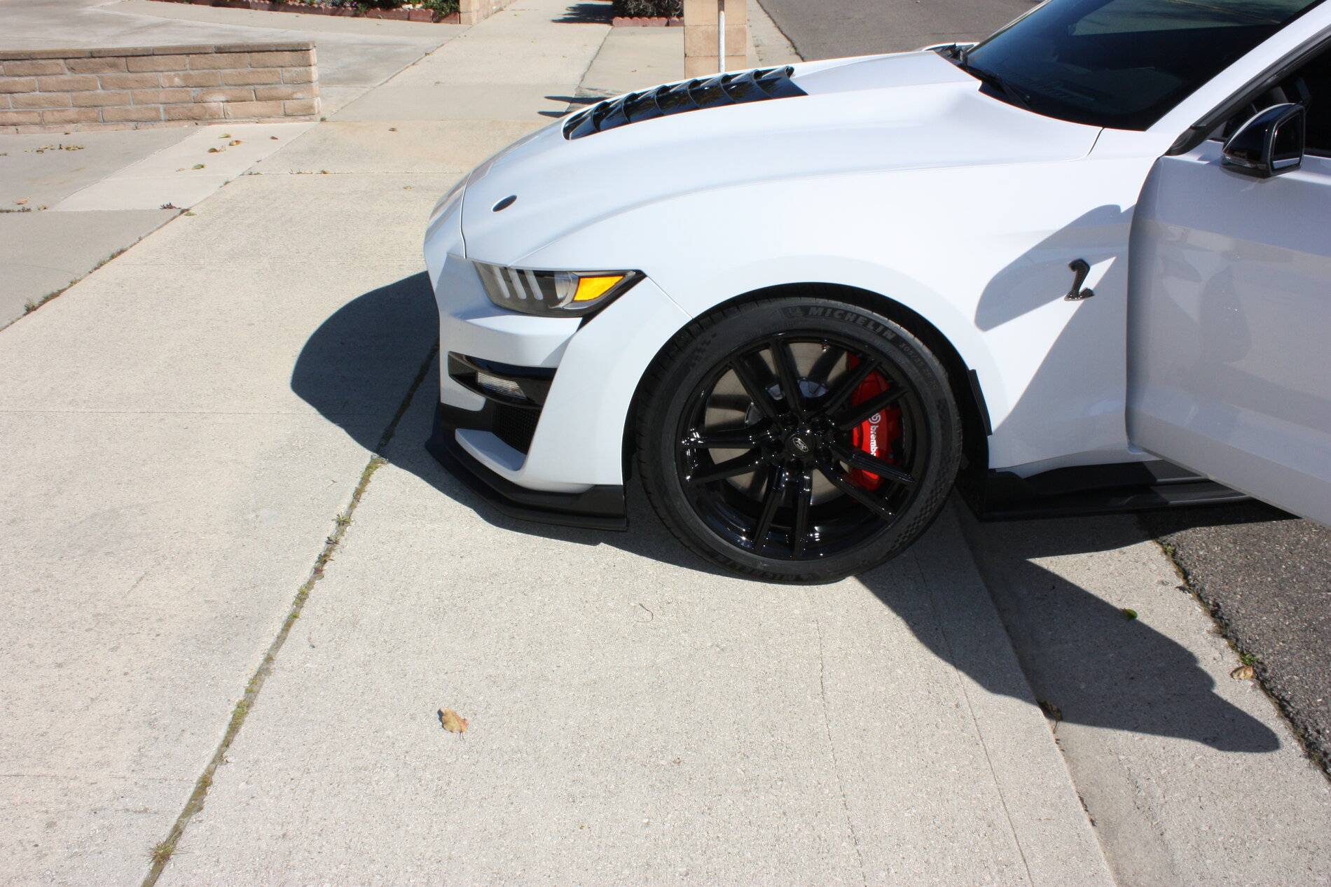

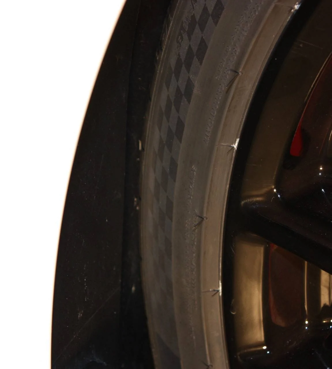

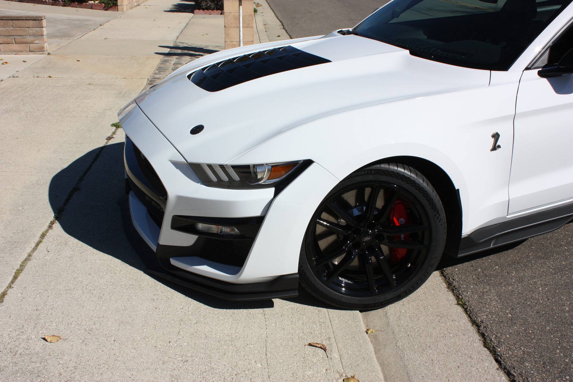

I decided to go with 305-35-20 Michelin PS 4S front tires. They are 1.2" larger in diameter and raised the front end about 5/8" which allow me to enter the driveway without scraping. Unfortunately the left tire contacted the inside of the wheel well when the steering wheel was turned all the way to the right. Luckily it didn't cause any damage except to the Jaeger Bros gravel guard on the left side, which was repairable.
I finally decided to reinstall the original front tires last Thursday. So much for my grand experiment.
Here is a picture of the left front tire that shows the lack of clearance when the tire is turned all the way to the left.

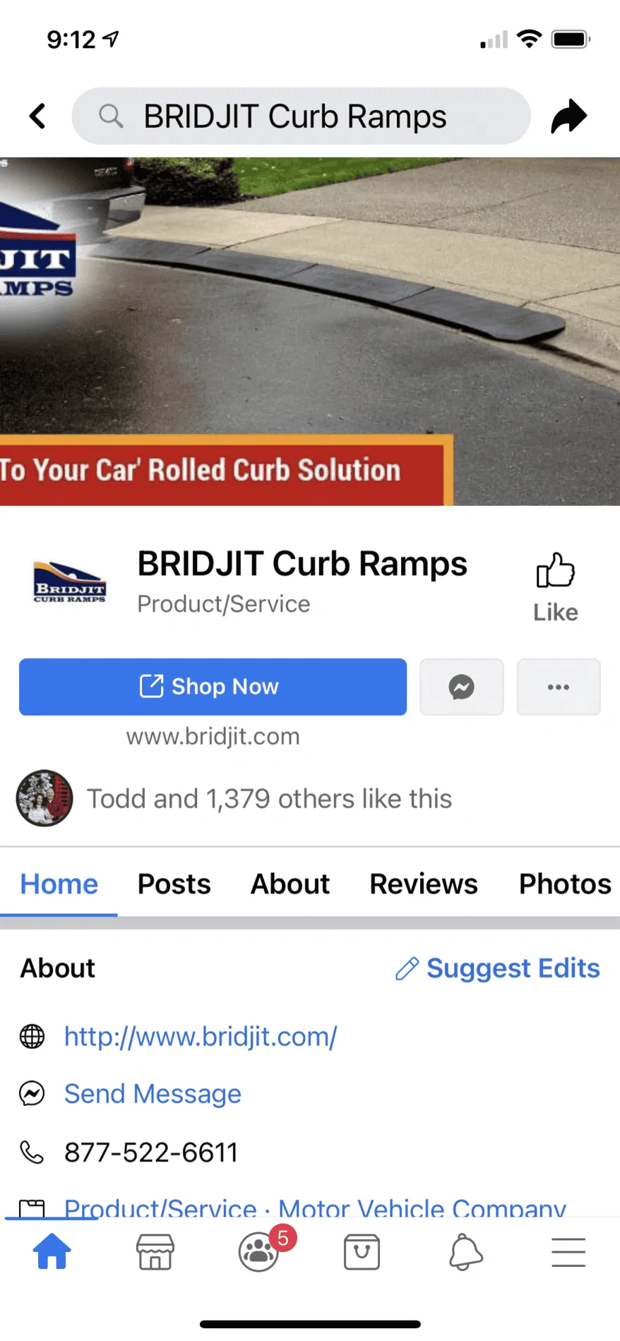

Earl, I sent you a PM already, but check these out.
I checked into those and after trying 2"x 6" lumber in the gutter I determined that it wouldn't work in my situation. The car scrapes when the wheels are in the gutter or out of the gutter.
