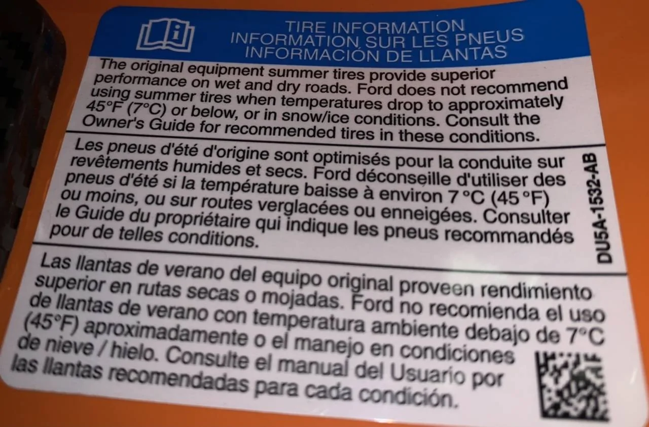

Your driver door inside pillar shows a sticker explaining not to drive your vehicle with the factory tires below 44 degrees🧐
You mean this sticker?! Never noticed it before: 🤯
