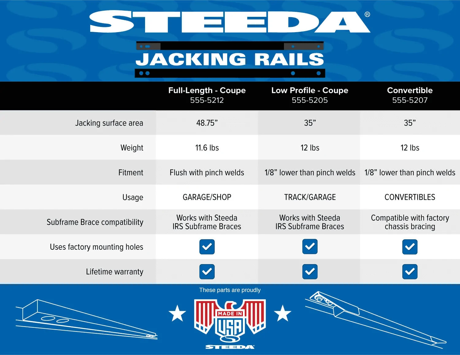

It's a secondary benefit but not something we tout as part of the benefits of the Steeda Jacking Rails.
If you are interested in the Steeda unit, here are some differences on paper:

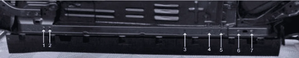

OK, I'm going to be the awkward one, again ... :giggle:
I struggle to see how connecting two points (with holes 1, 2 & 3, 4 on the below diagram), that are only separated by the same box section steel can have any noticeable benefit ?
There's no triangulation going on and no cross bracing from one side of the car to the other etc.
Are the chassis rails really moving enough in that plane to get a noticeable difference ... ?

You're correct, there isn't any benefit from installing "jacking rails" OTHER THAN being able to jack up a vehicle WITHOUT crushing the "pinch welds" of where the body shell sheet metal is joined.
Knowledge sharing for others who are new to Mustangs:
The pinch weld is the location under the driver or passenger side rocker and is the junction where the floor pan meets the rocker - two entirely separate pieces of stamped/formed steel that is welded together to make part of the "unibody".
All Mustangs since inception have a pinch weld (as do other vehicles) and the Mustang is also a unibody design with no actual frame separate of the body.
By placing a jacking rail next to (or even if over) a pinch weld only provides a rigid base to jack the vehicle. It's NOT joining the front and rear floor pan "sub-frame rails" together as a sub-frame connector is designed to do.
The only other way a jacking rail could be a benefit would be if the car wrecked and the inertia or forces that be tried to bend the floor pan in half front to back where that rigid "bar" may not give - but if the forces were great enough, would just pop or rip the bar from its bolted location.
Sub-frame connectors for an unibody vehicle are designed to join the front and rear frame rails together, where there is a gap between the front and rear rails.
On a unibody vehicle like the Mustang and with prior models to the S197, the L & R FRONT rails are sometimes "box-like" and could be separate from or integrated into the floor pan. They are normally located about 12"+ inward from the rocker towards trans tunnel, extend from the base of the fire wall floor pan and terminate just before the driver and passenger seats.
The REAR frame rails were again similar to the front, but start at further rear point of the rear uni-body, run along the rear floor pan and again usually terminate just under or just after the rear seat bottom location.
The idea behind sub-frame connectors is that it creates a rigid and now structural join that reinforces the large "gap" under the floor pan, joining the front and rear unibody together. This is beneficial for forces placed onto the vehicle from extreme use as in drag racing, road racing or even auto-X where the body is susceptible to forces beyond normal daily driving - and forces that could (and in some cases do) warp, bend, contort or damage the sheet metal when NOT joined by sub-frame connectors.
Sub-frame connectors came two ways:
- straight tubular OR boxed steel that was about 4ft in length and could be bolted through the ends of the front and rear sub-frame OR welded onto and along the lengths of the front and rear sub-frames which crates the "join".
- same design as noted above, BUT the secondary design came with cross bars that could be bolted or welded to the floor pan under the front seats. That secondary rigid piece of steel once installed with the sub-frame connector created a "T" shape. The cross bar would be mounted under the front driver seat and front passenger seat (1 bar per side). The bar was secured through the front seat bolts that go through the floor pan and were approx 1.5ft in length. This extra bar provided rigidity and support directly under the front seat area by not only tying those bolts together for the seat, but it was against the floor pan under the seating area and created more rigidity to floor pan for when (mainly driver seat) sees extreme forces of body weight transition.
Sub-frame connectors and jacking rails serve totally different purposes and are 2 totally different designs.
I'm not sure how anyone who has purchased jacking rails can "feel" anything.... it's placebo. The rockers and the steel surrounding the rockers is quite rigid in itself, and is one of the stronger areas of the unibody design and floor pan ... You could take a wooden 2x4, cut a trench in it, place it over the pinch weld and still jack the car just as one could with steel bolted on jack rails - there's no benefit to tying a unibody together under the pinch weld like sub-frames. You're not strengthening any gaps or the floor pan of the unibody design - because the ROCKER and the join of the rocker and floor pan structure already serves that tie-in purpose.
Want to add purpose and true rigidity - tie in the front and rear unibody where it matters and counts.

I have Steeda's Ultra-Lite Low-Profile Full Length jacking rails. Their super convenient for getting the front and rear tire on one side off the ground quickly with a pump jack. I'd go with their shorter version (exposes the factory jack points) if you have a legit lift or have a shop do work.
Check out Steeda's description for the 555-5754 IRS Subframe Support Braces. Sounds like more of what you're looking for.
