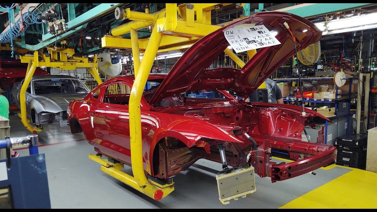

That means that F-R stiffness, or a unifying effect upon the chassis is made thru those 8 bolts and the jack rails.
Ford knows it.
What are those bolts there for, anyway?
The minor degradation in ride, might be unsettling to normal mustang customers. Might be.

"Ford knows it.
What are those bolts there for, anyway? "
They are used on the line - to transport the chassis to the next stage of installation.

"Ford knows it.
Ford knows it ? So that’s why they don’t use them in the halo models that they spend $’s developing …
Yeah, that’s what they are used for :like:
