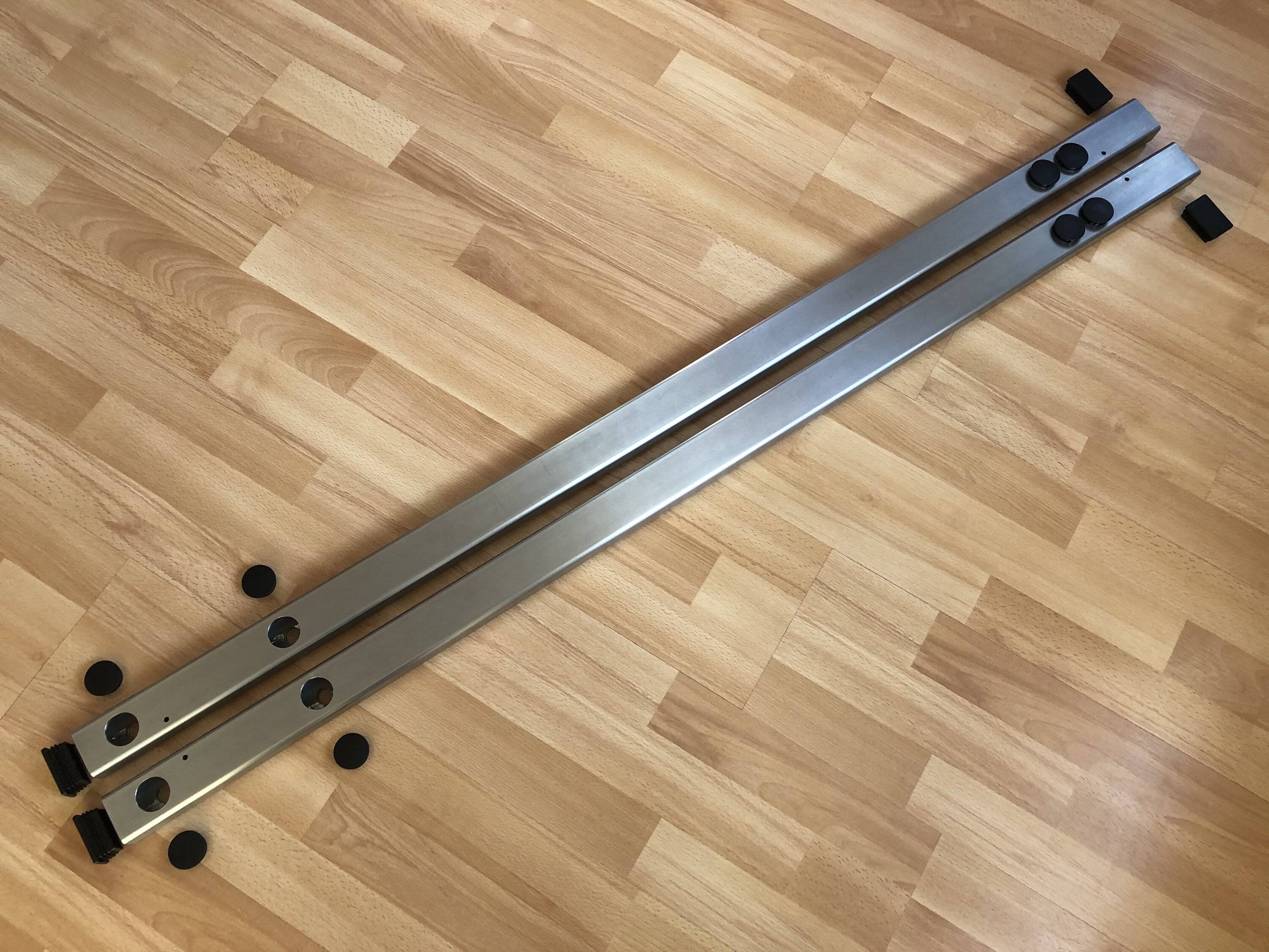

I did (from stainless) and thanks :like:
It might seem excessive, but it was cheaper to do that (including buying the hole saws etc) then getting BMR or Steeda at U.K. prices :like:

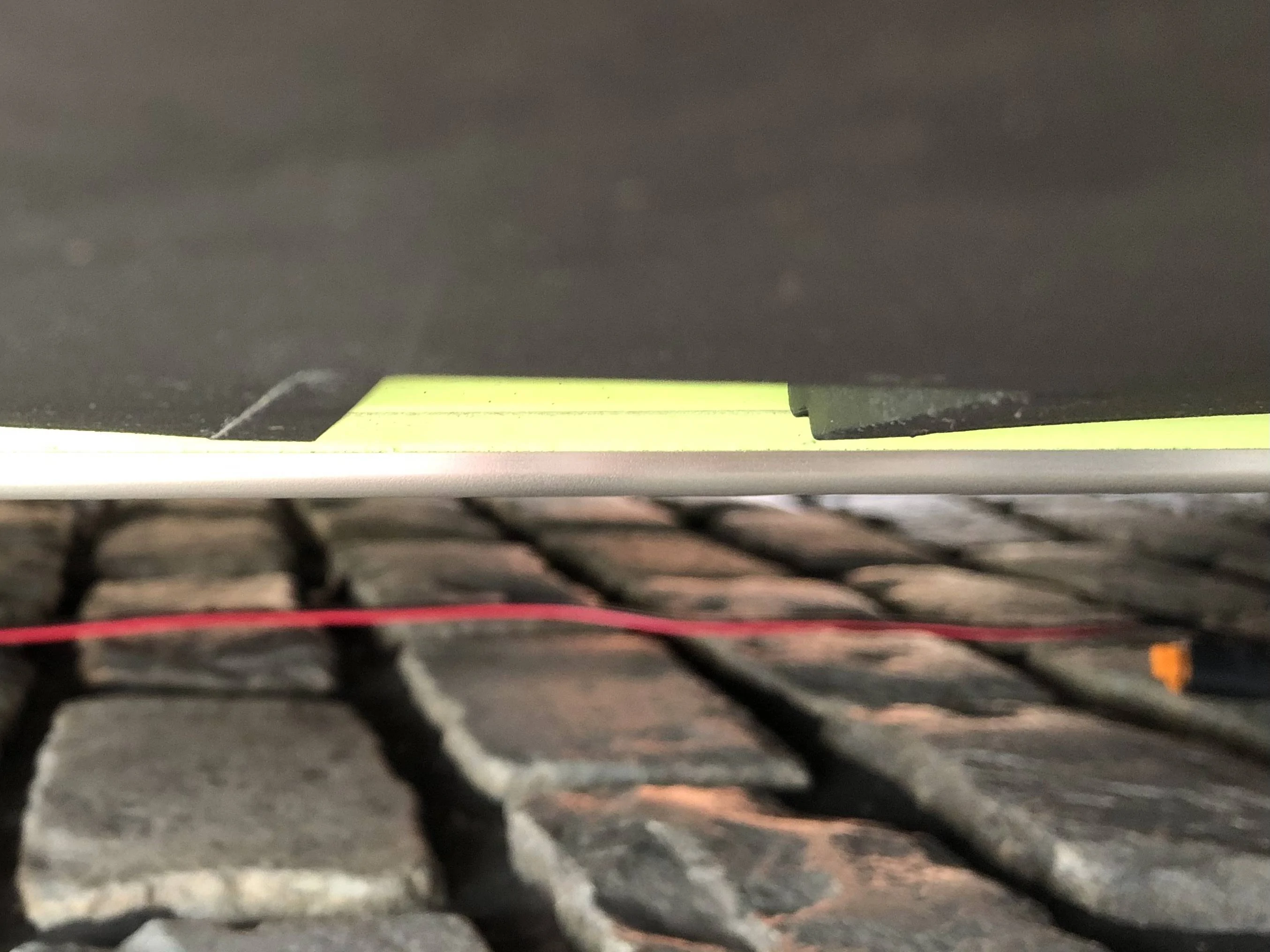

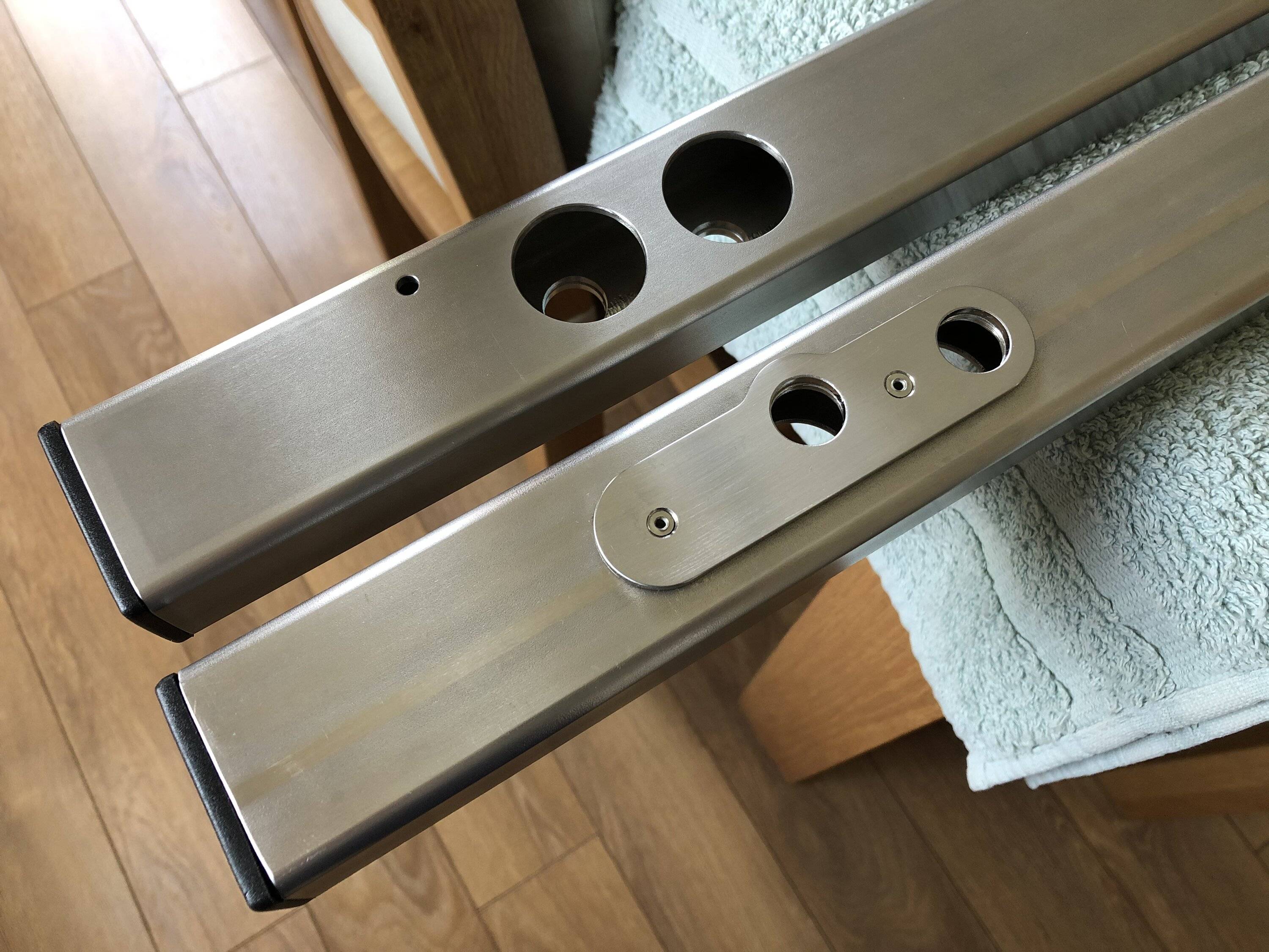

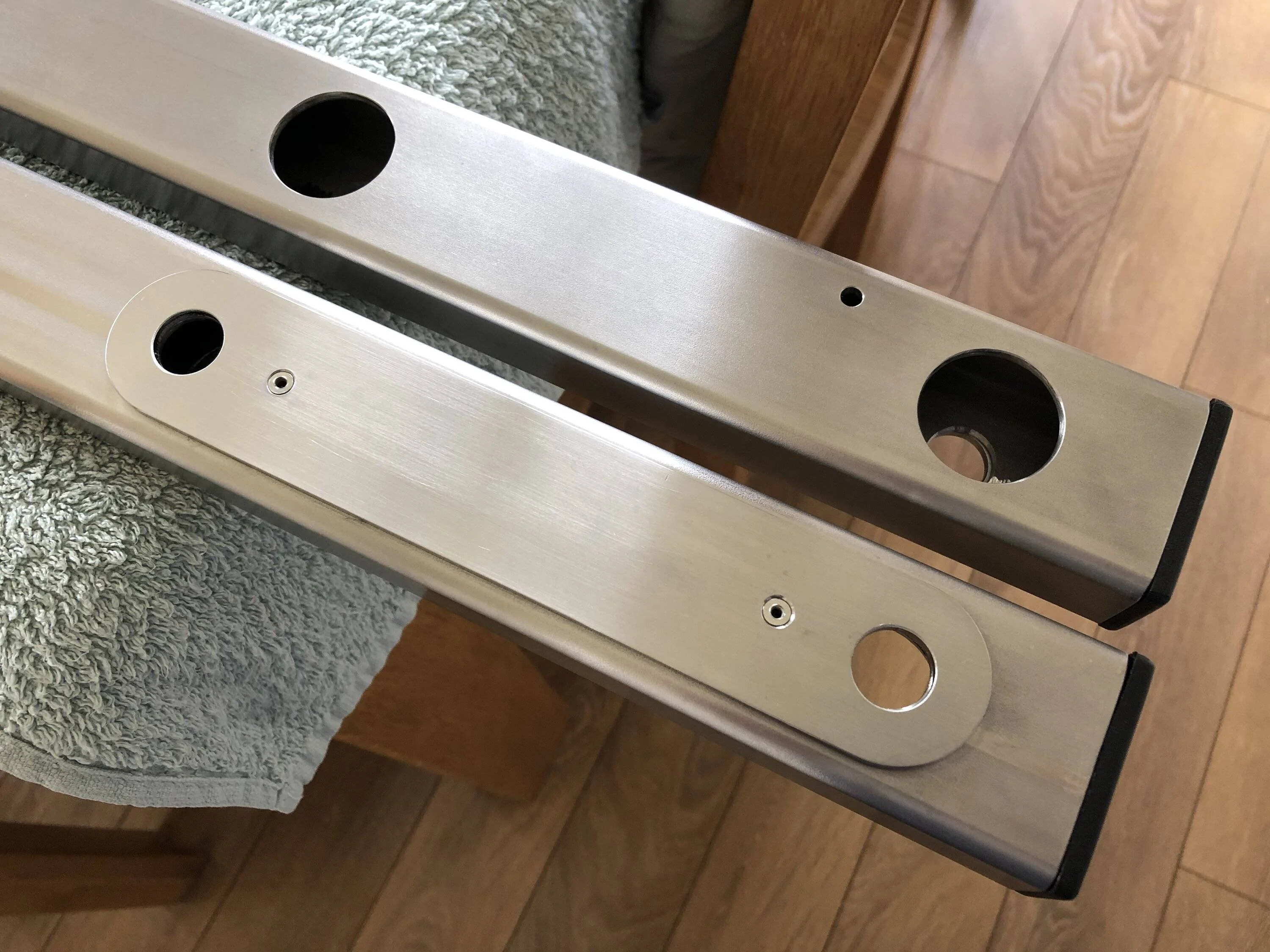

There's actually a little more going on with them than what the previous photos showed. I put plates underneath just to give a bit of an air gap between the frame (so it can breath in our damp UK climate) and to avoid the need to trim the sealer :
And I extended the front a little on the short rail to make them the same length :
The drain holes are positioned in the low side (the frame isn't level in the rail area).

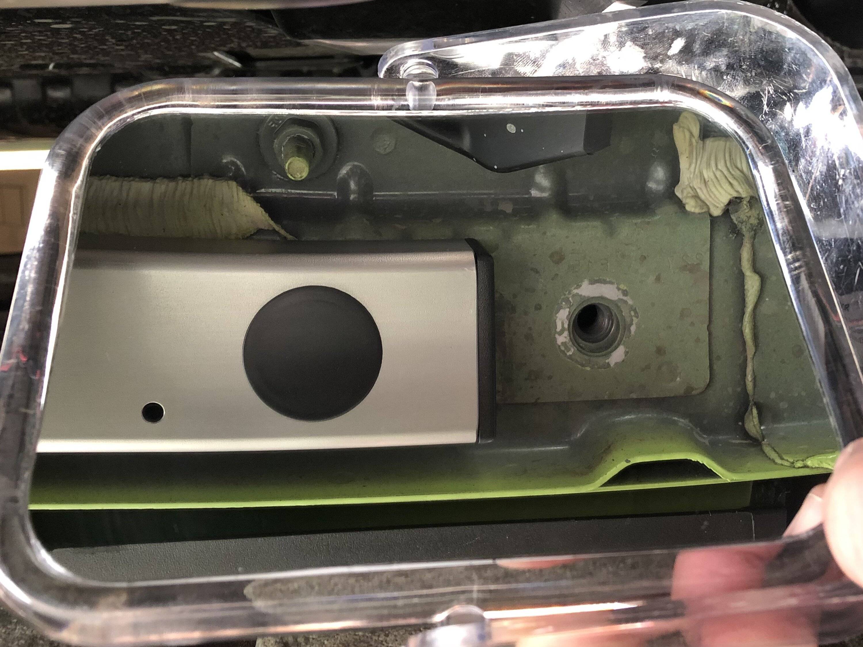

They will work with the Steeda IRS braces - If I have done my calculations correctly I should have an 8mm gap :
And I wanted them slightly proud of the pinch welds :
