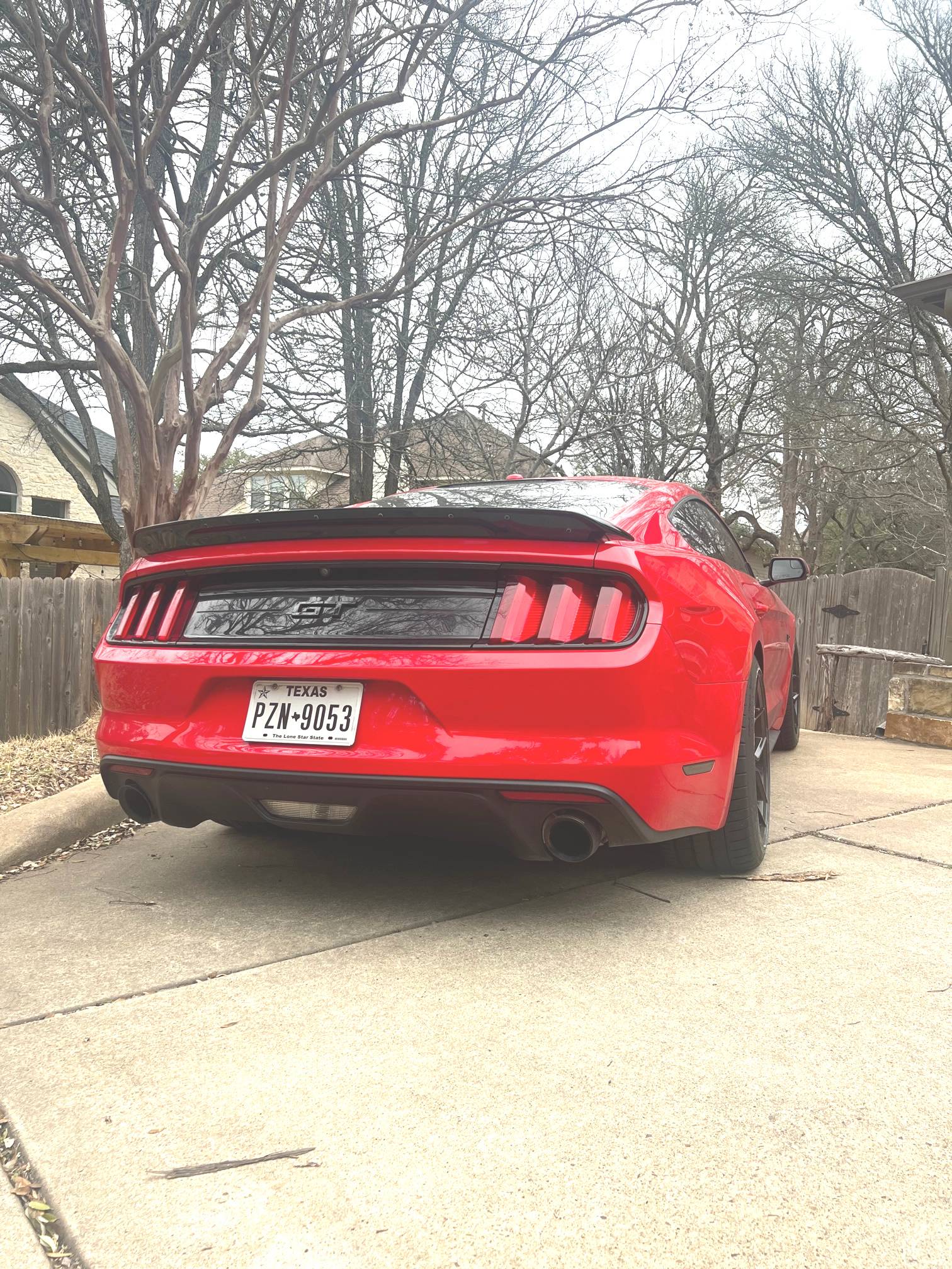

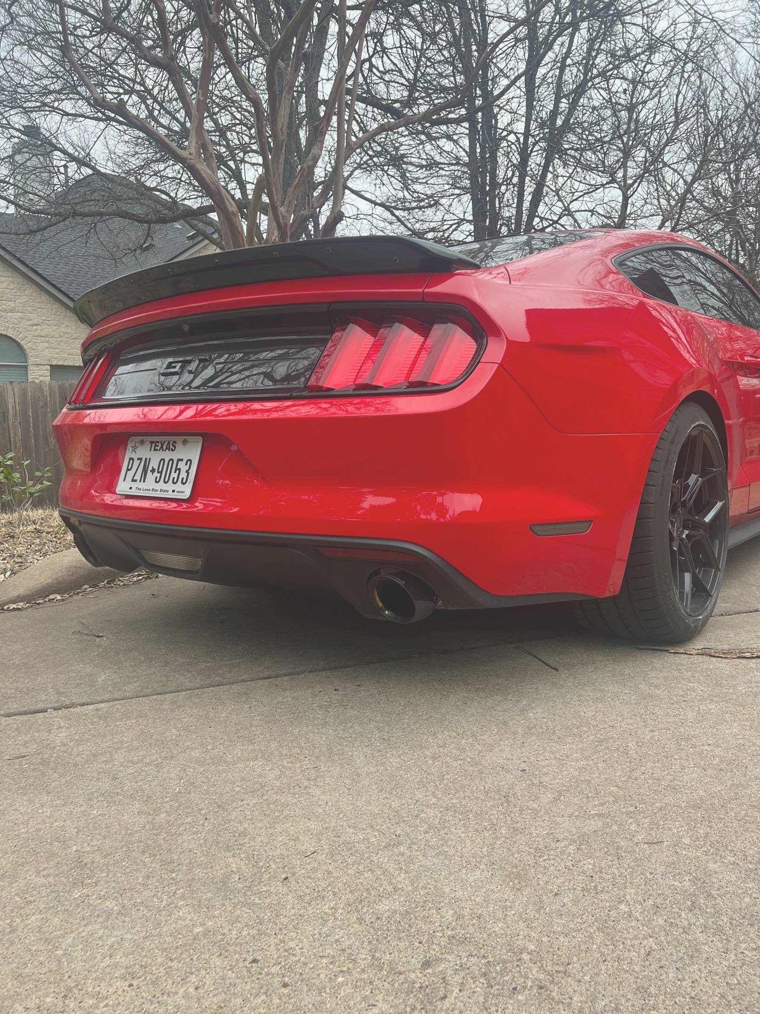

There are a handful of rear bumpers made for these cars. I bought a used 2017 GT Premium a couple months ago. I think the rear bumper is not the original and the incorrect version for this car? Am I correct? Or did ford do different bumpers for different options? The car has all the premium stuff like leather, heated/cooled seats, accent lighting. Bumper is a 1pc design. My hunch is that this car is supposed to have the 2pc version.

IIRC, the center section of the rear valance under the 3rd brake light for 2015-2017 should be body color.
Has that area been painted or plasti-dipped?

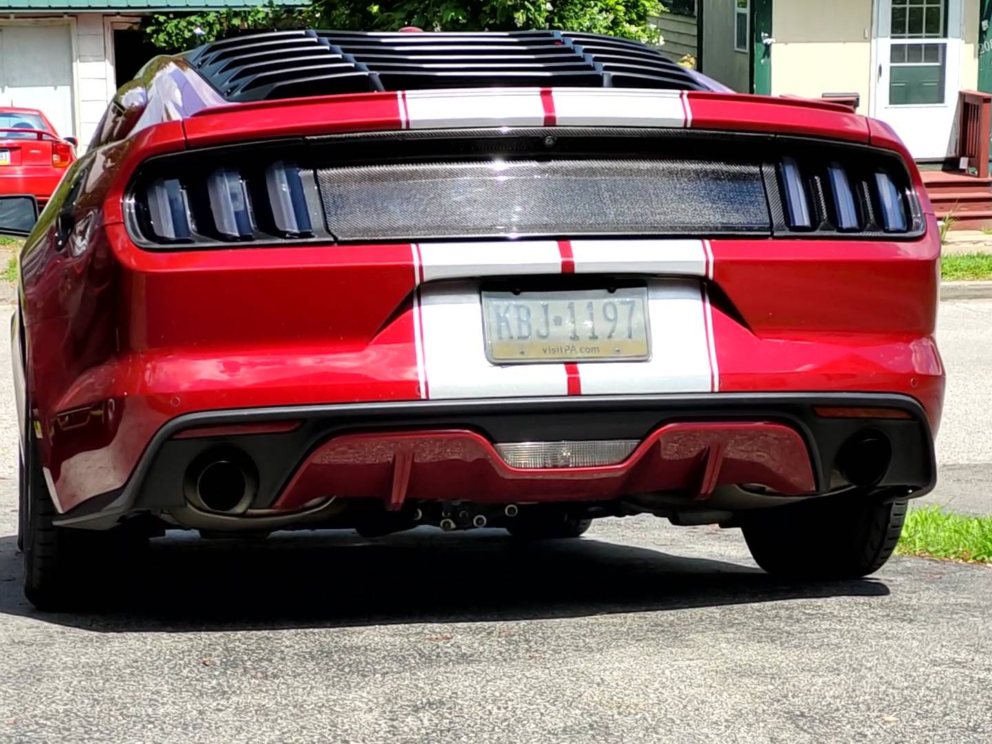

It actually looks like hes MISSING the rear valance panel. There are no fins at all. It looks like there is a bottom panel though, so maybe an after market one?

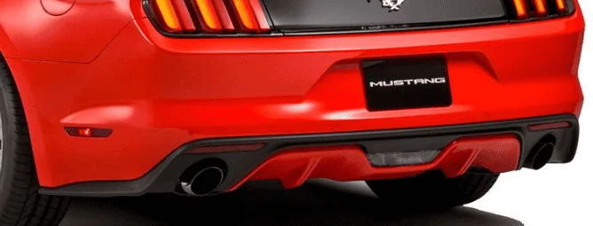

That looks like a painted base model rear bumper.
The premium bumper has the rear valence stick out a little more from the sides of the bumper and is NOT part of the bumper, it's a separate piece. That bumper looks identical to mine but it's painted black at the bottom. If it's one piece, it's a base bumper.
Premium rear bumper: (Valence is a separate piece from the actual bumper cover)
base: (yours looks like a painted version of this) - All one piece.
sooo to answer your question, if the VIN on your car shows premium package, then I would say that bumper is not original.

You also have the 2018+ Rear decklid. Maybe changed on purpose or accident and replaced parts with the wrong ones?

Thanks for the confirmation.

That looks like a non-premium (base) bumper that had the bottom piece painted.
Does the rest of the car have the premium bits (leather seats, 8" screen) etc.? Either you didn't really get a premium, or someone damaged and replaced that bumper with the cheapo one. Either way you have some investigating to do.
