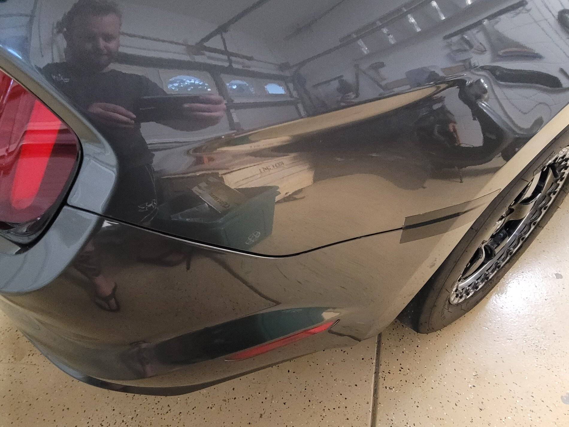

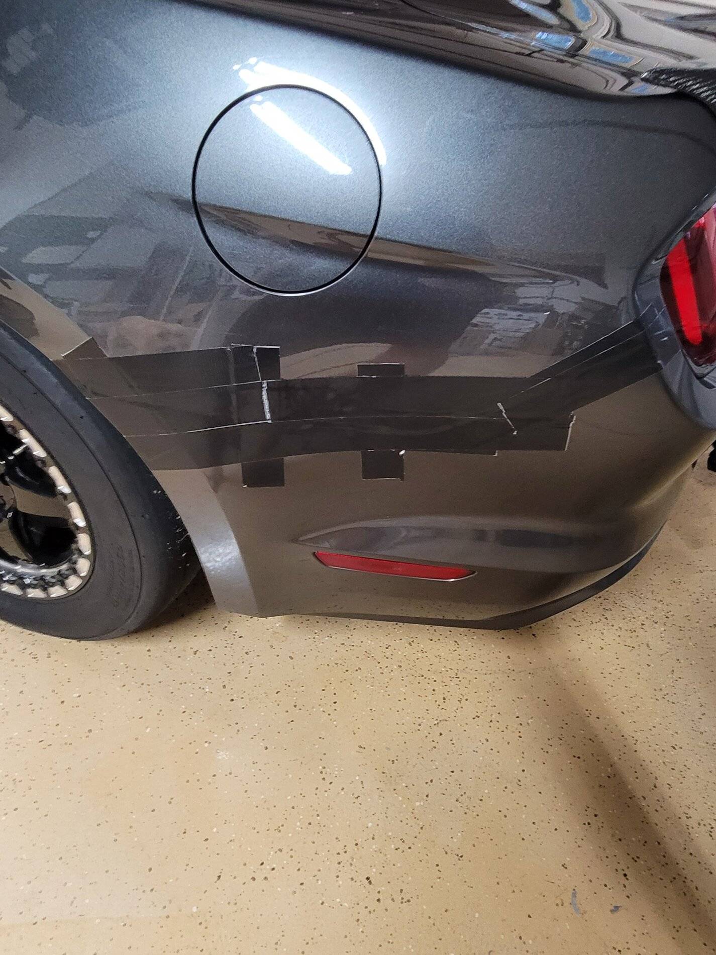

I know, I know... shoot me now
I'm on my second bumper and about the 3rd set of the plastic mounts that the bumper mounts to on the side. No matter what, I have a huge gap. This last time I literally put a dab of epoxy on each clip and it held until I finally got my car back to the track. It literally ripped the bumper off in the left side.
Has anyone used any sort of quick latch or Zues connector on the rear ?
