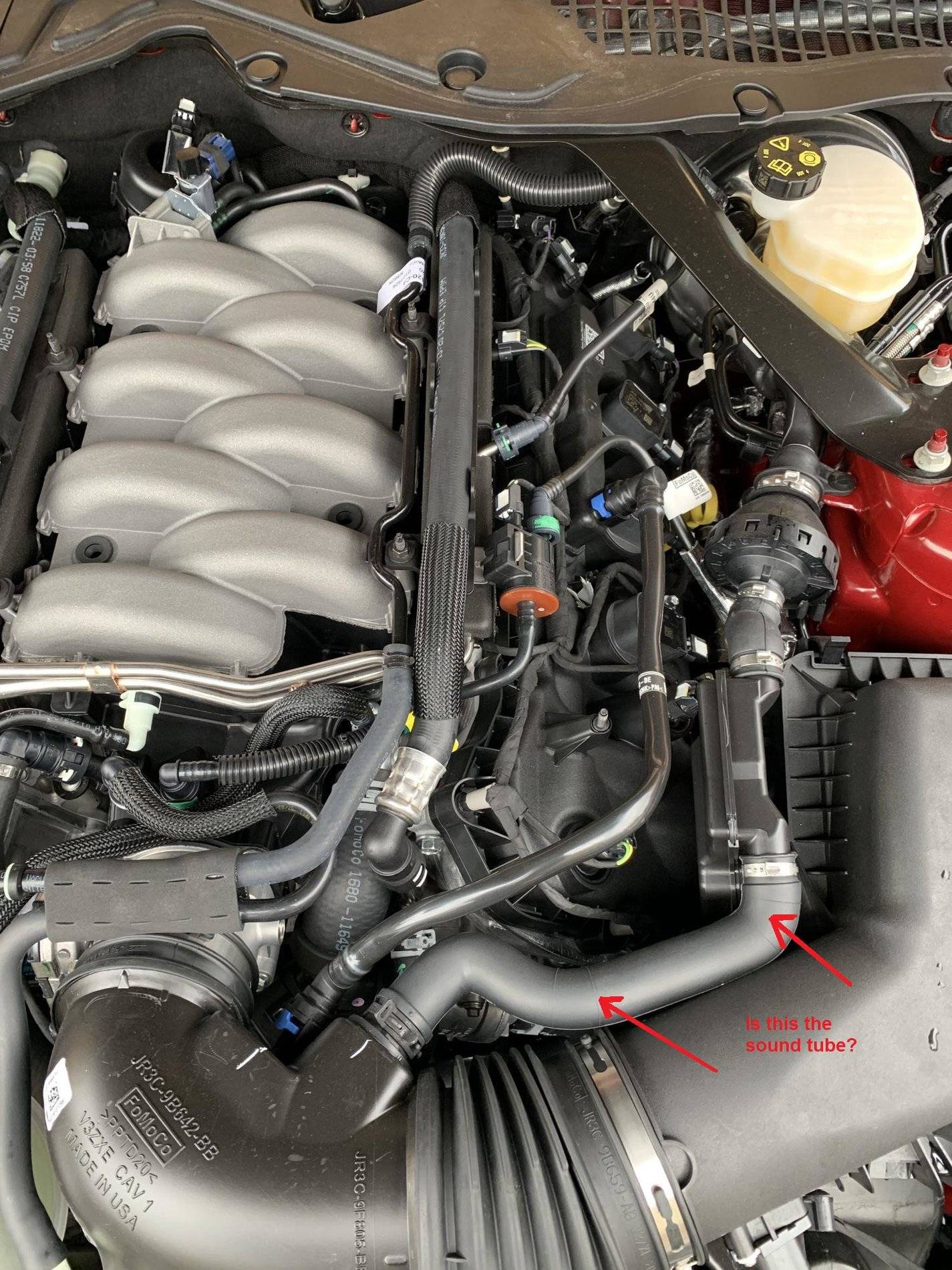

Can you please help me identify the GT sound tube from the plethora of tubes and pipes under the bonnet? I'm guessing it's the one I've marked in the picture. Am I right?
If not, then can someone please mark the correct one?
Thank you.
Follow those red arrows all the way to the firewall and DELETE IT! You will need to cap off the intake tube port as well.

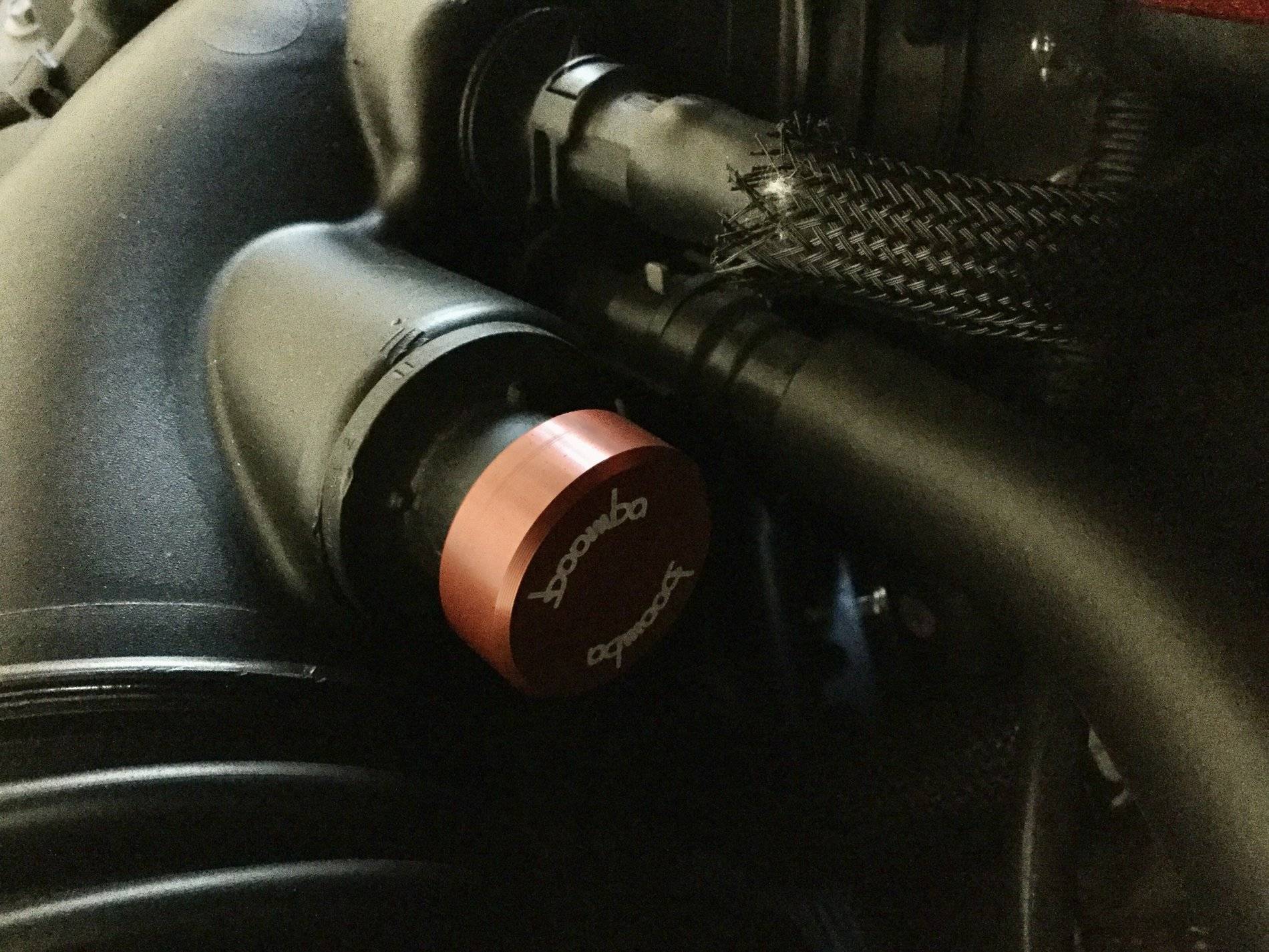

FYI, I removed mine from the firewall from under the car, with a small ratchet, a few extensions and an elbow.. and yeah, get the delete kit and plug both ends...I think I got my delete kit from Boomba Racing for less than $30, and the intake plug is nice machined anodized aluminum color matched to the paint of the car.....

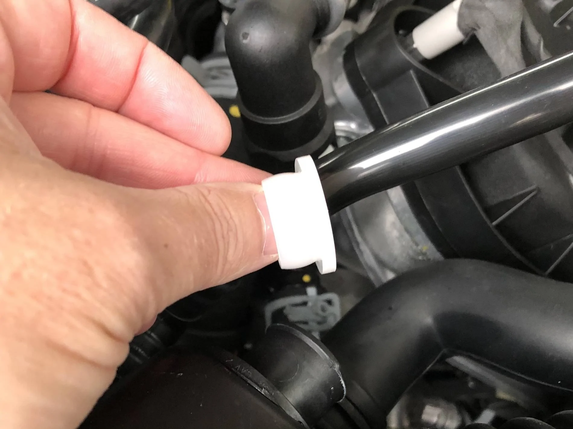

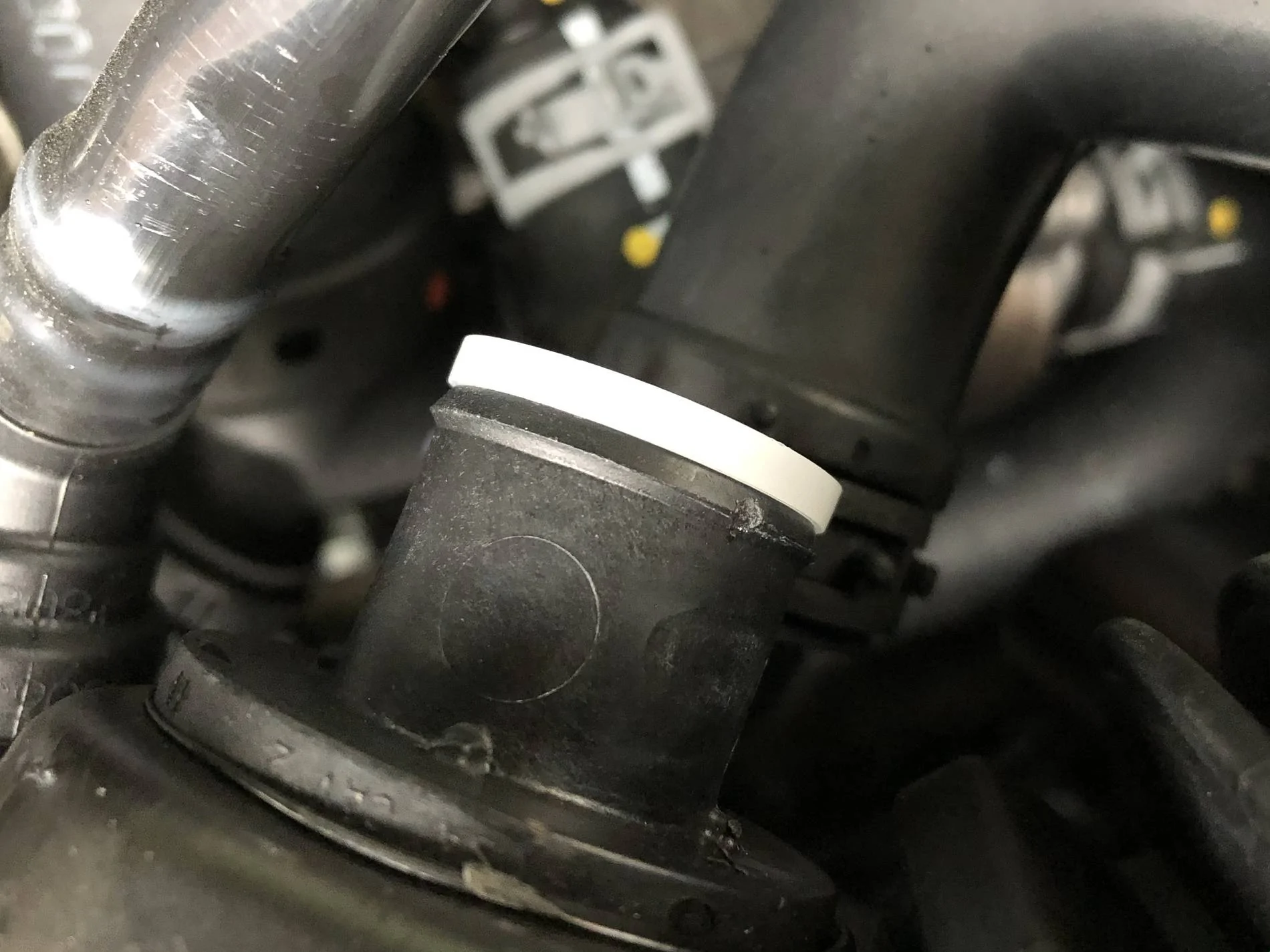

I plugged mine today in a slightly different way as I wanted to keep the OE look :
Everything went back together and it looks completely ‘normal’ :like:
