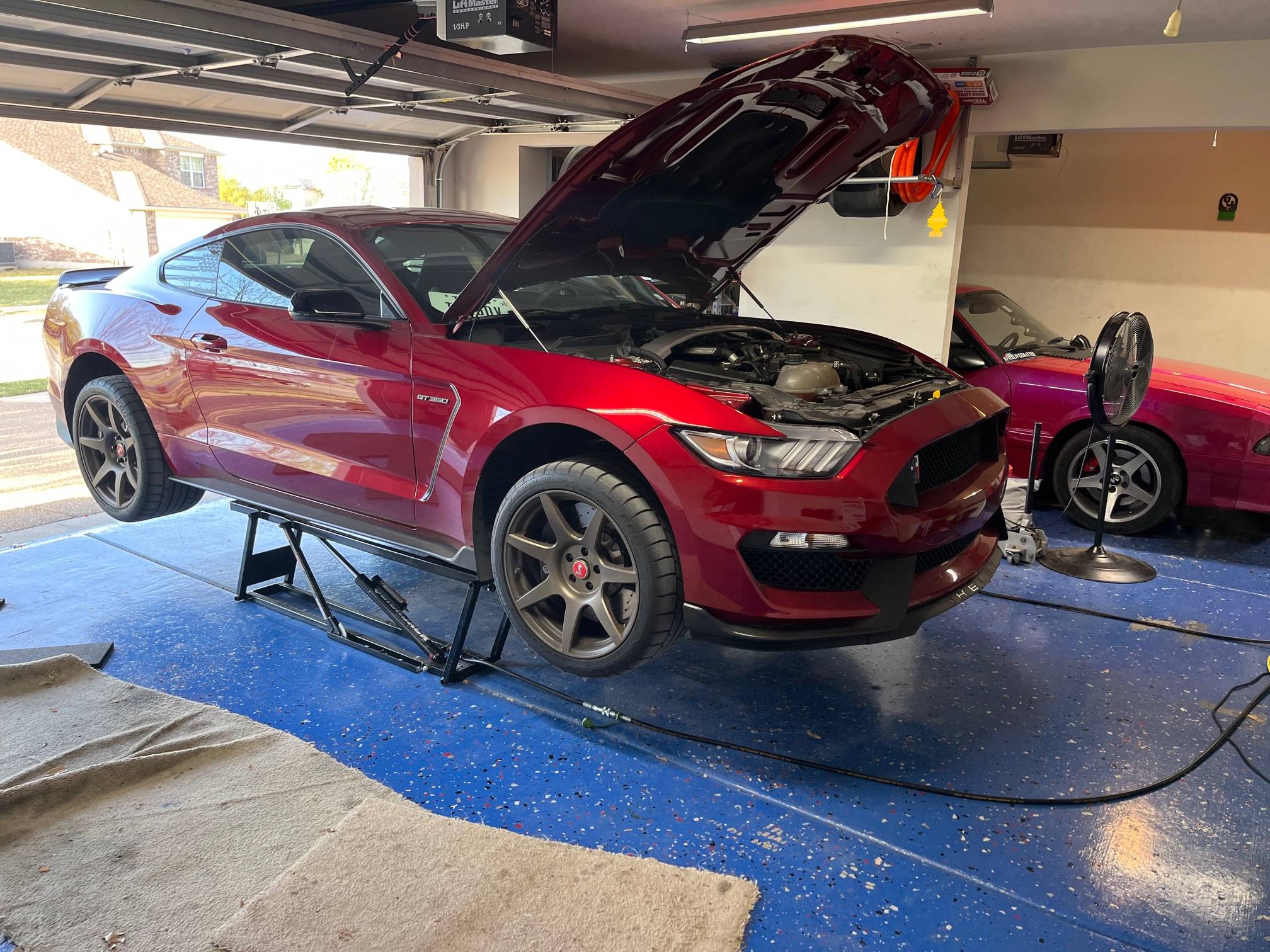

Get a quickjack. You'll always have an occation to use them.
Yep, I use my 7k quick jacks for winter and all four wheel removal, I use my BMR jacking rails for quick stuff.
