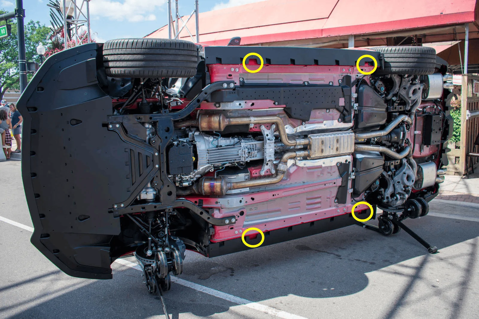

I have the full-length rails, but maybe explaining my way could help.
https://www.steeda.com/steeda-s550-...-chassis-jacking-rails-15-17-convertible.html
https://www.steeda.com/steeda-s550-mustang-ultra-lite-chassis-jacking-rails-15-16-all-555-5205.html
The two links provide underside photos of the S550. Notice in the photos how the rocker aero piece has square reliefs along it's length. This is where I place my jack stand: perpendicular (+) to the rail and in one of the relief areas.
First, I jack the car up anywhere along the rail, but not under one of the aero reliefs, one of the openings. The car is stiff enough where even with the jack on one end, I often end up jacking the entire side of the car up.
With the car raised, I now place the stand perpendicular (+) to the rail, in one of the rocker aero relief areas, closest to if not at the ">" point, the symbol on the underside of the rocker aero telling the driver where to place the jack.
Hope that helps.

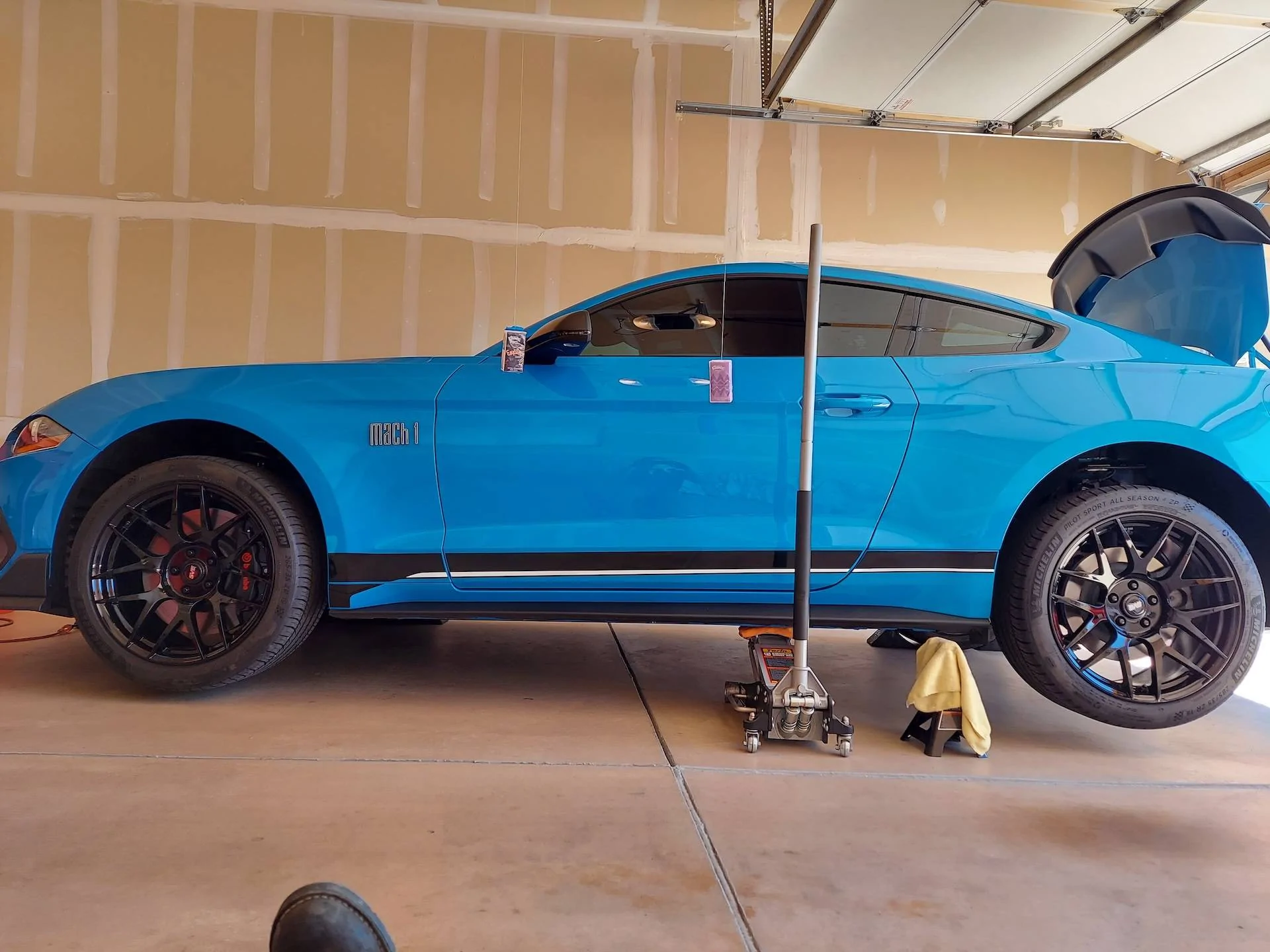

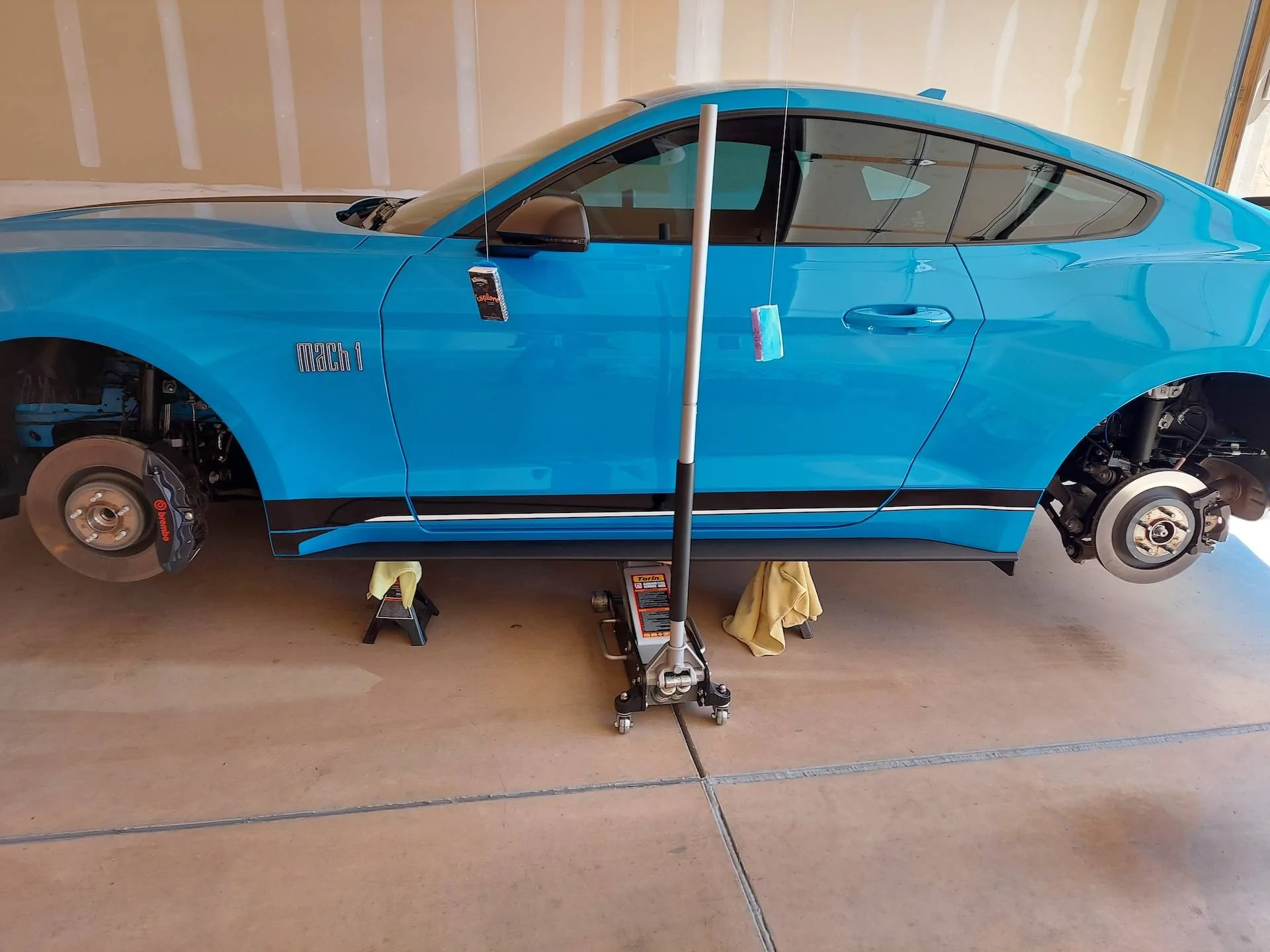

This is exactly how I set mine up. It works well...

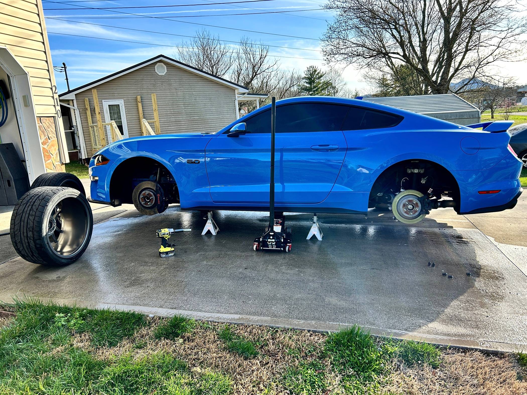

Are you washing the car on jack stands with the wheels off, so you can clean the insides of the wheels and the wheelwells etc? I think my neighbors think I'm nuts when they see me do that.
Do like I have, never waste energy concerning yourself with what your neighbors think. Up to the point where it could involve the police or psychiatric medical units that is.

Are you washing the car on jack stands with the wheels off, so you can clean the insides of the wheels and the wheelwells etc? My neighbors probably think I'm nuts when they see me do that.
Yes, this was the Saturday before Ponies in the Smokies. I do this at least twice a year, even though these wheels are easy to clean on the car :)

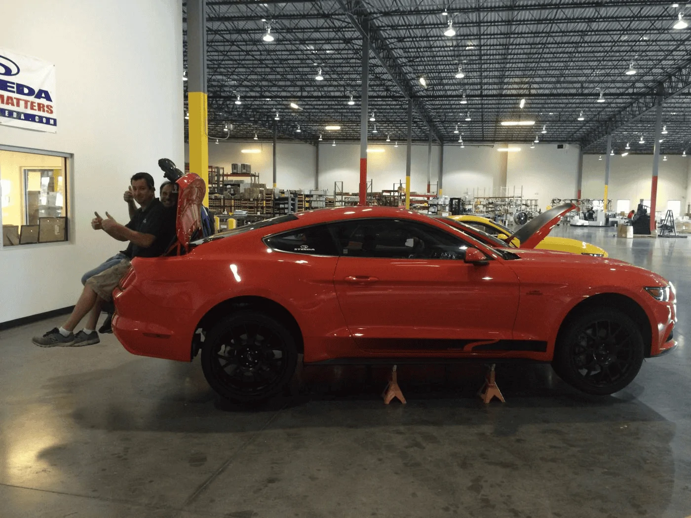

All these are great. I have the Steeda rails and put the jack stands near the front and rear. Sort of where the bolts are. If you look at all the photos, they shows the floor jack behind the mirror to the center to keep the weight centered. Lift one side then the other. If you need more height, repeat.
