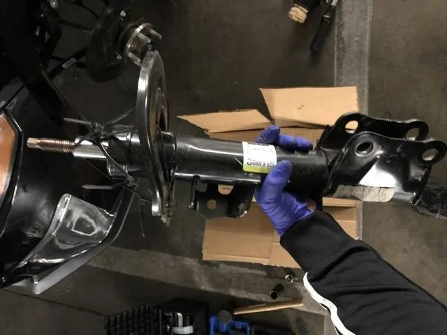

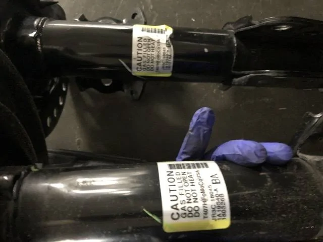

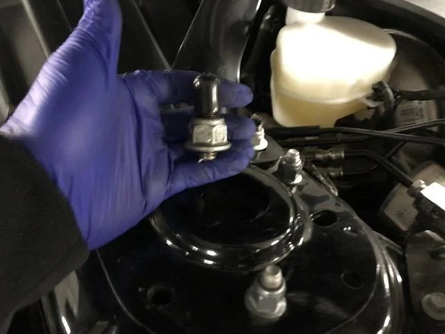

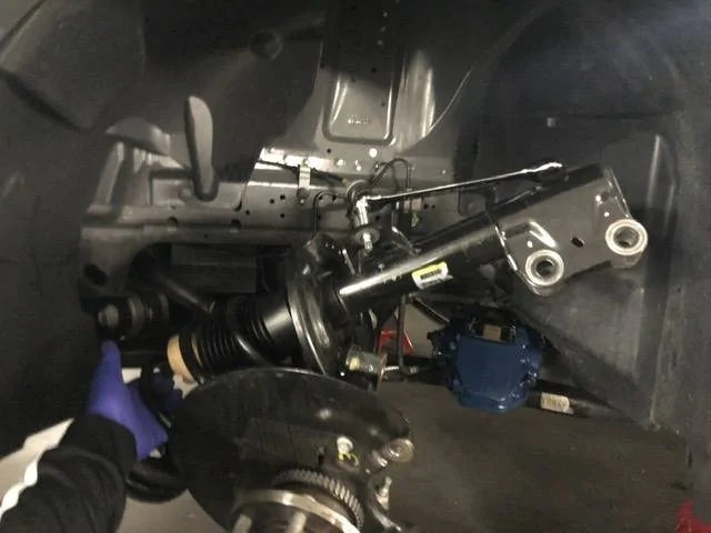

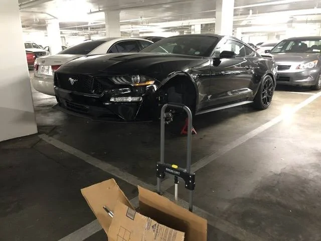

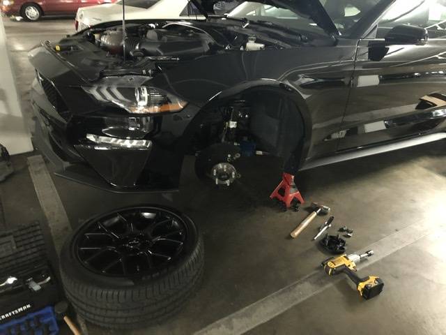

With huge help from @DekiDoo , I was able to replace the damaged strut!
The Fedex package that he sent came as quick as Amazon delivery lol
RIP strut shaft
As soon as the strut was separated from the sway bar endlinks, it collapsed leaving the strut caster plate still attached to the base. Almost eff’d up even more over here, god damnit.
1:1 replacementāœ”
Took almost two more hours to torque down the strut shaft because it kept spinning. The remedy was to jack the rear passenger side to put the front driver side wheel under pressure.
(Pic above not relevant)
The test drive went absolutely flawless. No more clunking noise from the driver side too.
Lessons learnt the hard way, yay!
