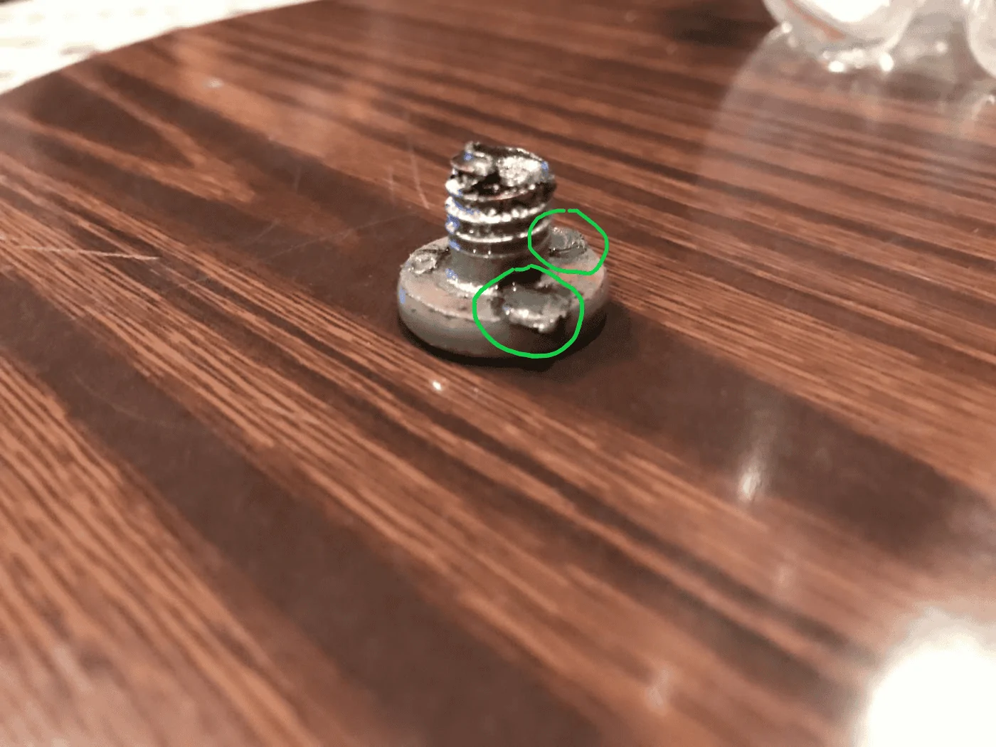

The guys who snapped off the stud ... did you have a Performance Package car that came with the strut tower bar? Or did you add a strut tower bar to a car that never had one from the factory, and then snapped off a stud?
It's possible that particular stud was over tightened at the factory on PP cars, and that weakened the stud to later snap if the strut tower bar was removed and then reinstalled a few times and torqued to the 41 ft-lbs spec.
GT Premium Performance Pack from the factory. So, yes, that theory sounds very possible.
Also, if for example the studs ever got (too) hot during tack-welding them in they also are weakened.
Picture from THE_AHJ's other topic that made be think... "Hmmmz those 2 out of the 3 tack-welds look a bit bigger than needed"

Big update here if those studs are spot welded in. The strut bar could be flexing a brittle bolt. When they break drill the spot welds out, put a bolt with washer in. They might beat out but if welds are deep it might roll in watch it.

I was digging around looking at recommended torque values for metric fasteners. The strut tower studs are 10M x 1.50 (10 mm dia x 1.50 mm pitch). What I'm finding is that Ford's recommended torque value of 41 ft-lbs seems to be higher than the general information out there.
It looks like based on Ford's torque spec that the studs are most likely Grade 8.8 (120K PSI) which is equivalent to a Grade 5 in US sizes. But Ford is recommending 41 ft-lbs where as most chart show it more like 35~37 ft-lbs.
http://www.xrfchassis.com/images/PDF/Torque_Reference_Chart.pdf
This reference shows 10M x 1.50 Grade 8.8 at 44 N-m, which is 33 ft-lbs.
http://www.boltmasters.com.au/webfi...ters_Pty_Ltd_Recommended_Assembly_Torques.pdf
After looking at this, I wouldn't torque the strut tower nuts over 33 ft-lbs ... probably shoot for 30 ft-lbs with clean dry threads.

Update: I ended up driling and replacing with a bolt from the bottom, it was an easy job. Thank you all for the advice
