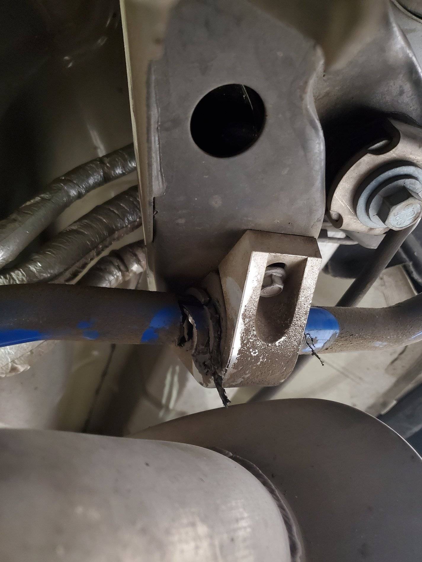

Not sure if anyone has ever experienced this but just noticed yesterday while changing out my wheel hubs and half shafts that my rear Steeda sway bar snapped right by the body mount. Waiting for Steeda to respond to my message but just wondering since I was more impressed than disappointed when I noticed this. Didn't notice too severe of a change in handling and it looks like it snapped some time ago.
That looks like the bushing is too tight on the bar and locking the bar instead of allowing it to rotate. When mounted, the bar should be able to move with only minimal resistance. Ideally, it would be completely free to move, but that type of mounting will always have a little drag due to bushing compression and sticky grease.

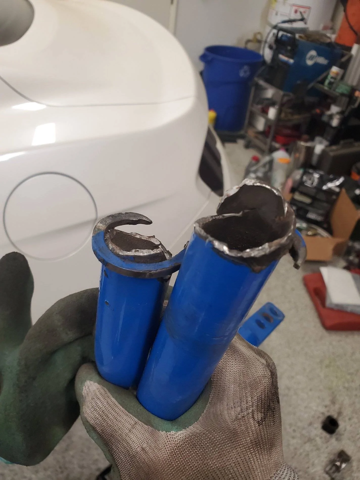

Thanks TJ! Just waiting for Mike's further response to my DM. Took another picture of the snap after I pulled it out the car. Looks to have broke right at the tack for the stop collar.

Heat affected zone strikes again.
Good old HAZ, coincidentally was talking to someone at work yesterday about why we don't weld the structures on the airframes for that very reason despite the amount of welders we have. Its inevitable without heat treating after.

That's not from haz. That's something with the material. A small tack wouldn't cause a haz that would make that material do that.
You mean like produce an initiation point for a fracture? It doesn't matter if it's a track weld, steel had to be melted to produce it and when that cooled, it formed a small, brittle inclusion where a crack could form to enable an endurance failure.
I prefer to use split collars to limit the lateral movement of ARB's specifically to avoid the stress riser. That's more difficult to do on a consumer part as opposed to a one-off.
The heat affected zone (HAZ) is a non-melted area of metal that has undergone changes in material properties as a result of being exposed to high temperatures.
A tack weld is barely hot enough to make any changes in the base material. Chances are it was cool to the touch in less than 30 seconds.
How did it form a small brittle inclusion? even if his tungsten touched the puddle to cause a tungsten inclusion that tack weld imo did not cause that. I agree with the guy close to the top. The bar needed to roll and it looks like it couldn't. You can tell the bar was twisted so hard it completely tore the material.
