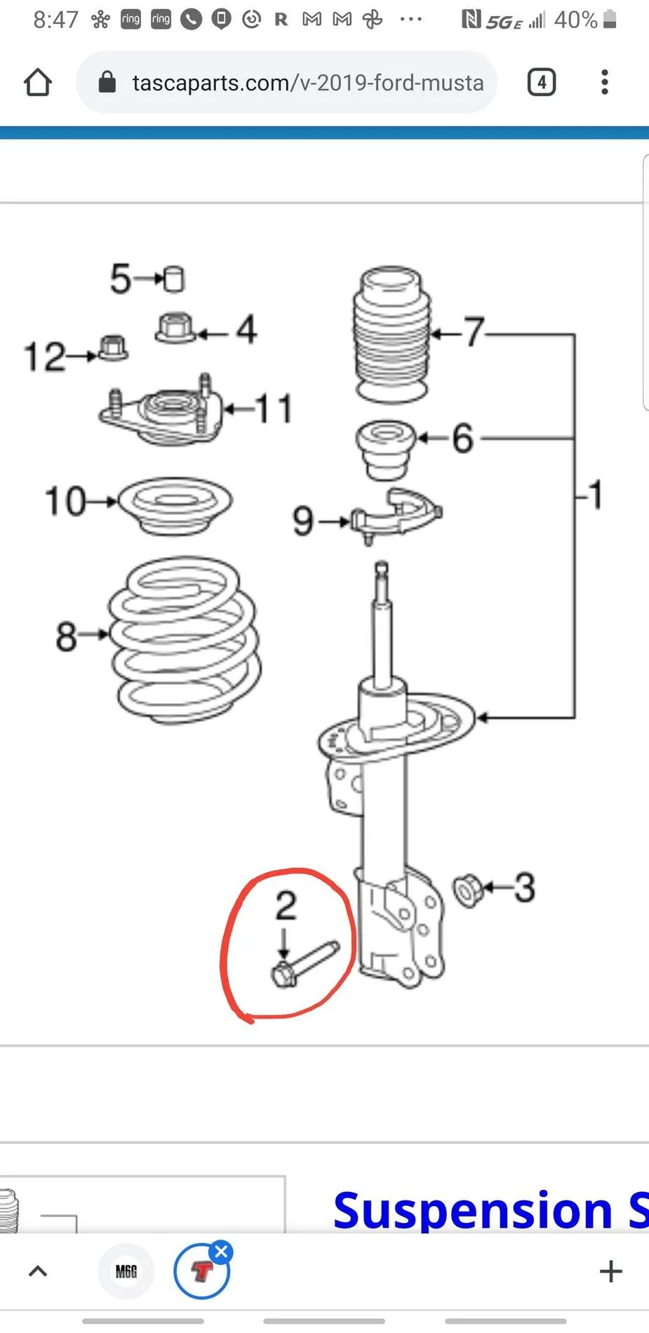

I am trying to remove the two bolts that amount the front knuckle to the strut bottom. Circled in red below.
So this is the first time I am removing the strut nut and bolts on a s550. I have removed plenty of them on maximas and pathfinders. I normally remove the nut using a breaker bar, then use breaker bar to crack the bolt, then turn it a few time and then slide (or tap with hammer) it out. Any youtube videos of people removing frozen strut bolt does the same (turn the bolt to loosen it).
Today, I tried to temove the nut then the bolt.
I broke the breaker bar trying to take the nut off. After soaking in pb blaster and using a new breaker bar, I was finally able to remove the two nuts. I tried to turn the bolt by the head, and it wouldn't budge.
I tried to hit the bolt with a hammer to push it out, but no matter how much I hammered, it wouldn't budge.
I then tried to turn the bolt by its head, but it wouldn't turn at all.

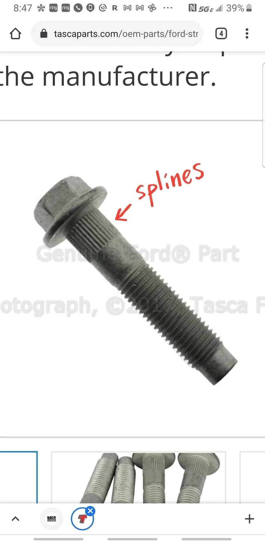

I went to the dealer and picked up a set of new strut mount bolts. I noticed that they are splined! See photo below.
So now I understand why the bolt could not be turned. And feeling the bolt, I noticed the raised part of the splines are higher than the side of the bolt shaft, which I am guessing means that the splines "bite" into the holes in the strut?
So... my question is, do I just need to hit it harder with my hammer? I would love it if anyone who has removed the strut bolt would let me know what they did.

Air hammer or hit it harder to knock it out. I'd also lift up the knuckle a tiny bit with your jack to help relieve some of the tension. If nothing else works or you don't have an air hammer, try heat on the strut tab.

Yep, raise a little to remove pressure, hit it with a 2lb hammer and it will pop out, since you are replacing the bolts.

I left the nut on the bolt, a few threads on or enough that the end of the stud was flush with the end of the nut, and whacked the heck out of it with a heavy hammer.

I just did this a few months ago. A regular hammer wouldn’t get it done. I had to go buy a 5lb hammer and still give it some really good blows. Make sure to put the nut on the end of the bolt backwards (to prevent damage to the bolt), before you begin striking it with the hammer.

You're supposed to replace the bolt, but if you choose not to then yes, keeping the nut on the end is good advice.

I bought new bolts, so I think I am just going to go to town on the old bolts.
I was using a 5 lb. Hammer, but I think I will just hit it even harder.

I was thinking of putting a 34mm deep socket over the bolt head, and use a beefy d-clamp to push it out, but I will give a second attempt with the hammer.

Yes, you still have to hit it really hard.

Yep that will work. If I am reusing the bolt I just use a Brass 2lb hammer. Good luck.

5lb BFH is the way to go… and like others said, you really have to hit it. If you tap on it, it’s not going to budge. Give it a good slam 1-2x and it should pop that bolt right out of the strut.

Anyway, thank you everyone so much for the info. I did jack the knuckle up just a tad (not even 1/4 in), and the bolt came out on second tap.
