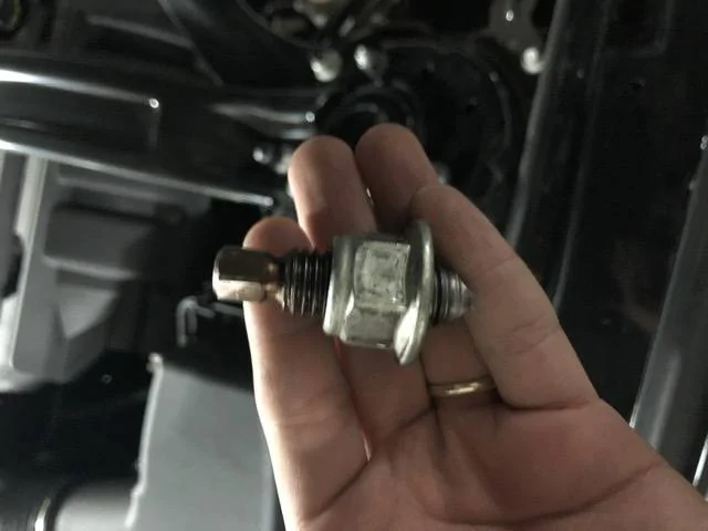

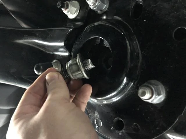

I snapped the upper strut rod. I torqued to spec(76) and it would still make the noise so I torqued to 110 and there it goes.
I am totally devastated and do not know what to do. Can somebody tell me what the part number is to replace the broken part? :(

You have to replace the entire strut IMHO.

That’s the strut shaft that broke. You have to replace the entire strut.
Depending on how many miles you have on the front struts, might want to replace both sides to maintain a matched set.

The car has only 4k milage fortunately. Looks like I'm going to have to find the part number for the strut..

Magnaride strut isn't much different short of few wires. Your clunking noise would be most likely sway bar or it's links - especially if you got the adjustable length ones - I had to loctite them to get rid of the noise (the adjustment nuts). There's about zero chance it was a strut mount.
If you want to be sure, you can ask Benny from Levittown Parts here on the forum - give him a VIN and he'll give you exact P/N. One I gave you is my best guess based on little info you provided.

Again, not the best practice and probably more chance of ordering more replacement parts, but I torqued the upper sway bar end link with an impact wrench so I think it's either overtightened or... something must've gone wrong

Is bar / link stock one ? Not the best practice but if the mounting bolt did not snap, you're probably fine... But since the threads on these get dirty, take a look if its actually tight (not sure how much torque your impact makes - my Milwaukee in lowest setting would not make a dirty thread tight unless I held it down for a while).
Your remaining options are spindle bolts and strut moun bolts - the latter aren't that thick and they only need 40ish or 60ish ft-lb of torque so would be careful...

I just ordered a new strut along with top nut, spindle bolts and nuts. I didn't have the proper tool to hold the bolt on the back of the sway bar so that could be it.
I hope the new strut and hardwares resolve the issue..
