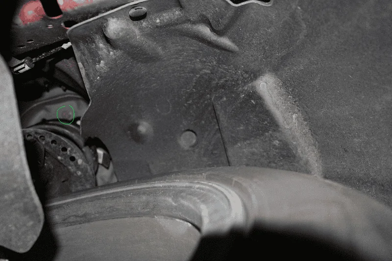

Yup, just the bolt. It is not connected to the shocks or the shock mount (on previous models it was?)
Here's a shitty pic from my wheel well where you can see it's not connected (although it sits close to it). (it might be from the opposite wheel I don't remember, it's the most "viewable" pic I had left laying around of one of the strut bolts)
(click to enlarge)
Thanks a lot for the help, I shall change that damn stud then

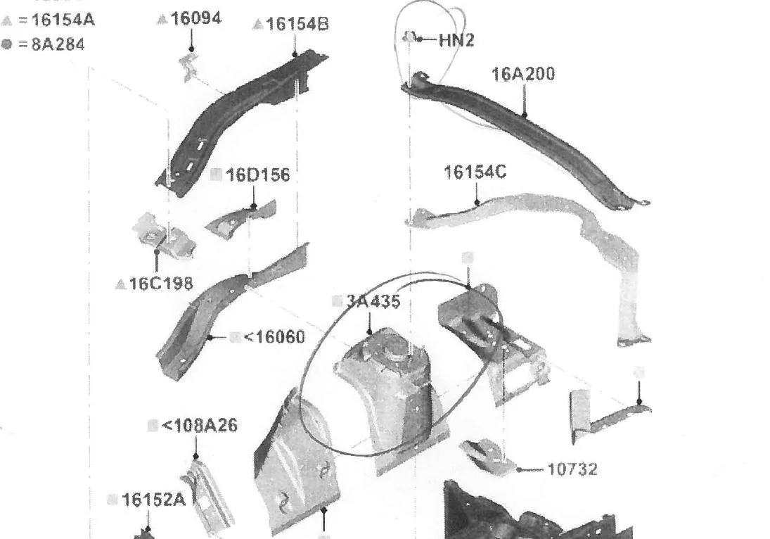

OK so back from the dealership, thye say they cannot order and replace just the snapped stud/bolt and that the entire strut tower cover needs to be replaced since the bolt that I snapped comes with it. To replace that part it will need to be taken to a body shop since that part is welded onto the car. I am talking about part 3A435. This is not making any snese to me, can anyone who had this work done chime in please? Thank you all for the help.

seems a bit over kill for replacing one stud. Would it be possible to drill out the broken stud and replacing it with a grade 8 hex bolt?

That's nuts. Body shops replace sheared bolts (usually from collisions) all the time. I know Ford has no official part number for the stud, but any body shop stud/bolt of the correct size would work...
By the way, I know for a fact that the original topic starter IPOGT had just the bolt replaced.
If my dealer dealer gives me the same BS in a few months I'll walk away. They are just trying to "up sell" you. (Also if they swap that whole part your alignment is fucked and you have to have that done again also)
Link to a topic of somebody replacing a RSX stud after snapping one. (Btw he ended up replacing all of them, even the non-broken ones, just because they are stronger...)
*click* That's what I will end up doing if dealer proves clueless in a few months. The broken one is pretty stuck in there for me so I'll probably end up drilling it out. But the rest of the steps will be the same.

I walked away when the dealer said that, I will remove the remainder of that stud and have a hex bolt replacing it . Thanks guys I tought I was crazy for a second sitting there listening to the service manager lecturing me about replacing the whole strut tower cover, which will have to be welded. I can name so many things that can actually go wrong if they do that. Thanks again
