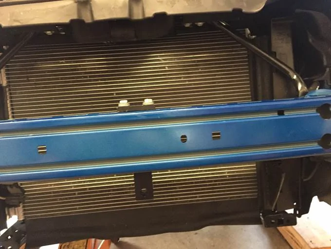

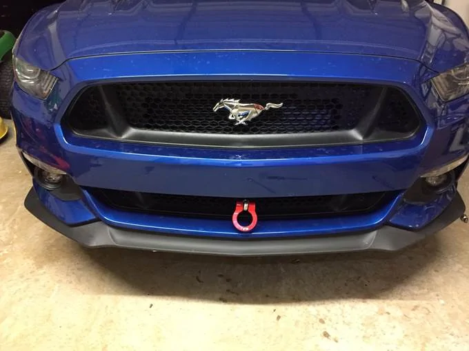

I got the center-mount option for the ZL-1 hook. Had to remove front cover, and the bumper itself to drill for center mount. I did not want to torque anything and generally have confidence in the install. Couple pix for reference.

How difficult was it to drill? When I asked my co-worker about the install, he said drilling his Focus bumper bar was a nightmare.
TennTex
Mar 11, 2016
50
Frisco, TX
Steve
2017 Mustang GT-PP
Yes, was a pain. I went through a couple bits. Not the best t start with, and hit them with a file several times to keep them cutting. Just took time.
