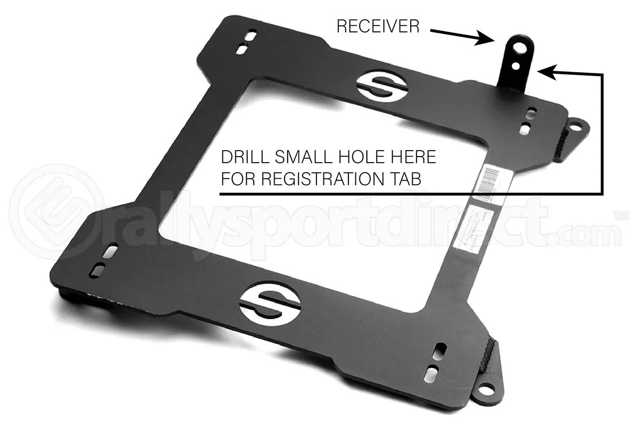

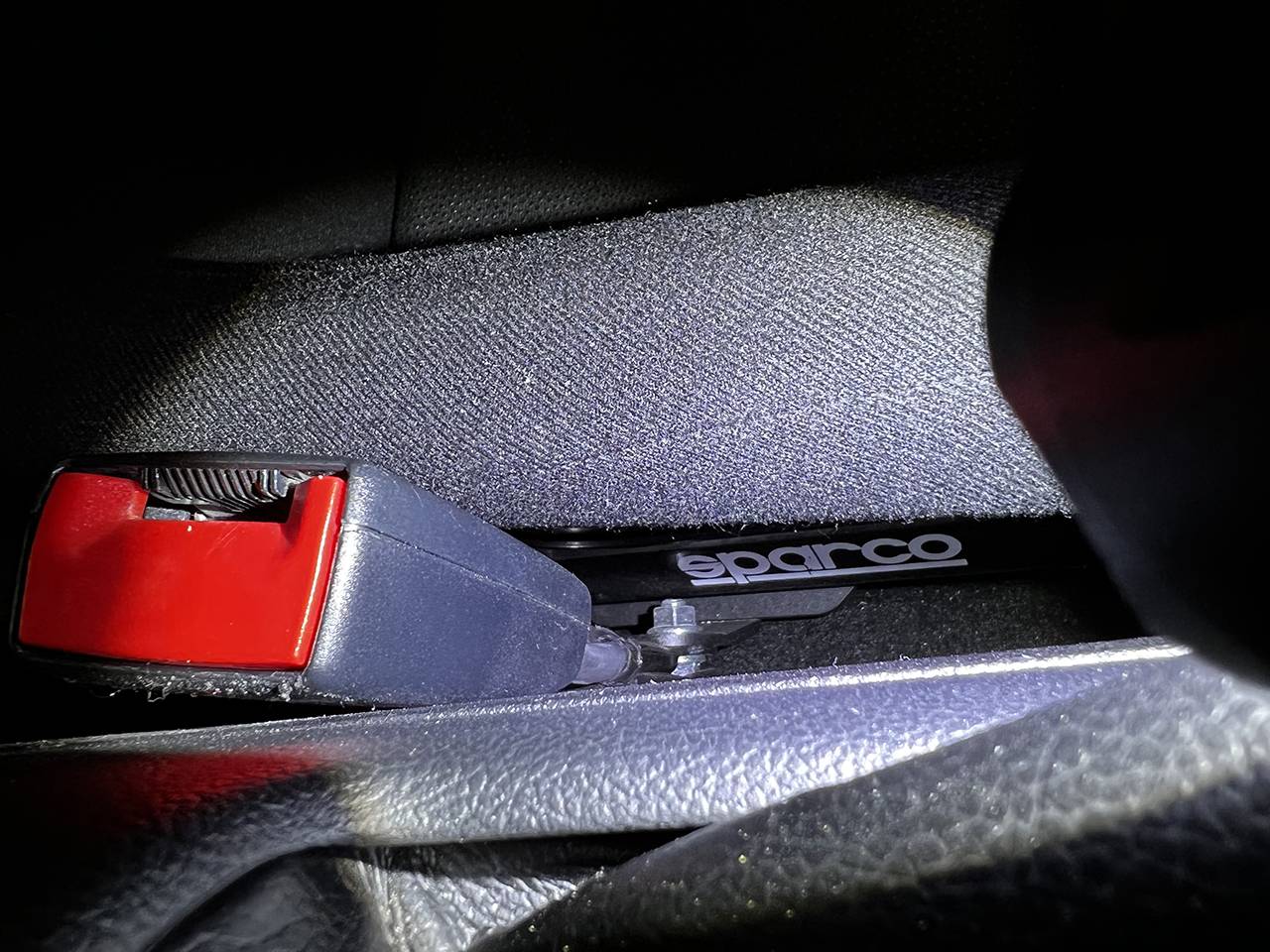

Question for you — how are you running your Sparco’s with the stock seat belt?
The base can accept your OEM seat belt. I only use the stock seat belt on the street (never use a harness without a HANS) but let me explain further.
You'll need to modify your base by drilling a small hole for the seat belt receiver registration tab to work with the base. Simply drill a small hole and bolt on your receiver.

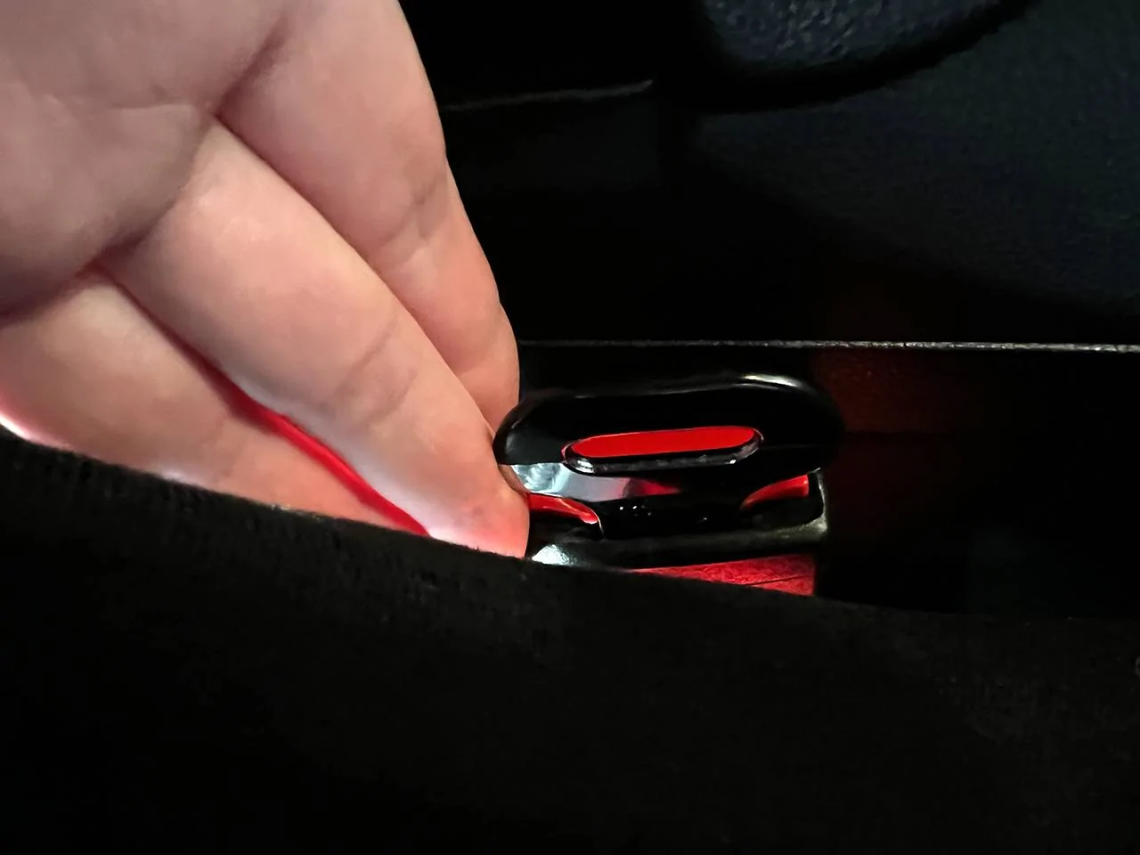

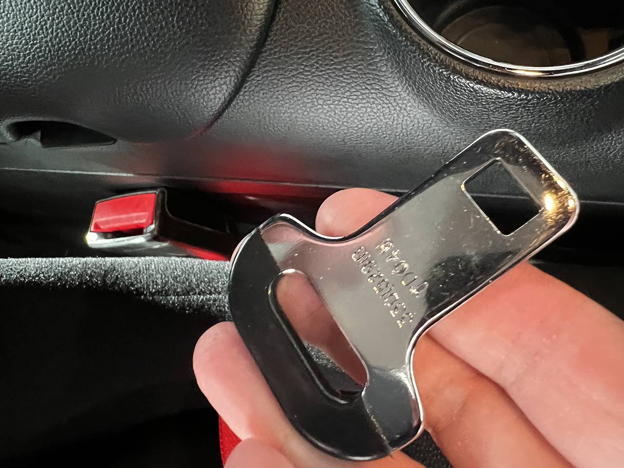

Pro Tip: Get some of the OEM buckle extensions from your dealership. The 'Gubment dictates that you have to give them to customers for free because fat people. Simply cut off the strap.
Put buckle in receiver to make the car shut up when using your car on track.
