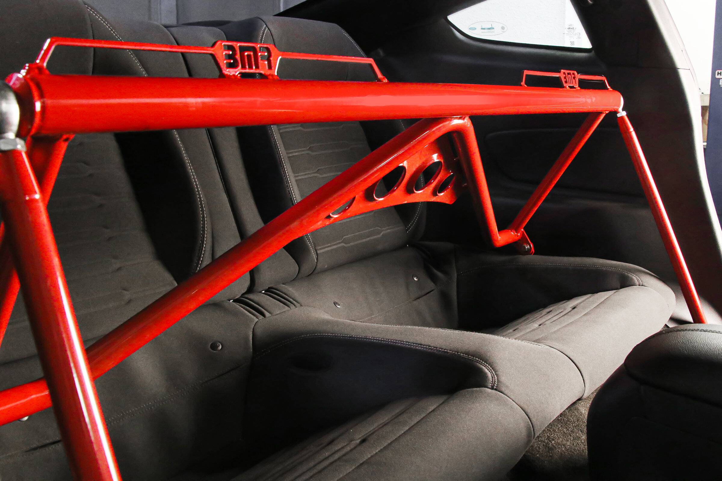

I'm curious why nobody has come up with a 'hinged' harness bar. Ie the base legs have a pivot point low to the floor and the 'bracing' legs are just say heavy duty braided steel cable. The system would be taut in the direction needed (body going forward) but would collapse down going the other way since the seat-back is now the motion-control device.
How would that be better than just having the straps mount back and down? At least if the seat harness slots are high enough.
it's not. if the shoulder belt declination is supposed to be <20deg there is no attachment point within that arc on a Mustang. Though Schroth's ASM setup obviously violates that rule and they're fine with it - I guess BECAUSE it's ASM? Otherwise I've seen mention no declination below 90deg to seat-back angle.
If the BMR bar had the forward legs instead mounted to the rear-seat shoulder points, or better yet the bar was 'suspended' by the shoulder straps (keep the lower pivot mount), that could allow the harness bar to either be far enough back to be out of the way or pivot away when the seat needs to pancake. All the bars I've seen interfere with the seat back.

Just giving the feed back I have gotten from customers that have bought it for this purpose.
Unless I'm missing something, this looks dangerous (as are all harness bars). If you flip, your body can't get out of the way due to the harnesses but this offers no rollover protection.
If you're already consuming the back seat, might as well just get a roll bar
